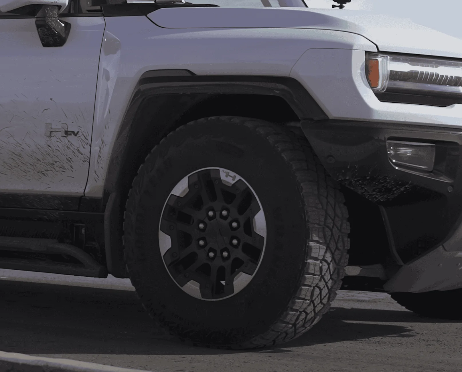

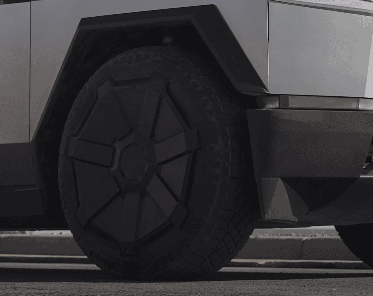

Am I going to have to school you on tires and brakes too? Not to mention the 50% more mass? Mud terrain tires will never beat dedicated street performance tires, no matter how strong the brakes.
The Cybertruck has anti-lock brakes strong enough to bring the contact patches of the tires to the limits of traction. After that the only advantage of more powerful brakes is the ability to do repeated stops without fade. Since the braking test was only from 70 mph (and only one stop), we can be sure the problem was not inadequate brakes.
Let's keep it real.
Really? :ROFLMAO:
Well supreme teacher of fanboi flap your gums in the wind, how do you explain this at the 16min mark?
Hummer is another ton heavier than the CT and it still brakes in a shorter distance.
And its a GM! (I know right, what has the world come too! lol)
Tyres are even "more" AT:

By the way, the Hummer has a lot more tire on the road with those 305/70R18's vs. Cybertrucks 285/65/R20's so I hardly find the few feet that the Hummer stopped shorter to be significant, especially considering the Cybertruck was a pre-production unit in that video as well.
By bringing the Hummer into it you are deflecting from my main point, the Lamborghini stopped in a much shorter distance, primarily because it has performance road tires on it. It has nothing to do with the brakes themselves. End of story.

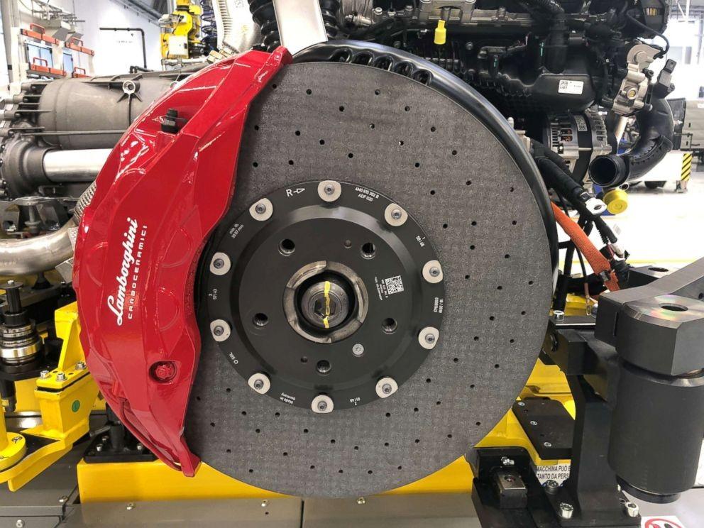

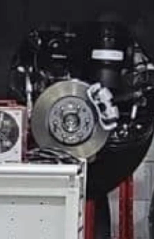

this truck has basic, Tesla, hydraulic brakes
the Urus weighs 2,000 lbs less, but is outfitted with the largest brakes ever on a production car (440mm X 40 in front, and 370 X 30 in back), all carbon-ceramic, produced in-house, under 21” rims. It goes from 100 kilometers per hour to a full stop in only 33.7 meters.
Because if you’re Lambo, and care about more than straight-line launch speed, you don’t skip leg day.

It’s always been a complaint of mine RE Tesla: so much emphasis on tech around going fast, and so little around getting slow.
That they’d ever produce a MS Plaid that could be that fast, and brake that poorly, is to me a glaring indictment.
And nothing we’ve seen about the Cybertruck, which weighs 2,000lbs more than a Uris, suggests Tesla has improved its priorities.
“But regen” is a response relevant, at best, to a normally-accelerating car.
It’s a response that is irrelevant to the proposition of the Plaid or Cyberbeast.
Big ‘skipping leg day’ energy.
Oh, and that rust and dent resistant exoskeleton sure looks sweet, eh? :cool:
You are not only a joker, but a physics jester.
So now it's "NOT" the tyres, and it's the "ABS" settings like I suggested?
How fast can you flip your brain burger?? You change your mind more often than I change my socks. ?
BTW the larger contact patch of a tyre does NOT mean it has better grip. Let alone that the Hummer tyres have bigger gaps, and weighs a ton more, which more than exceeds any "perceived" benefit of having bigger tyres, if there was actually one.
Traction is determined by downforce and coefficient of resistance, which means the compound and the interaction of that force plays per square inch of contact patch is the most important.
Bigger is not always better, the USA can't make up physics laws either, try as they might.
This is easy to demonstrate, in that a huge contact patch steel wheel is going to do much worse than a tiny little rubber one. At a not distant point of operation, increasing the tyre patch area reduces the amount of braking force as the rubber looses the downforce per square inch of contact patch required for best braking performance. Remember from kindergarten, pressure is force over area, so if you increase the area you reduce the force.

I don’t think there’s anything particularly wrong.
Vs
