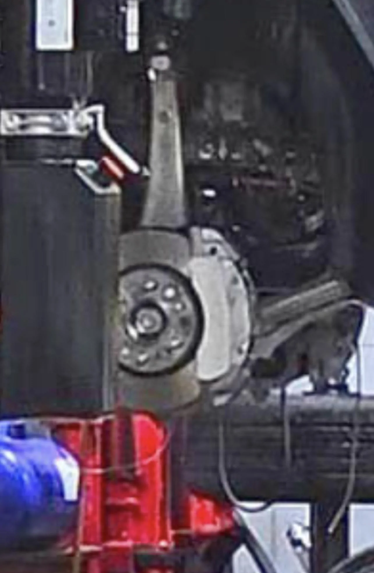

You know that is a rear caliper you're showing for the ct?
yes and it’s a totally fair point if you feel that makes the compare misleading
I was intending more regarding the disks than the calipers, and grabbed the first closeup pic in the search
so to correct that error but also better make the compare point intended
Tesla Cybertruck Cybertruck vs Lamborghini Urus: DRAG RACE 31587B46-3948-435A-A122-601FA73D5555
once we’ve seen and noted this caliper is bigger than the rear (thank you), now look at the lugs, which is the relevant compare for size.

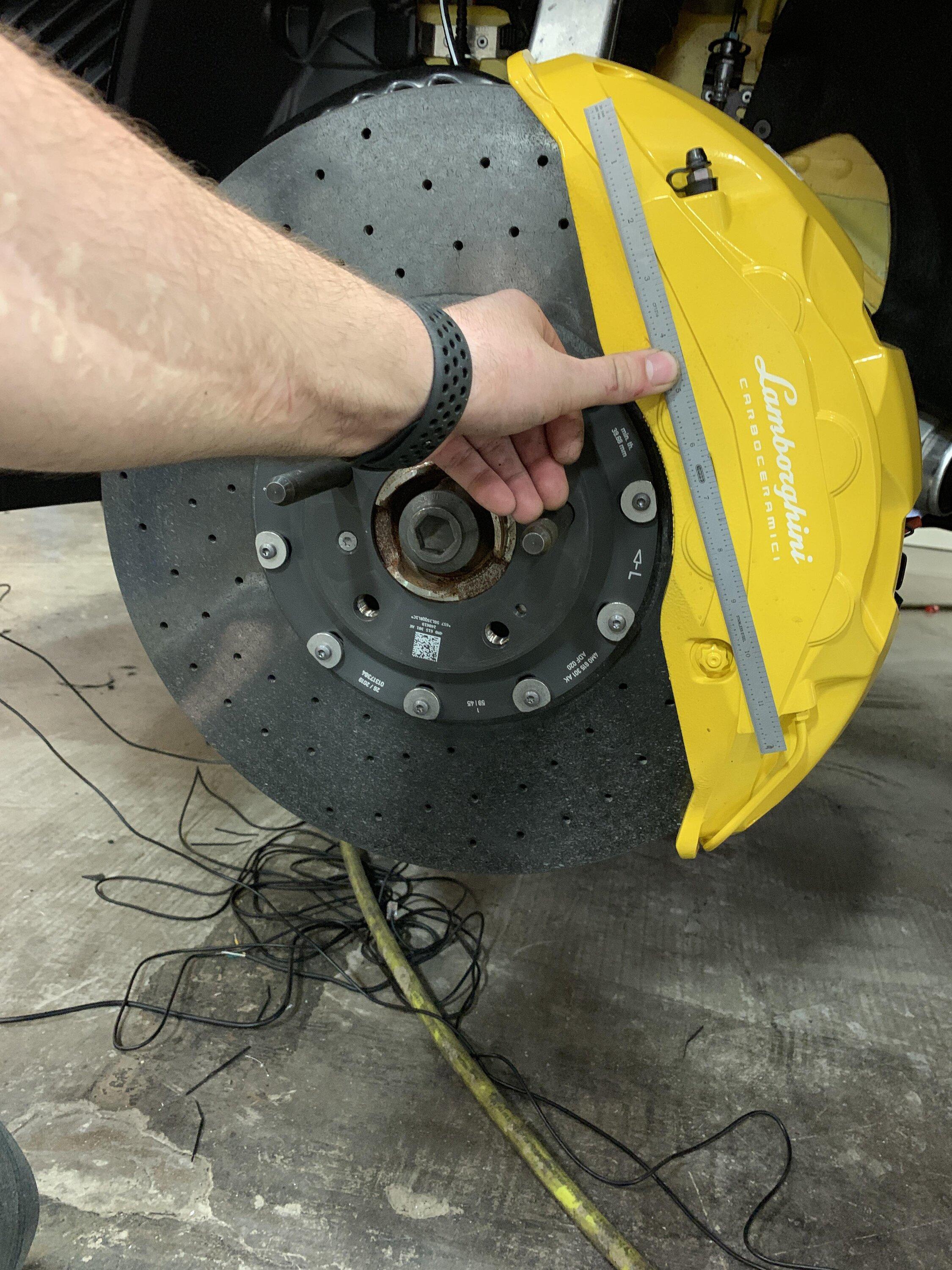

then see:
Tesla Cybertruck Cybertruck vs Lamborghini Urus: DRAG RACE D5E70327-D0A4-4DBE-94DB-4B24B2A7C9AE
and note that the CTs also appear to be some standard disk material (we sure don’t hear Tesla bellowing about their advanced brakes materials)

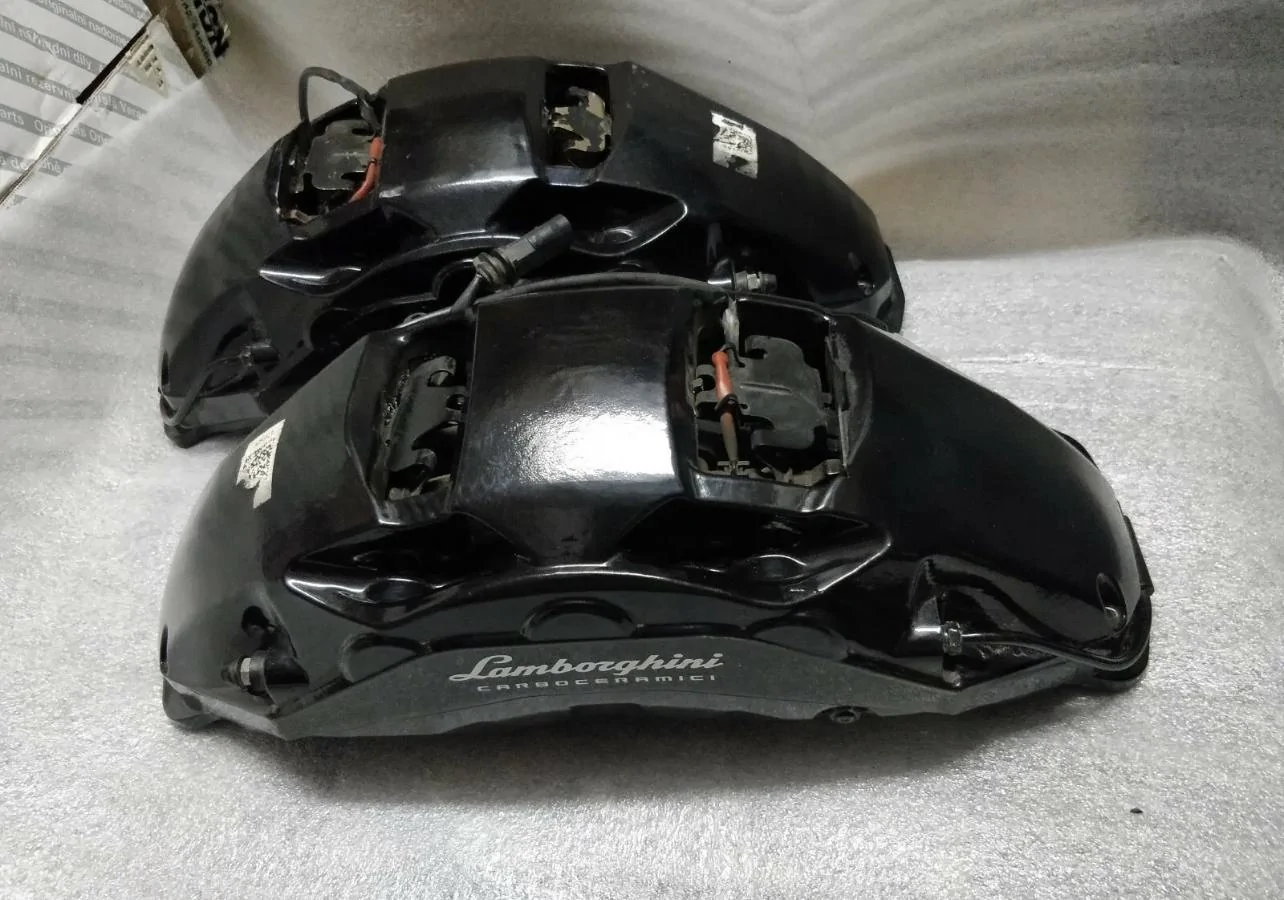

back to the calipers - while we don’t have a good compare of the beefiness of the CTs calipers, just have to show the Urus’s for the Tim The Toolman grunts

The caliper in your pic does look robust and may just need slightly more agressive pads to lower braking distance. I really think it will be fine for what it is.
