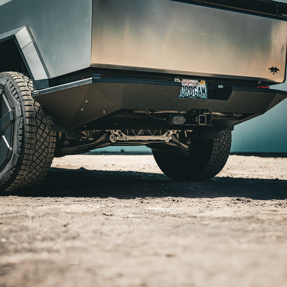

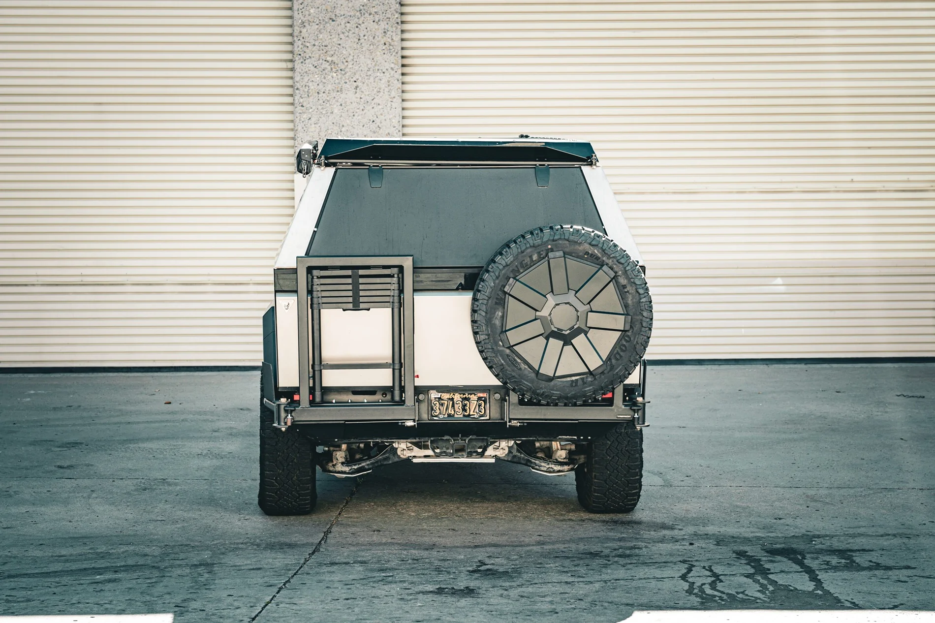

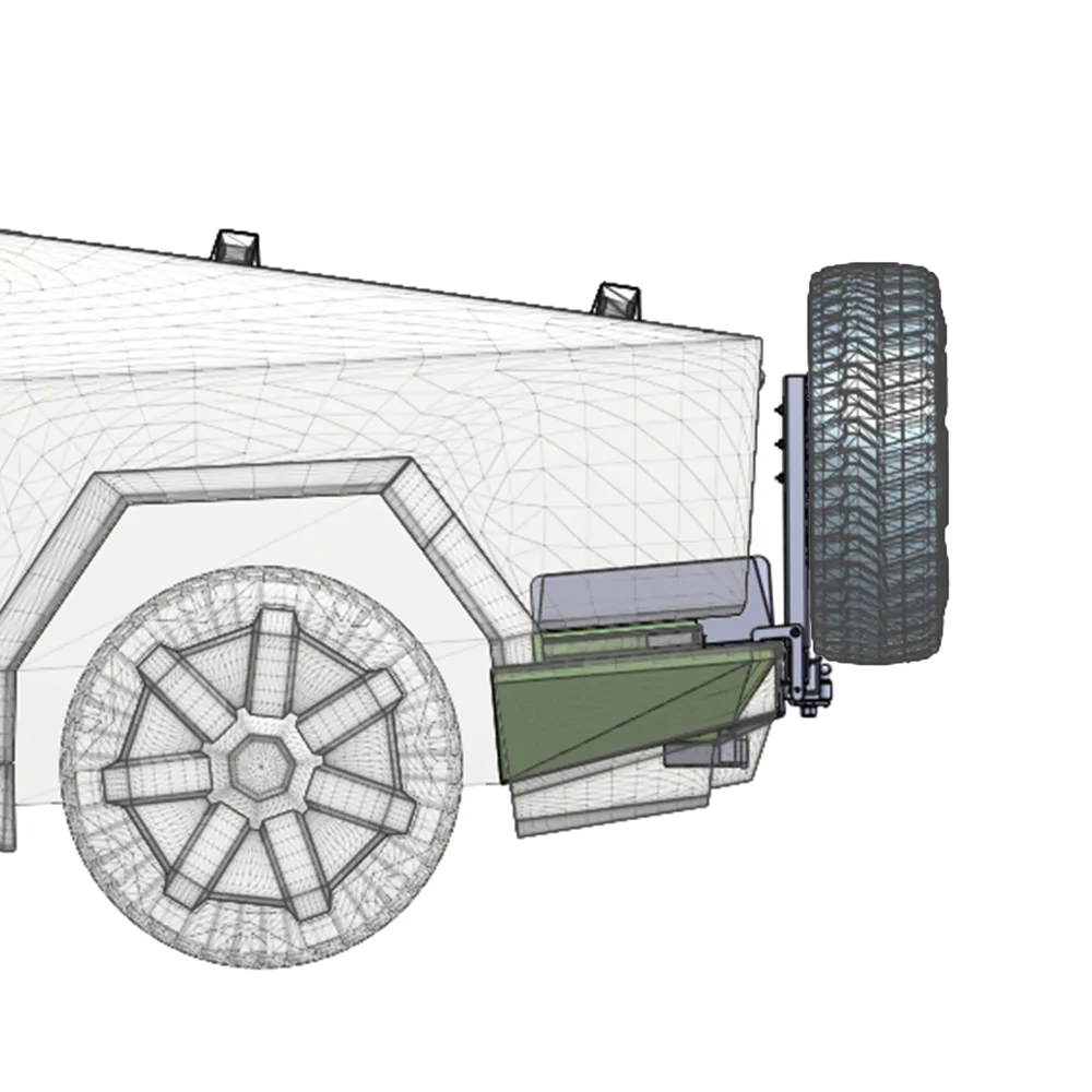

Next I am going to do the rear bumper. I think I might go with Unplugged Peformances’ as that has a swing-away rear tire holder. Does anyone know if the Unplugged Performance swing-away tire carrier covers up the rear camera?
Thanks for your business! Check out our rear bumper if you want to improve ground clearance and not have a 350lb rear bumper on it! Our rear tire carrier is also positioned hight and more to the side so it won't affect FSD.
In stock today, message me for a coupon if interested!

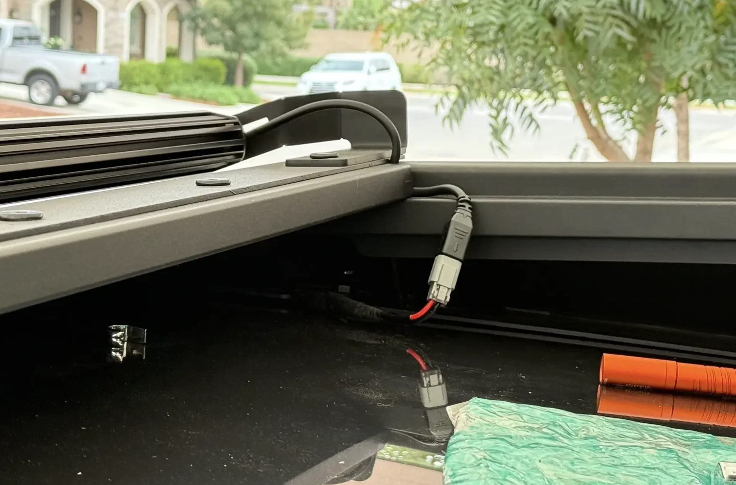

So what if you want to run just ditch lights. Is there a way to do that?
Just disconnect the Urander bar at the quick-connector above the passenger door. It can be disconnected there at any time, and the light bar itself can even be quickly removed from the vehicle in like 2-minutes if ever desired:
