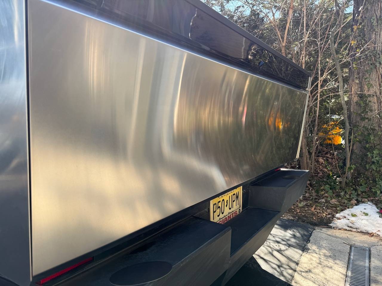

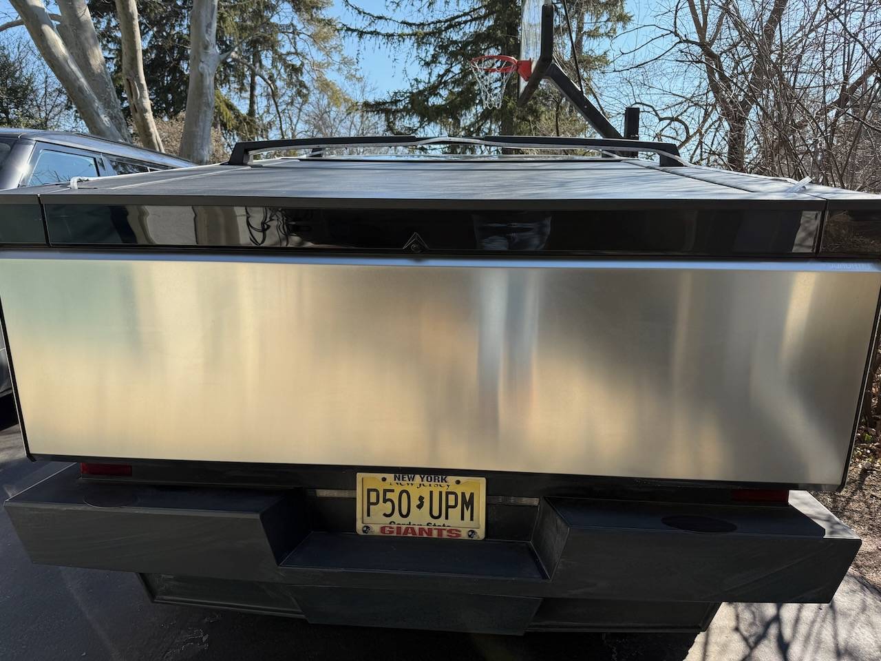

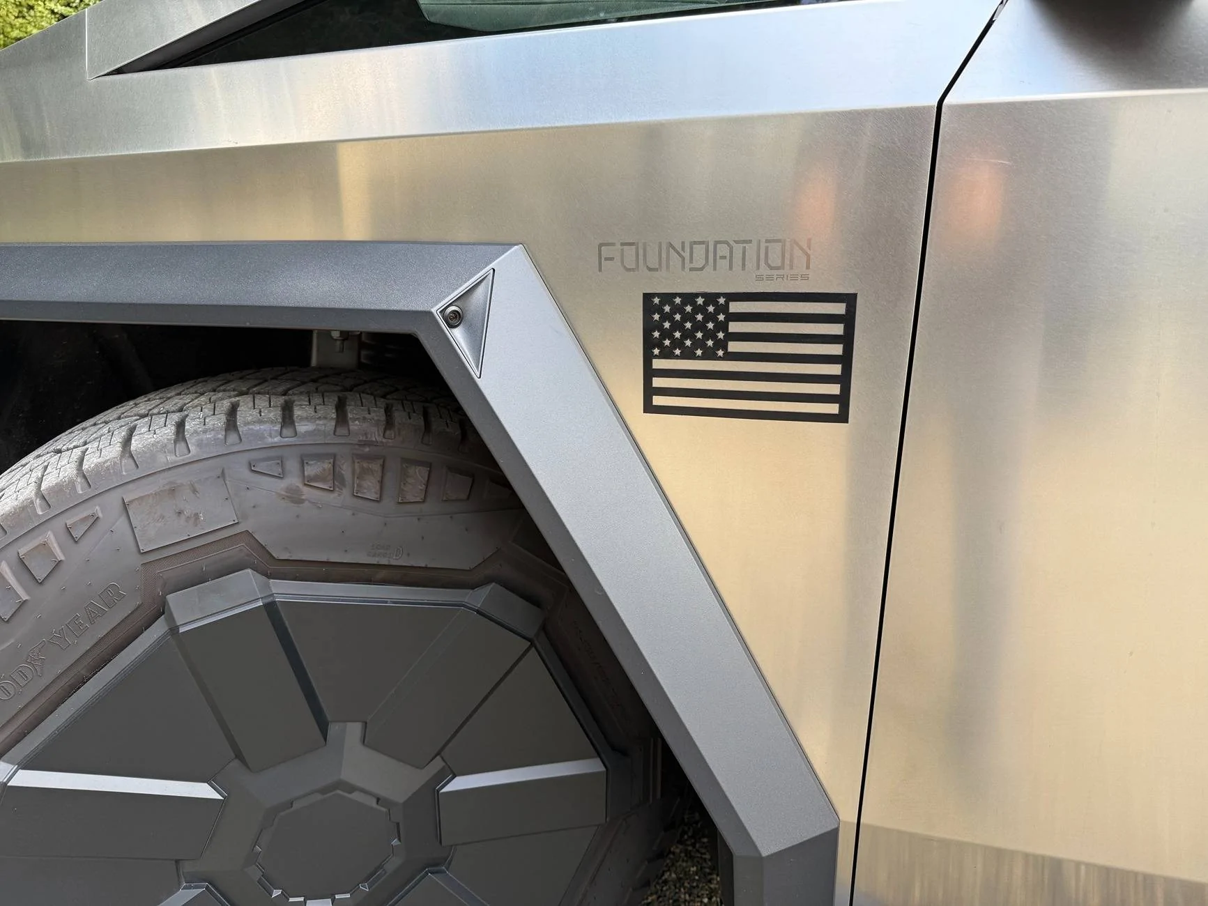

We've had two magnets on our Cybertruck for six and seven months respectively and have only been removed twice, for videos. The three-month check in was also posted on CTOC. With the rumors of pitting and corrosion, and no shortage of salt on the roads (and on Cybertruck) this snowy NJ winter, we thought we'd take a look behind the magnets to find what we can find.
Update:

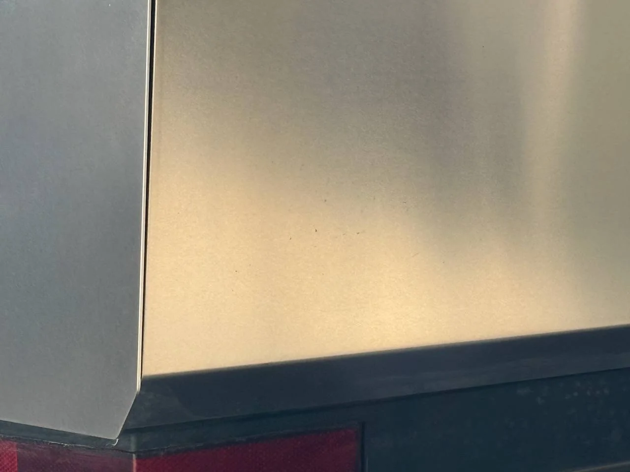

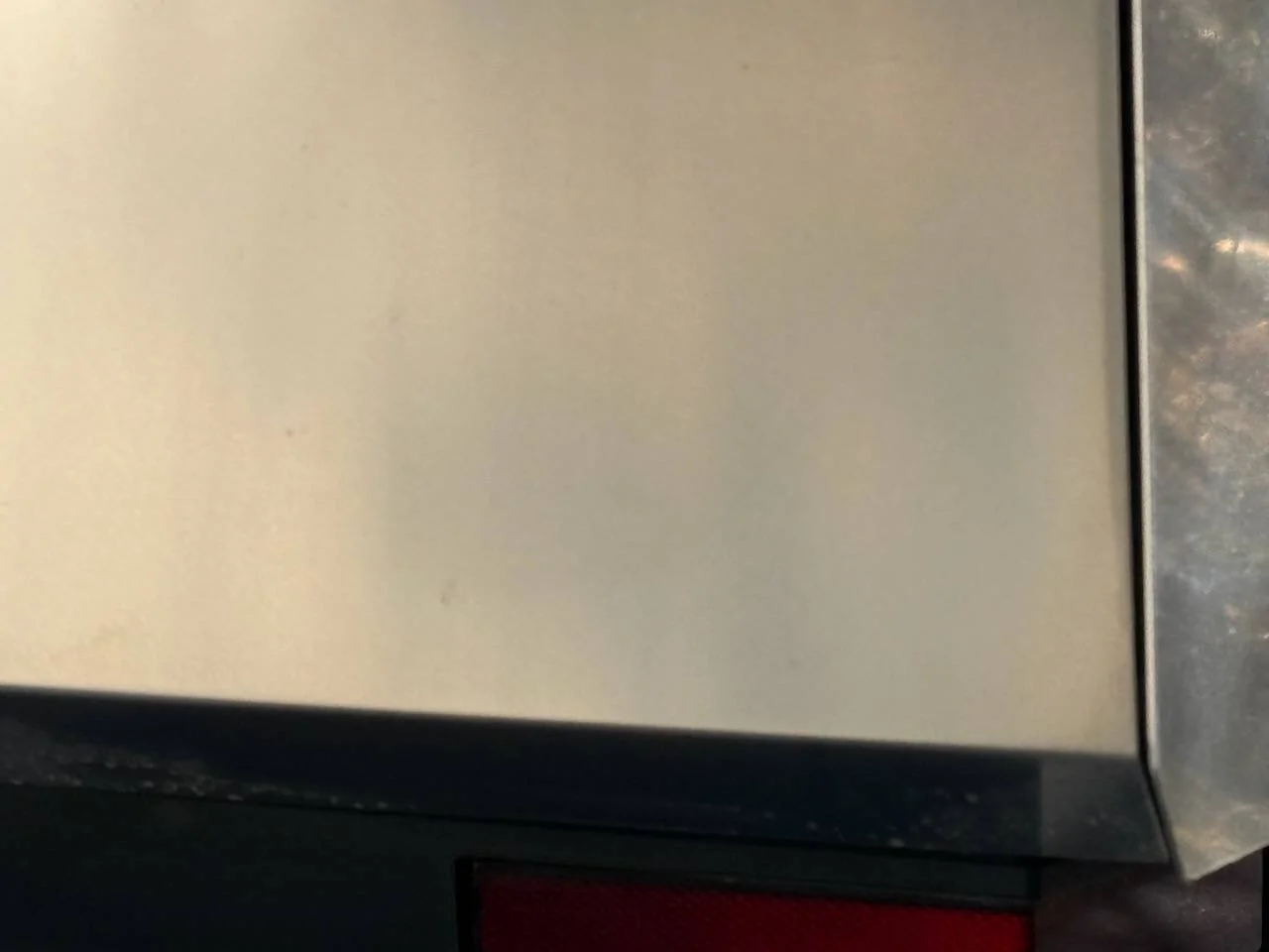

@Brandon708 here are some pics I just took with the magnets removed and the tailgate cleaned. I did get off most of the adhesive residue from the magnet that was on the driver's side of the tailgate. Pics go all the way to 5x optical zoom, I can't see any discoloration at the edges IRL nor is it easy to figure out exactly where on the tailgate the magnets have been sitting the last half year or so.

Pics posted to the thread with tailgate cleaned at various levels of zoom. Really nothing to see, you'd be hard-pressed to tell magnets were ever on the tailgate let alone had been in the same spots for 7+ months.
Thanks for the update, good info
Thanks for posting this - looks good. (y)
