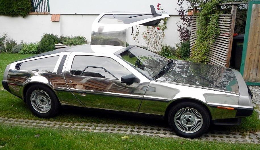

Tesla Cybertruck Stainless Steel Ceramic Coating npe-na-88043-delorean-chrome
I've seen this polished DeLorean in person. It's dazzlingly bright in daylight.
(HINT: bring your eclipse glasses)
