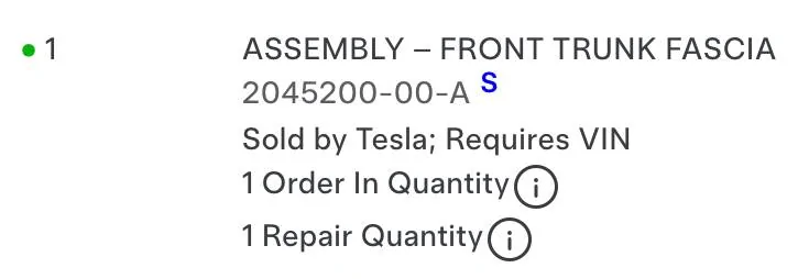

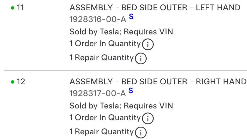

I run a small independent EV repair shop so I can check VINs on the EPC site and confirm what parts were in the vehicle from the factory.
If you feel comfortable, you can message me your VIN and I can take a look.

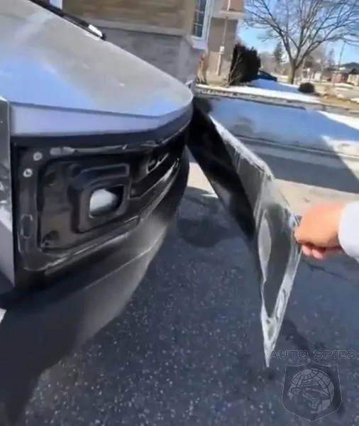

Do you have any concern regarding posts about rear quarter panels or frunk panels coming off? I see some posts, but not near as many as the cantrails. I'm wondering if the front frunk section part number has changed too.
I’d be concerned about any panel that is only held on with adhesive. There’s gotta be a more permanent fix. I know I’ve joked about it, but there’s nothing a good ol’ rivet gun can fix!
I don’t see any new PNs for the front panel

The rear quarter panels don’t have new PNs either

Might not be a large problem compared to the cantrails, Tesla might quietly fix it in the future as long as those panels aren’t flying off
