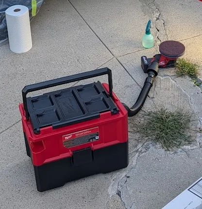

Regarding the residue control, I would definitely recommend what others mentioned: IPA wipes between pads/"grits". In my case I used a paper towel to get a first pass of residue followed by a microfiber towel for the nitty gritty stuff. Another thing that helped was connecting a vacuum to my sander.

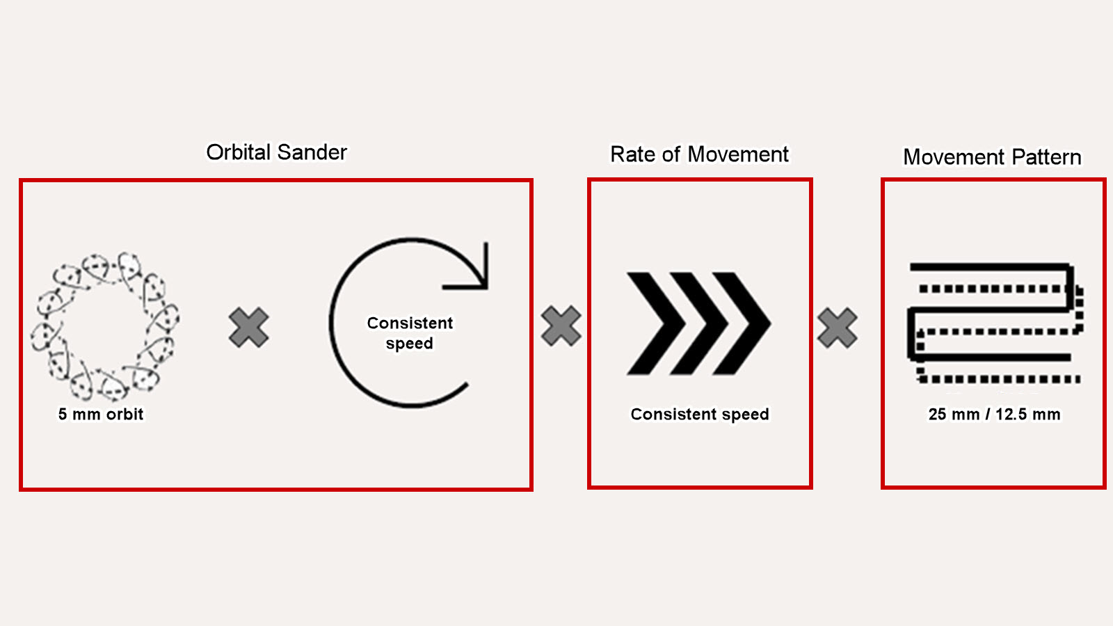

For one difficult scratch, I spent a long time hovering over the area to eliminate it, but afterwards the spot was definitely darker. I presume it was from grinding the contaminants back into the metal, and/or excess heat. (I should have used a courser pad or even sandpaper to work the scratch, but didn't want to "waste time" blending the area again. Shortcuts seldom succeed.)
My fix was to back off to a coarser grain, taking many overlapping passes and working slowly to not repeat the problem. Once the spot was eliminated, I progressed to the finer-grained pads to get back to the desired finish.
A assume this case is similar, so it can readily be corrected by starting over at the course grain, and following the Tesla-approved pattern to achieve consistency.

It looks like they repeated my mistake: working some areas aggressively at the finer grain, causing the area to darken.
Exterior Stainless Steel Panel Refinishing - Tesla Cybertruck
My "value-oriented" DA polisher has no such vacuum attachment, so I periodically wiped-down (but not IPA, it might have been CitriSurf? Windex? I forget). At courser grains, I ended up with a blackened towel that went straight to the trash lol. The finer grains produced minimal residue.

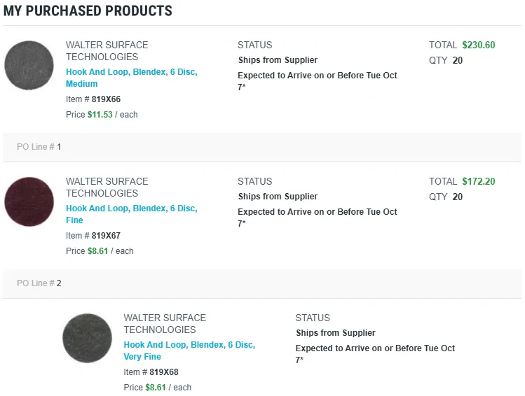

From my Grainger Order, like I said the MoQ is 20 so it's expensive...but damn it seems cheap compared to the quoted PPF cost šŸ¤”
Note, the Medium grit is the most expensive. I thought it wasn't needed, but it did most of the heavy lifting so don't skip it.

what are the Tesla specified blendex pads? I read the PDF for the refinishing process but it was awhile ago.
The only sources I could find for the Tesla-specified pads would only sell in huge lots, forcing the purchase of a lifetime supply lol. Maybe we should start a "Blendex Club" hahahaha
I ended up getting whatever I could find on Amazon (LiME LiNE), which worked "OK" but I seemed unable to eliminate the "lawnmower striping". Ended up getting some higher-quality Festool pads which were better. I probably should have swapped-out the pads more often, but I don't know how to tell when they're sufficiently worn.
Should I undertake the task again, I'll be replacing my consumer-grade DA polisher with a commercial-grade orbital polisher that is more to Tesla specifications.
