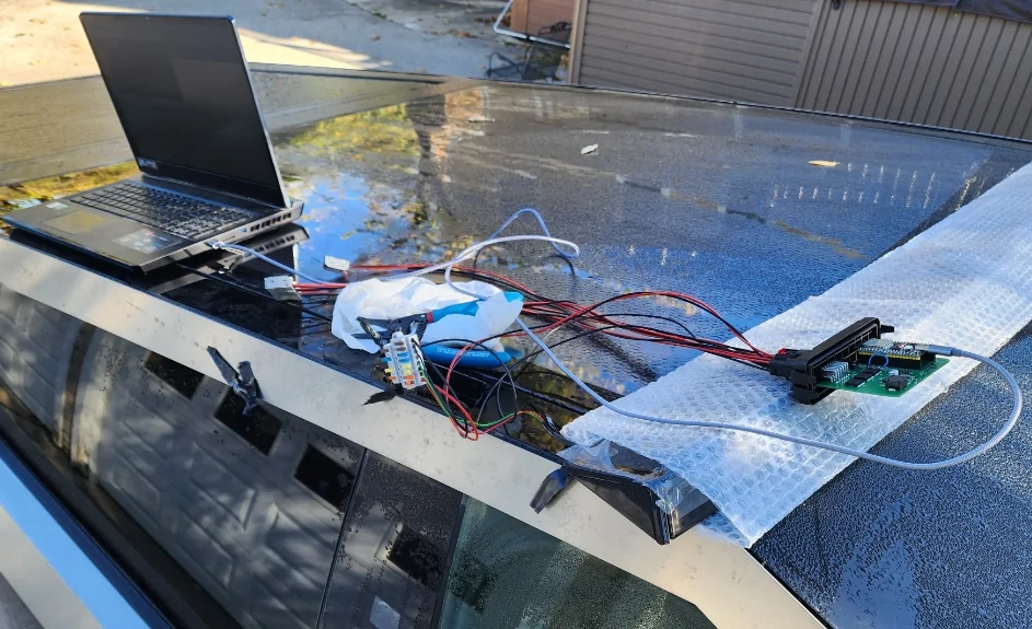

The OEM are bright and super directional. To see them off axis, I left the lightbar in bubble wrap.
Of course, more lights is more brighter 😁.
Here it is being run from the UI.

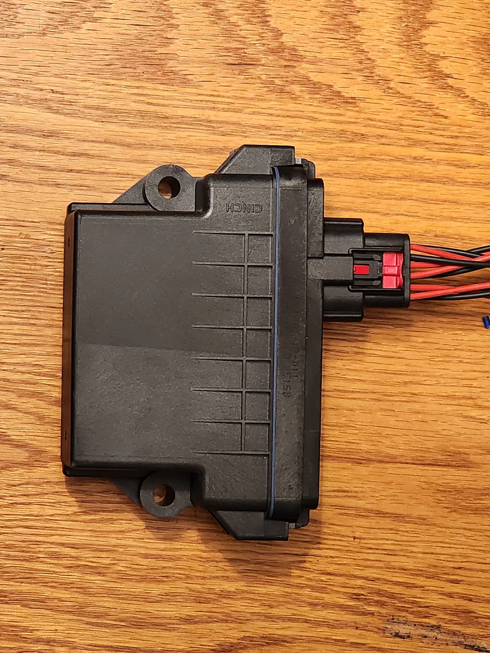

He has a 48V 50" lightbar, but it needs to mount on his MARS Expedition Rack, and it looks to be a sealed unit with a 2-wire 48V input, not sure it could be taken apart and get to various segments, maybe one large PCB inside, hard to tell without tearing it apart. I'm looking for a permanent mounted solution, I don't mind building the electronics, but it has to look good as well when completed. Thanks, Mitch
May 27, 2024
4,697
5,712
Yah, I envisioned the long white with flanking short yellows and an external module controlling them mounted to the cross bar (versus integrated into the light itself).
If wanting a six segment setup, the Amazon specials are probably the way to go mounted to a crossbars with separate module. I made a three output prototype, but it's easy enough to go to six if you don't need OEM bar control and you aren't looking for 8 amp capacity on every output. (Demo used two modules for 6 outputs).
Might be able to hide electronics in the B-pillar and run the wiring through the grommet.
Off the shelf weatherproof housing:
https://www.digikey.com/en/products/detail/cinch-connectivity-solutions/5810130090/7650220
https://www.digikey.com/en/products/detail/cinch-connectivity-solutions/5810112011/6199344

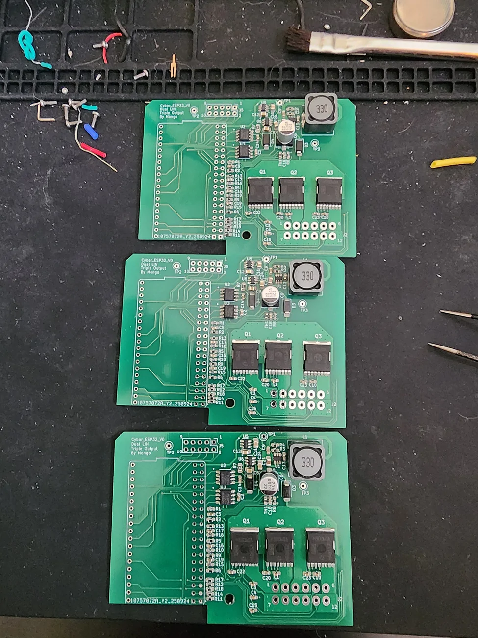

BOM for a three output module is under $100 including wire harness. So if things went well at a $199 price point and 1,000 customers you gross $100k. But someone comes in at $120 and profit shrivels up.
If someone is already making lightbars and all it takes is adding LIN, that's way more cost effective and can be a product on it's own.
Assembly (solder stencils are awesome!):

Looks like you built a custom PCB to fit in that off the shelf case you are using, is that using surface mount components? looks like it might be.. are the gerbers somewhere? or is JLPCB perhaps making it for you? curious. Thanks, Mitch
