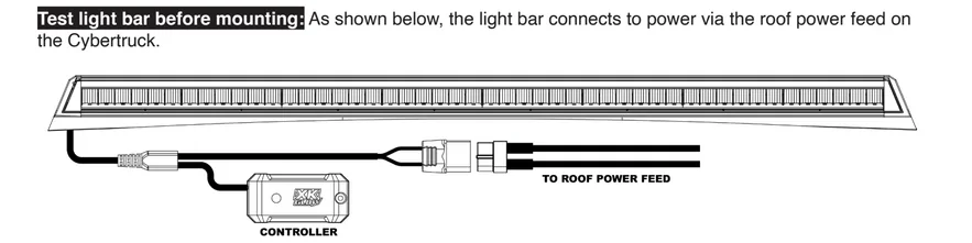

looking for a few weeks the xkglow is the only bluetooth controllable lightbar availble for the Cybertruck, which makes it a good candidate to integrate with your ESP32/LIN bus interface, to see what's possible... Until manufacturers integrate LIN BUS control into their Cybertruck lightbars (may never happen, since it's such a small market). People who already own the xkglow, and of course dual motor Cybertruck owners who can't buy the Tesla OEM lightbar, because it was $2,500 when they offered it briefly, and now it's unobtainium would be interested.. None of the other lightbars have more than simple on/off control, and really can't do much with the lightshow... even if they where intergated to the LIN bus for on/off control.
The Bluetooth controller is done by a separate control module. Theoretically, that could be replaced with the LIN interface rather that needing to bridge LIN to BLE.
The new module could then simulate the original for app control. Otherwise there's a control issue if app and LIN are both trying to control the light bar.

Yes, you could replace their controller with yours. Of course that involves more expense and work than controlling it via Bluetooth. You would have to get into their controllers interface to the lightbar and figure out what they are sending it and how.. They are probably using a variant of WLED to control the RGBW portion, and may have a simple on/off for the main part.. hard to say until you get into it, also requires building a new or modifying their wiring harness. I'm sure it's all possible, and they might even be interested in it, if it's controllable via the factory screen (at least for 2 or 3 functions, as that is all that the orignal OEM model could do). Bluetooth is the minimally invasive, lower cost method to experiment with it. LIN bus control could be prioritized over app control, which is what you'd want in a lightshow.
WLED project: https://kno.wled.ge/
