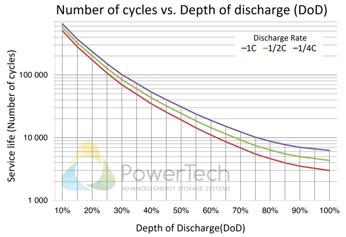

this is from a battery storage company using LiFePo4 batteries BUT tesla currently isnt using those. perhaps they will for the "million mil ebattery"

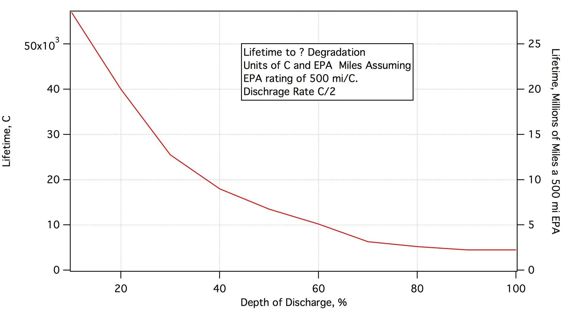

Hard to tell much from that graph but if you rework the data from it a bit you get the following curve.
Tesla Cybertruck Does anyone know the life expectancy of the Tesla Model S and the Cybertruck? LiFePo
This tells you that for this chemistry (which Tesla is not using but in which they are very interested) you can push at least 5000C into and out of this battery even if every charge/discharge cycle is to full depth. And it also says that if you can limit the charge depth to 60% you can double that. A battery with this chemistry in a car with an EPA range of 500 miles (CT TriMotor) would have a lifetime of at least 2.5 million miles.
The only missing piece of the puzzle is that the curves in #55 don't tell us how the lifetime is defined. Is it 50% degradation? Or 20% or what?
