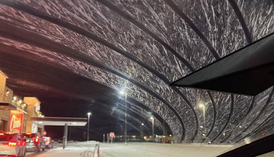

I didn't test mine a lot but thought it worked rather well through the summer. I recently got the wiper motor recall done and now it's the winter and I want to use the washer fluid more and it really works terribly. I hold the washer button down for 30 seconds or so just to get this:
Tesla Cybertruck Does everyone’s windshield wiper suck? 1737573474851-jx
(stolen from someone else in this thread, but it's exactly what I'm seeing)

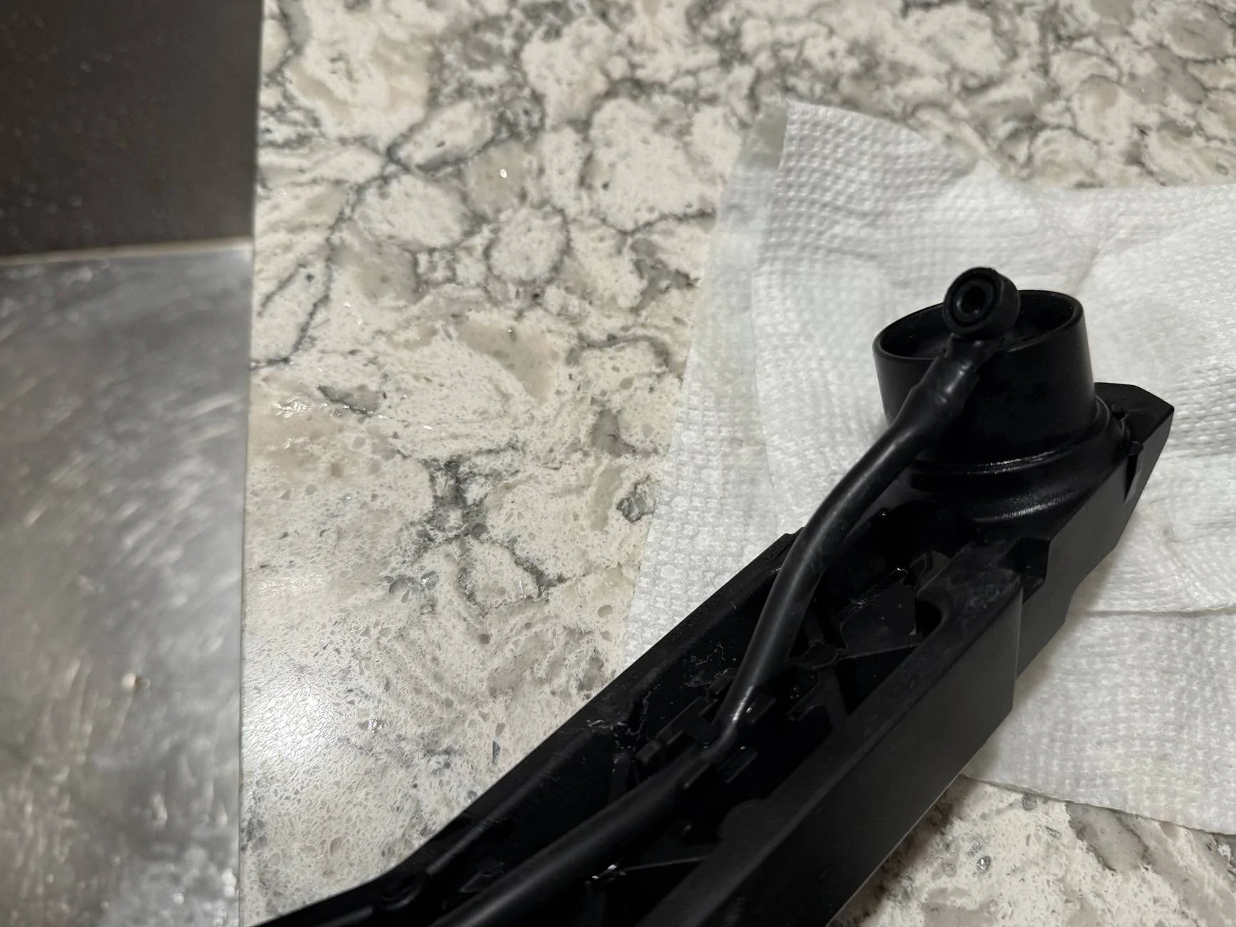

I saw stuff in here about a kinked hose and reverse installed 1 way check valve. And since the service center installed my wiper in the wrong "location" (it was 1 notch over, so the wiper was in my windshield when driving and you could see daylight between the wipers park location and the edge of the window) I took everything off and checked.
Tesla Cybertruck Does everyone’s windshield wiper suck? IMG_8901
Looked like it was pinched. It really wasn't.

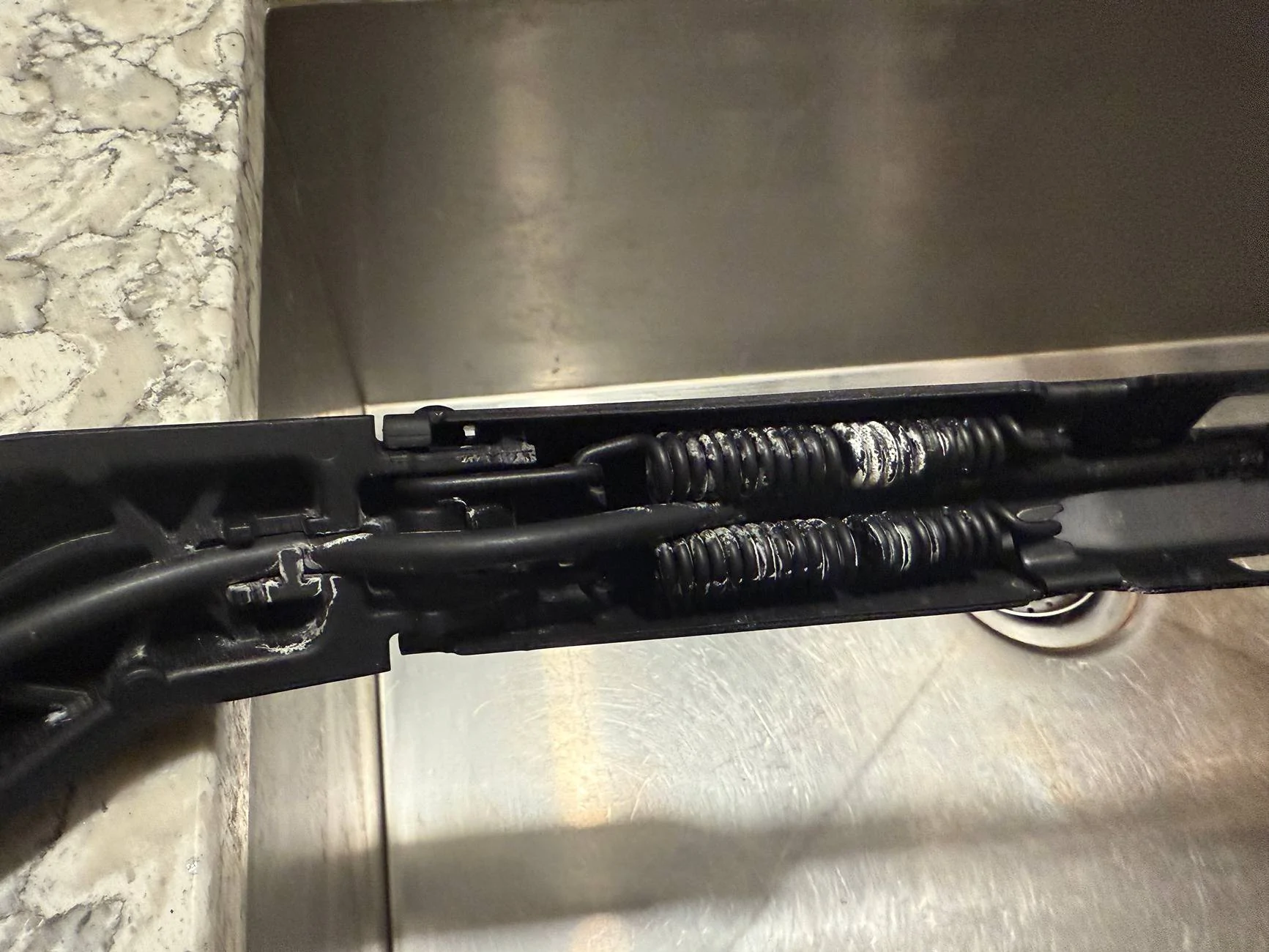

Tesla Cybertruck Does everyone’s windshield wiper suck? IMG_8902
There's the 1 way check valve. It worked. Couldn't blow through it with my mouth, but the air compressor worked.

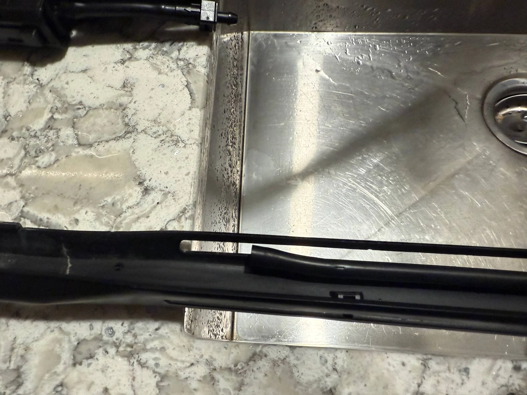

Tesla Cybertruck Does everyone’s windshield wiper suck? IMG_8903

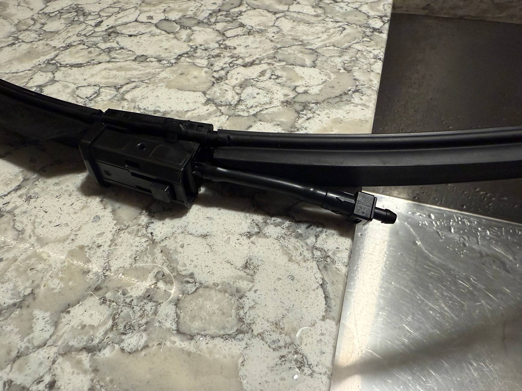

Tesla Cybertruck Does everyone’s windshield wiper suck? IMG_8904
Checked the wiper itself, water went through it and came out the dozen holes along side. The 1 way check value worked. The wiper arm hose seemed to flow water.
But still have to hold the washer button for 30-60 seconds to get a streaky mess. It really seemed better before the wiper motor recall. Scheduled service. Unfortunately 3 weeks away. Fingers crossed.

Same exact pic, it could have been taken in my truck.
