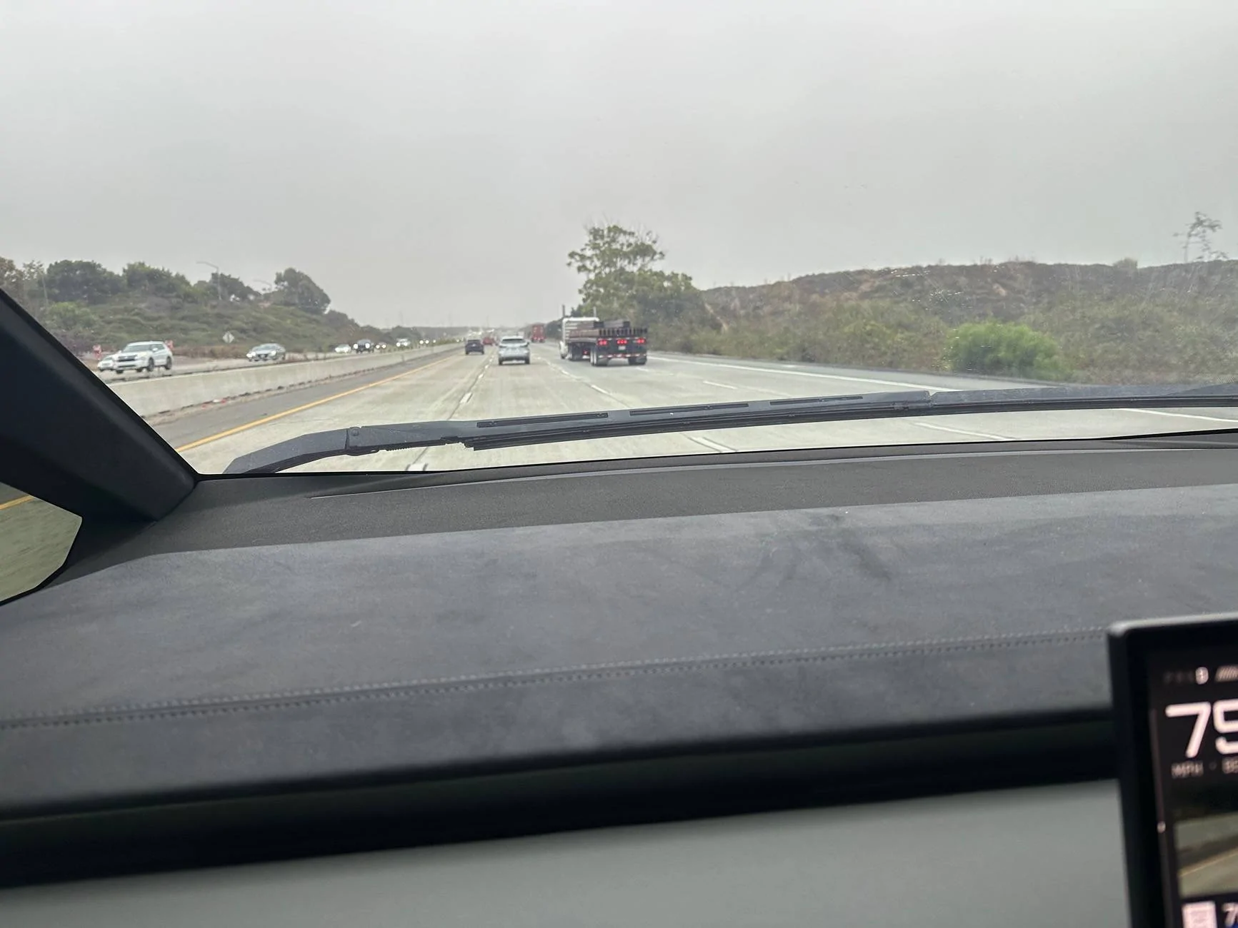

My windshield wiper occasionally turns on when it's not raining. A couple of days ago, while on a parkway, the wiper came down and stayed down in a horizontal position. I had to play with the wiper button a few times to get it to go back up. This is my first Tesla. A friend told me that Tesla has problems with their auto wiper, but this can be dangerous because it is a distraction while driving.
This just happened to me this morning for the first time. In my case, I think it was due to mist but it was definitely distracting for the arm to come down part way and just stop when going 70+ mph. I don’t even know what button to press to get it to go up other than the wiper spray button (is there a non-spray wiper button that’s easily accessible?). Is the solution to just turn off auto?

Over the last two months of ownership the wiper has done a phantom wipe maybe 3-4 times. My recollection is that it happened when the sun is low in the sky and the car obviously interprets some odd shadowing or something that sets it off.
I have a RAM 1500 with the typical rain sensor that also has its share of phantom wipes. It is a minor annoyance for my RAM, and a minor annoyance with the CT. No big deal.
To the folks flummoxed by the wiper staying horizontal: If you're traveling 40 MPH or higher, the wiper will stay in the horizontal position when performing intermittent wipes. That prevents the water from rising up the windshield as its waiting for the next intermittent wipe. If it does not need a wipe after 30 seconds of sitting horizontal, it automatically returns to vertical position. No button-press necessary; just wait. If you're traveling less than 40 MPH, it will immediately return to vertical without sitting at horizontal position for 30 seconds, because there is not enough wind force to drive the water up the glass at that low speed.

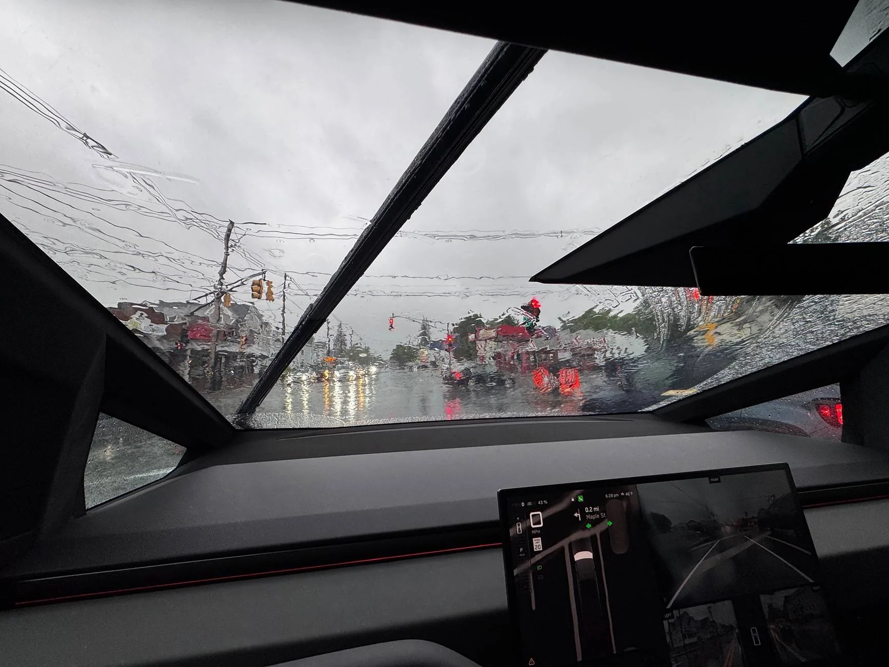

Just wanted to let people know that if you've had (or are getting) your wiper motor replaced, MAKE SURE the Service Center installed the new motor properly. It's outlined in the service manual: https://service.tesla.com/docs/Cybe.../em> <em>Motor</em> Homing after MV reconnect.
I had mine replaced back in February 2025, and the tech DID NOT install it correctly nor did he bother to test it or calibrate it. The signals for me was:
  1. When squirting washer fluid, it squirted when the wiper was going back up to the vertical position.
  2. When tapping the button to do a single wipe, it would do anywhere from 3 - 5 wipes.
  3. The blade never rested in the vertical position correctly (it was off by 5-10 degrees).
  4. When it went to the horizontal position, the tip was below the visible part of the windshield (it was wiping down too much)
  5. When hitting 30+ mph, the wiper shifts 3 degrees (which is correct for aero efficiency) but on mine it would be about 1-2 inches past the black tinted part of the windshield.
Now, the MAIN reason why I'm posting this is because last night when driving on I-93 in the Noreaster rainstorm we had in the Boston area, the wiper just broke and was stuck in the middle of my windshield. I literally could NOT see out the window. I only got home bc I was only 0.5 miles from an exit off the highway and was able to take backroads home...using the front camera and sticking my head out the driver door (like a dog) so I could somewhat see.
If I hit the wiper button, the motor would try to run 4 times but the wiper arm wouldn't move.
Note, the front camera can't be used solely to drive the vehicle bc the aspect ratio is not 1:1 (at least it didn't appear that way to me). It seemed I was at the stop light line but the camera was showing me 2-3 feet before it (admittedly, this could also be bc I was overly cautious!).
This is what it looked like at a red light with my wiper stuck.
