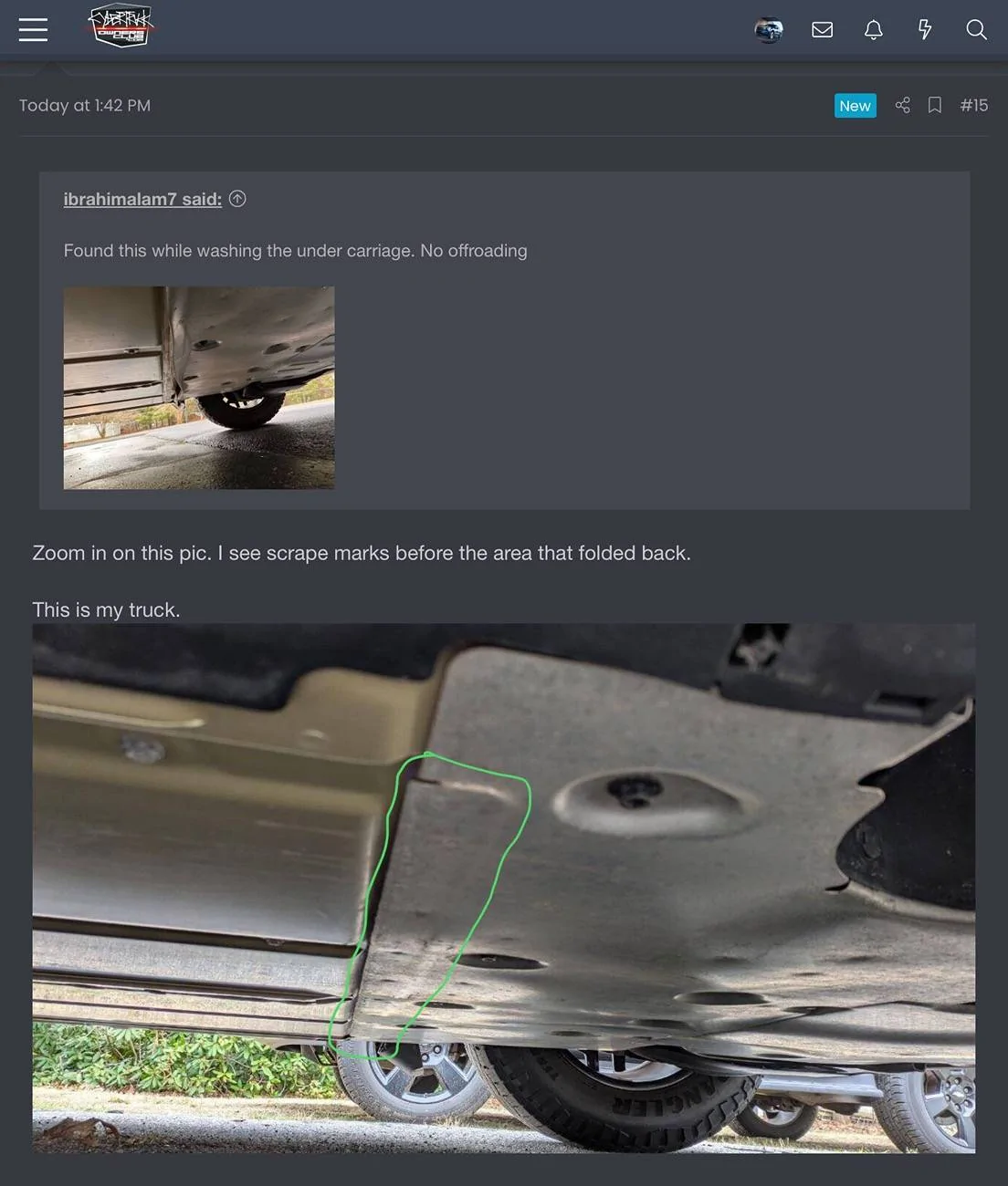

Zoom in on this pic. I see scrape marks before the area that folded back.
Looks like it’s designed to give way for what ever reason, ther is a distinct line and cut away on each side: the same area damaged on the OP’s?!

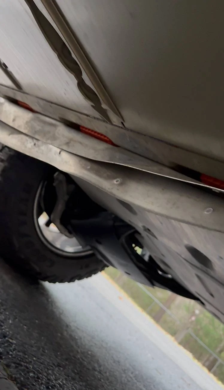

Check out this thread. I've had 2 other (offline) CT owners report exactly this issue after the recent rainy season in SoCal. My friend in Tesla Service has also reported an uptick in this from owners hitting water hard enough to peel this like in the image. Looks like a great upgrade/manufacturing business opportunity for a functional upgrade!

That piece of metal has to be made out of tin if it bends when hit by water

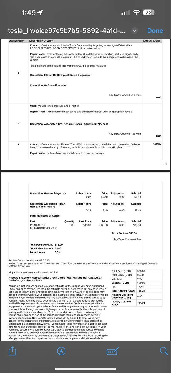

This is from hitting water puddles at high speed.
You can replace that rear cover for about $300, but it's just aluminum sheets. Fortunately, this is just cosmetic and you can bend it back if you'd prefer without damaging anything.
Slow down on the puddles, or I guess you could prevent water from getting in those flaps with duct tape ? mostly kidding

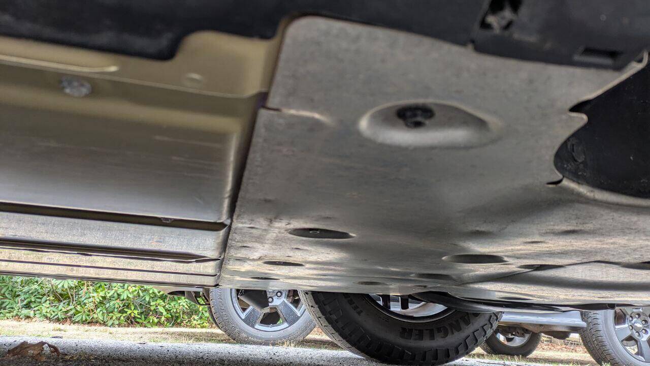

This is my truck.

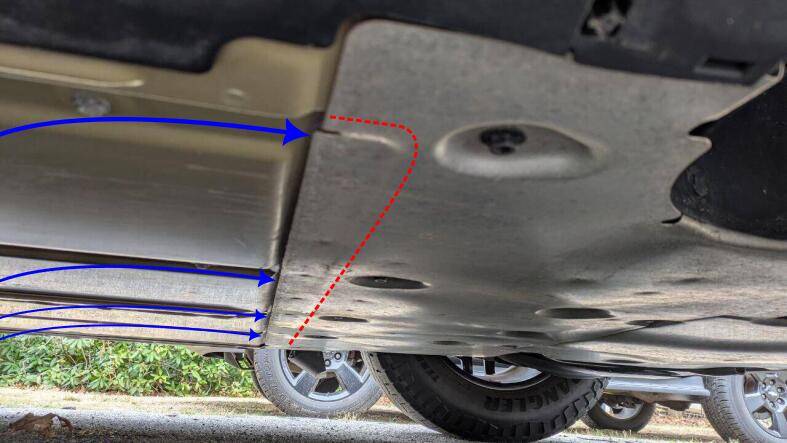

You can see on the red dotted line that the panel has been stamped and notched to go around something, weakening/widening the exact area that failed. Also, there are channels that would run water directly into that gap. This is absolutely a design flaw.
I agree, it's very "scoopy". While hitting water at high speed is generally bad for all components involved, this aeroshield is particularly vulnerable. I think it could be an easy aftermarket fix.

Sure. But when you hit water hard enough to feel that intense slow down, those are huge drag forces that are pulling on anything in reach of the water. I wouldn't underestimate the destructive power of water at high speed.
But I also agree, those aluminum covers shouldn't be designed to allow water to get ahold of them. Maybe someone could design an edge cover to fix Tesla's mistake here.

To be clear, I'm not saying this isn't damage from water. I'm saying
- this is occurring from a lot less force than you feel when driving through deep water
- Tesla could easily have bench-tested for this to identify the design flaw with pretty basic equipment.
