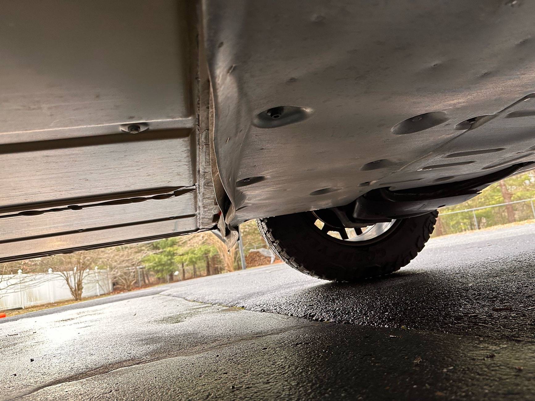

Another question: is this stainless? How thick? (It looks quite thin - maybe 1/32" - but someone with calipers would have to measure). At that thickness, you can almost bend stainless by hand.

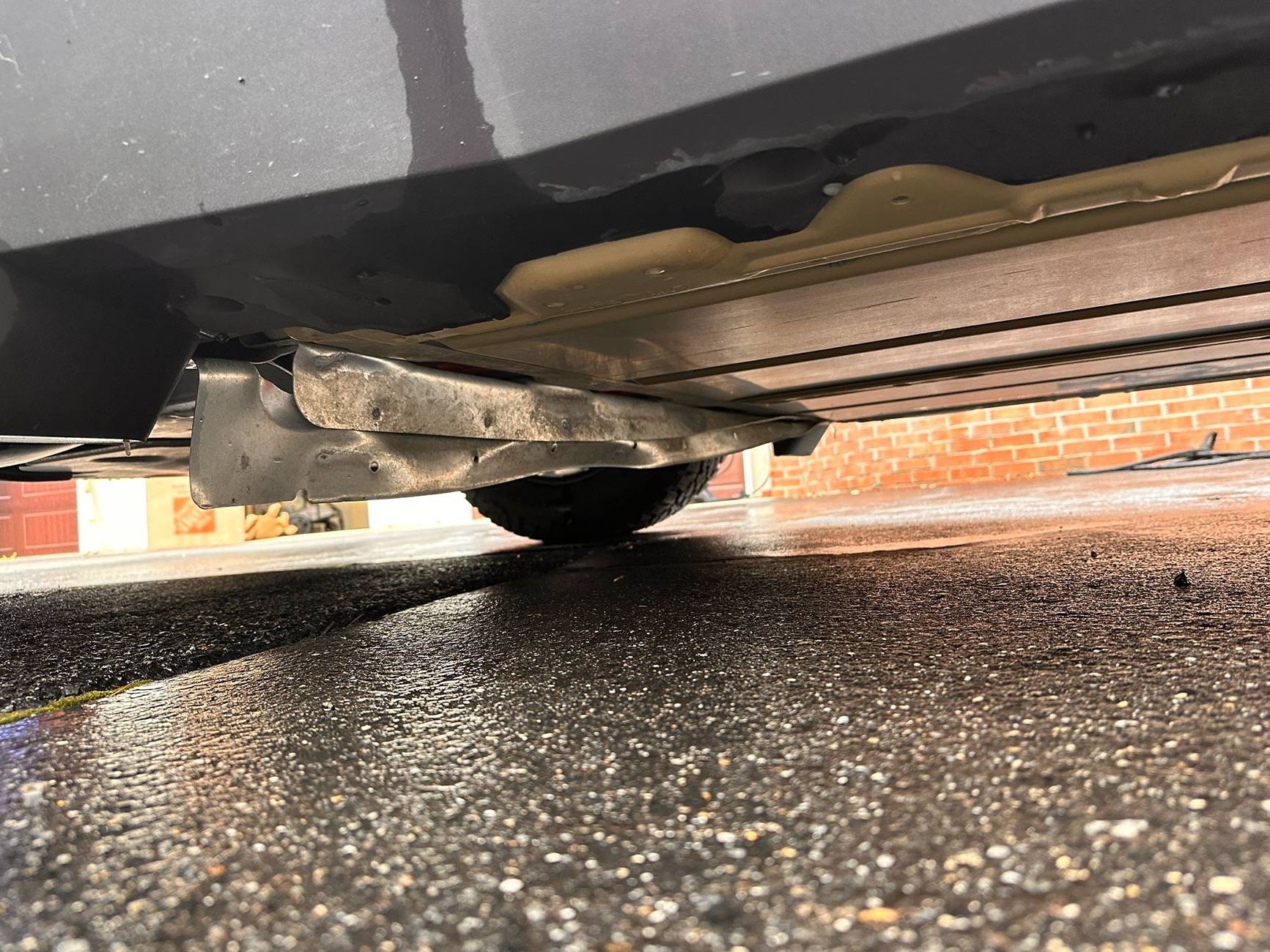

The water from a pressure washer is going much faster than 40 mph and generating large multiples more force per unit area (thousands of PSI). Pressure washers can do a LOT of damage if you aren't careful.
https://pressurewashr.com/speed-of-water-from-pressure-washer-faq011/
Look at it this way. If that folded seam is presenting something like 2 in^2 to water from the road that is hitting it with the pressure of a typical pressure washer (3000 psi), that would be order 6000 lbs. of force, which would slow down the vehicle (which weighs order 6000 lbs) with 1g of deceleration, which is panic braking on dry pavement.
So... Newton's second law actually says "try again".
To be clear, I'm not saying this isn't damage from water. I'm saying
- this is occurring from a lot less force than you feel when driving through deep water
- Tesla could easily have bench-tested for this to identify the design flaw with pretty basic equipment.
Confirmed to be alluminum :cautious:. It's only meant to be an aeroshield
