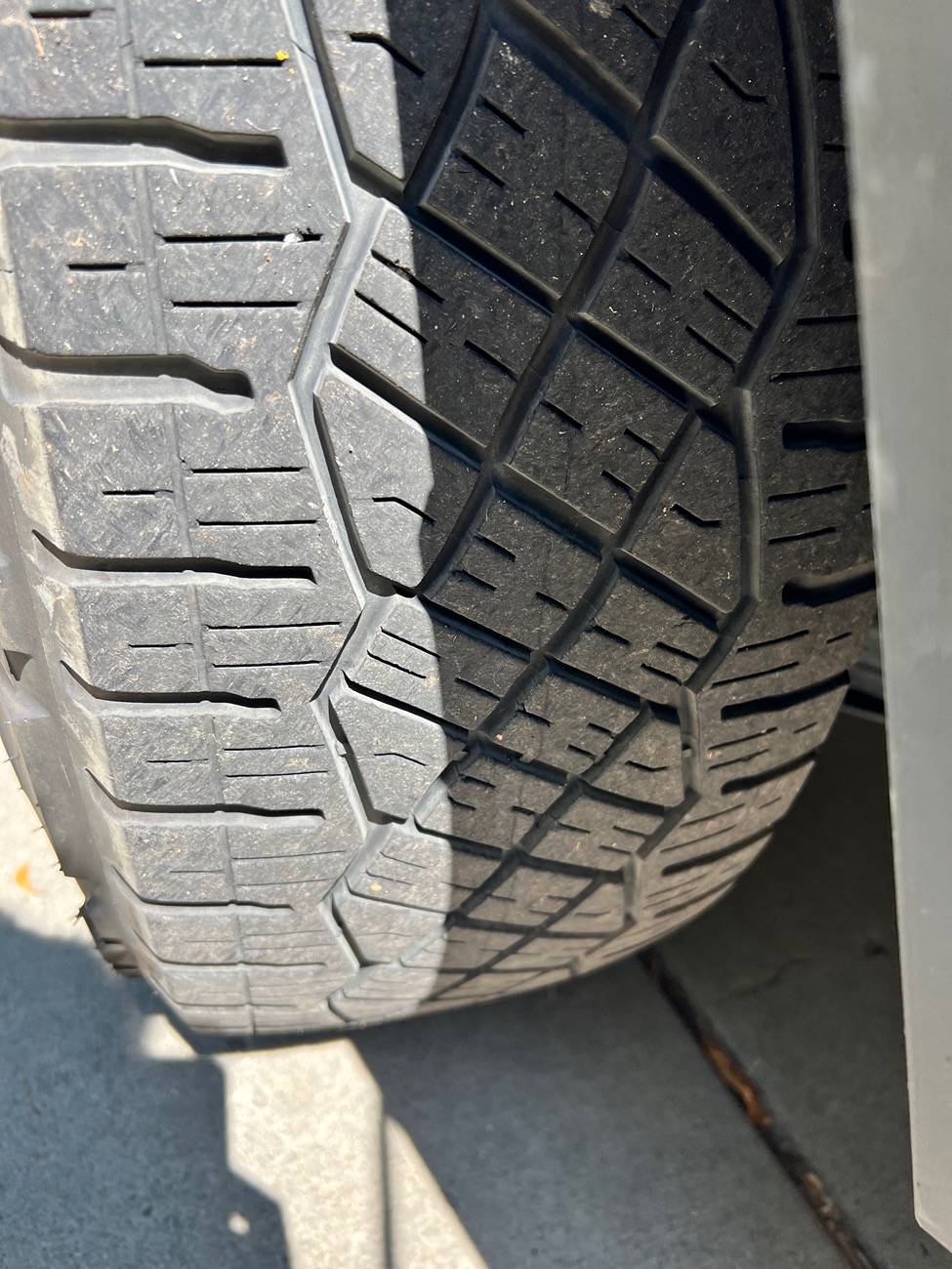

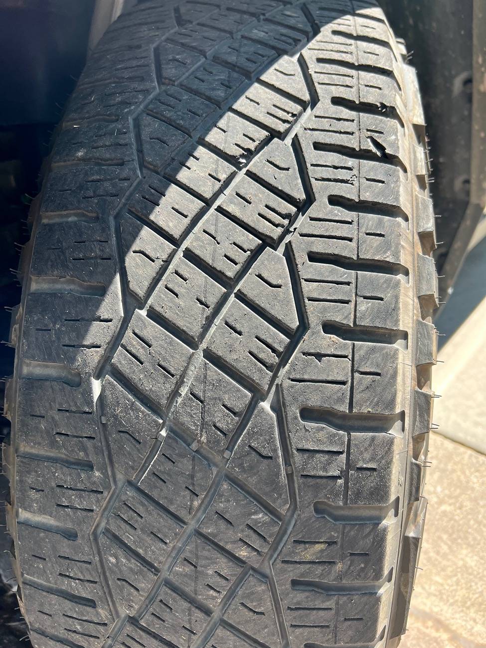

At 6251 miles the H speed rated tire on the Cyberbeast is down to 5/32 and 4/32 with irregular degradation.
Got my Cyberbeast on June 25th. Truck has always been driven ONLY on streets and highways. Never taken off road. Never hit top speed of 132 mph. Yes did experience the beast mode and 0 to 60 in 2.6 a few times.
Yesterday I was going to go to get tires rotated as recommened in the manual at 6250. Truck is a t 6251 miles AND.... I noticed tread is low.
I measured it. 5/32 on rears and 4/32 on fronts. WOW! That's insane!
I did some research and the H speed rated tire has a sticker rubber. But for it to last just 6K to 7K miles on the Cybebeast has to be a manufacturing defect. These tires are specially made for the Cybebeast so for them to be this bad is unforgivable. I have an appointment on Oct 1st to discuss this with TESLA.
Check out the photos at 6251 miles.
They
look like they've been off road.

Something isn't right here. I have a beast and drive the crap out of it. 5200 miles, I've hit 127mph, multiple launches, drive in beast mode all the time, multiple trips towing a 6500 lb trailer, off-roading, drifting sessions in dirt lots... I'm enjoying the truck. My tires look close to new. The spalling/chipping on your tires is not normal wear. Either there is an issue with those tires, or someone did some serious joyriding when you weren't looking.

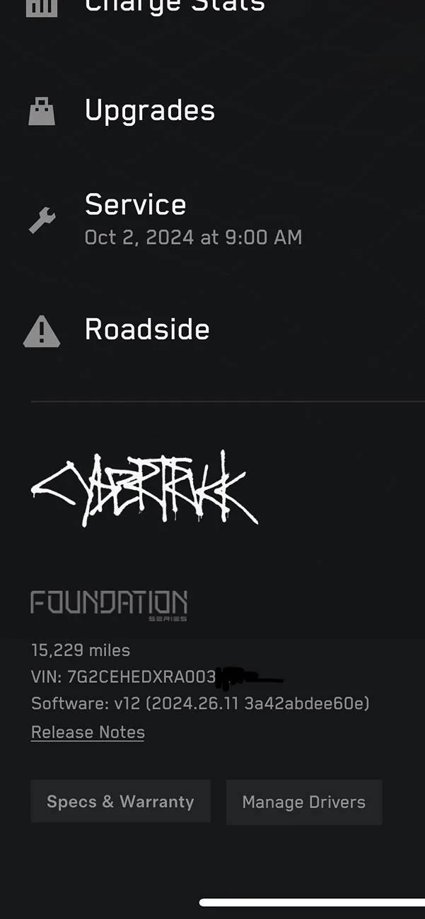

Agreed, OP either got a bad batch of rubber with the CB or OP is driving way harder than I am in my AWD CT. My tires look mostly fine after just crossing 15k miles of winter/summer mix of city/highway/off-roading and included towing my 5000lb camper with a full vault for ~1000 miles. I've rotated once at 9k, about to rotate again but they've been wearing evenly at all four corners despite the extra loads. I've done a fair bit of full-throttle stoplights/on-ramps, drifted the truck in snow/ice, driven hard through the twisties a lot, off-roading in rooty/rocky eastern terrain and more recently rock-crawling and trophy-truck-style driving (the Offroad Modes are Badass in this truck!) in the desert southwest, but also a lot of Chill mode around the City and long highway drive between UT-CA-VT this year. My rubber looks nothing like the chipping and edge-wear on the blocks that OP's tires show (see pics of mine).

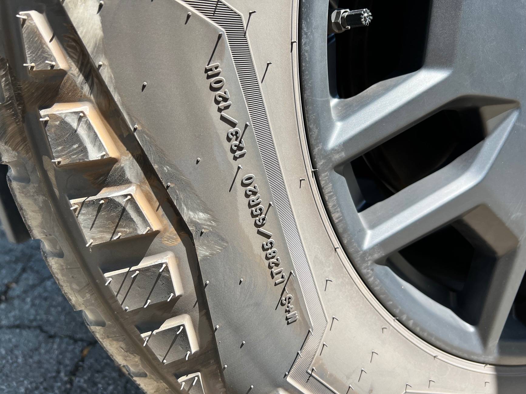

And btw, my tires are the H-rated rubber, VIN 3XXX.
So, either OP'll need to come clean on beating the crap out of his tires, or convince Goodyear to take a hard look at the production batch OP's tires were in, for a flaw in production for the batch run. Good luck!

FWIW, you definitely won't want those tires on your CB for winter snow driving...they're greasy. I had them in ID/WY/UT during March/April storms and it was dicey despite fresh tread... it's definitely not a winter compound. I'll be investing in a set of 3Peak snows for this winter, no question its necessary for the winter drivers among us.

That is odd tire wear for sure. I have only seen that sort of wear on hard compound eco-tires that were thrashed on the racetrack. They start losing little chunks instead of just wearing down.

See now that is very interesting. I am 100% sure that the truck has never been off road and that's why I think this is a tire defect. What month was your CB delivered? Mine was June 25th.
Exactly what I am thinking. The rubber is just coming off. Has to be a tire batch defect.
