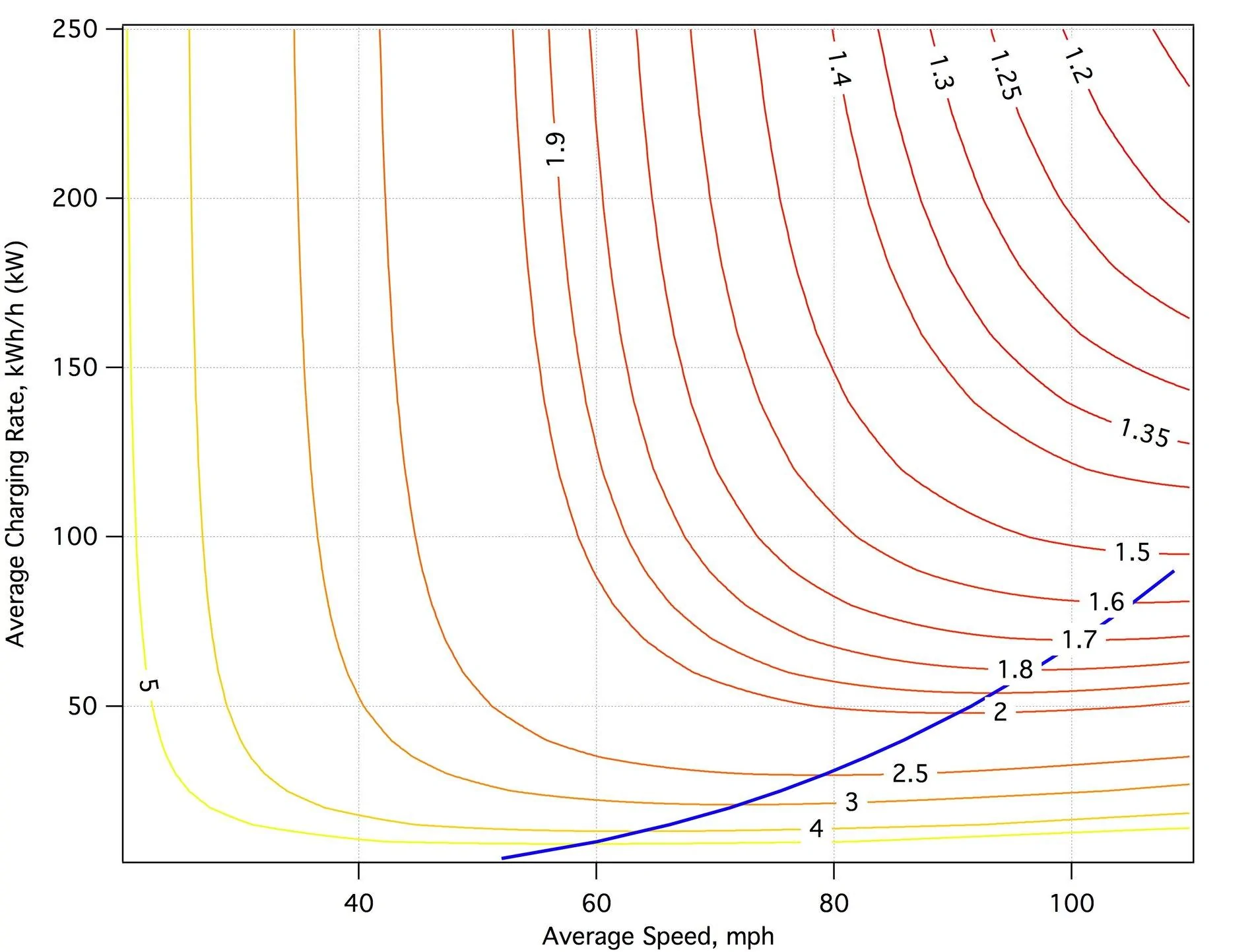

driving faster seems to be the intuitive way to get there faster.
And it obviously is unless you need to consider refueling time in the denominator of your speed calculation. Clearly if you do not need to charge on the trip you do not need to consider refueling time but if you must charge along the way you do. The mechanics are simple. The faster you go the less time you must spend in transit but going faster causes your vehicle to consume more energy per mile traveled so you must spend more time at the charger replacing it. If you define trip time to include time to replace the charge consumed and use minimizing that time as your optimality criterion there is an optimum speed. It is tricky to find as it depends on so many things but as we often do we can make lots of assumptions to at least give us some insight. The following graph uses a model of average consumption as a function of average speed based on my driving history in my Model X plus. The various curves are labeled in total time to drive 100 miles plus the time required to replace the charge as a function of available recharging rate and driving speed. The goal is to minimize total time which means to get onto one of the low time curves at the upper right of the picture. The graph clearly shows that one does this by driving fast and using a powerful charger.
Tesla Cybertruck Exciting Battery Day topics coming to light OptSpeed
But a driver can't, in general, pick the charger size he wants but rather must use what's available. Thus his strategy given, for example, a 50 kW charger, is to move to the right as far as he can along the 50 kW horizontal line until an incremental increase in speed results in an increase in total time. That happens when he passes the mimum point on each time curve. As these are hard to see the heavy blue line indicates the optimum speed for each power leve (about 92 mph for a 50 kW charger).
The broad conclusion we may draw from this set of curves is that for an X one can shorten overall trip time by increasing speed up to over 100 mph as long as 80 kW charging is available. And we note that this about the average rate observed from 125 kW Tesla Super Chargers. Coincidence?
