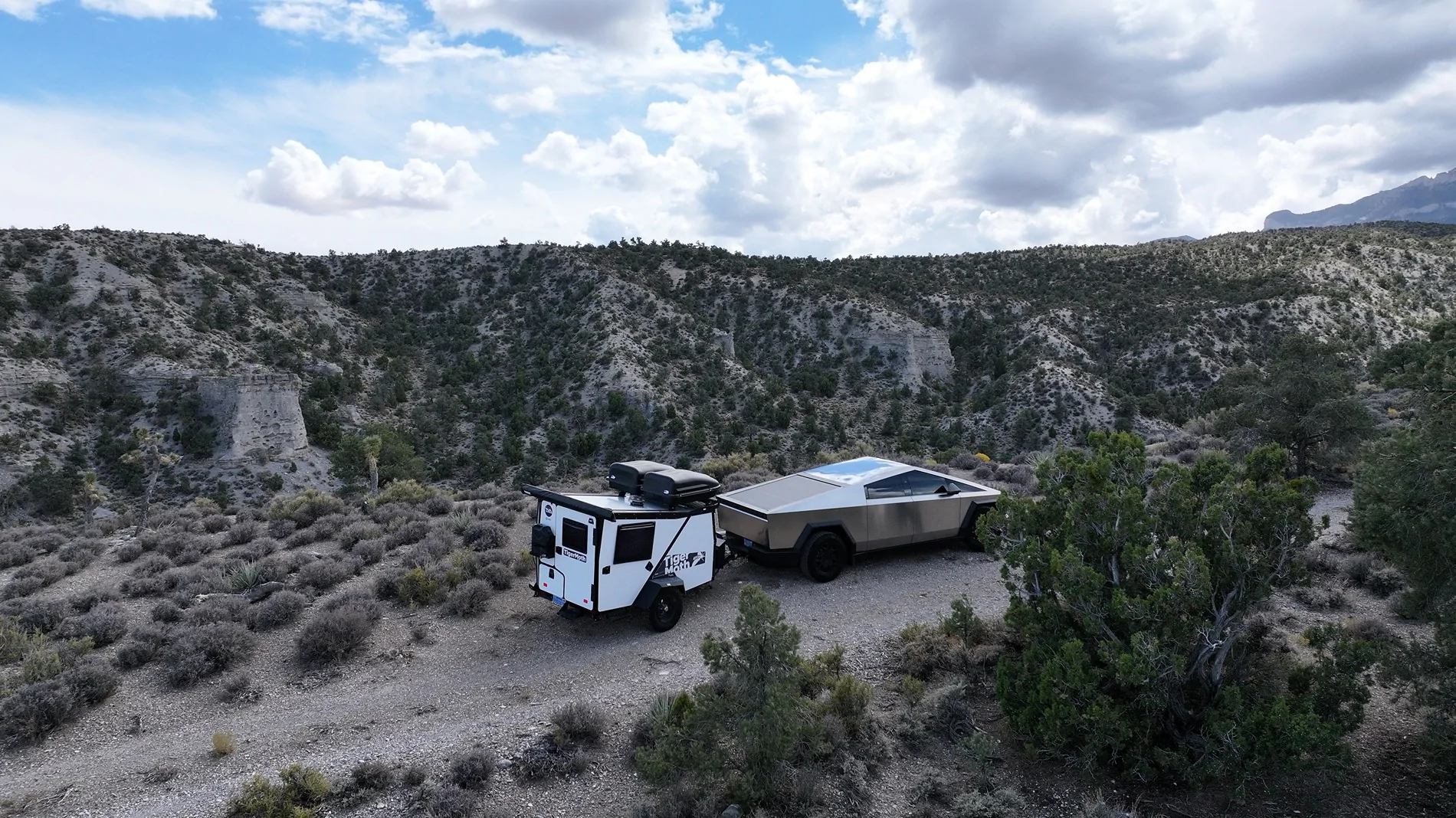

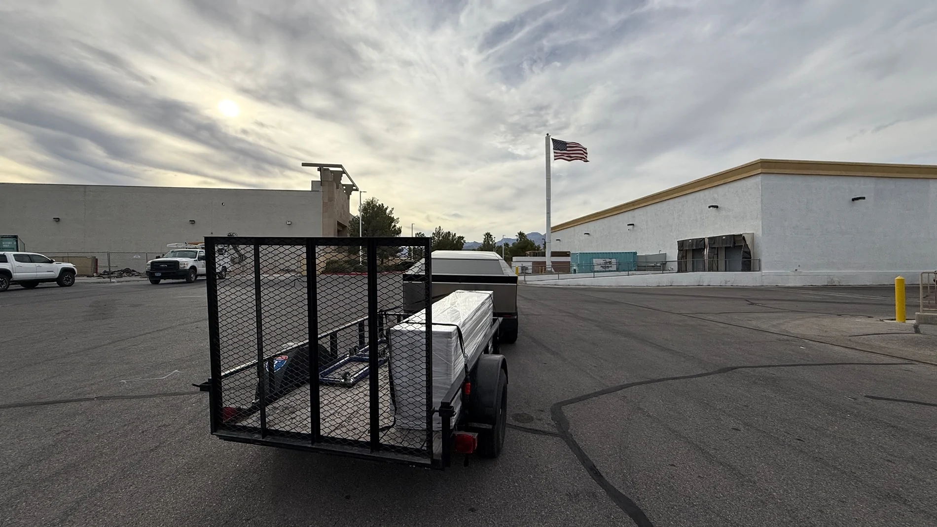

Well yes. If you’re boondocking in your Cybertruck you’re either going to attach something to the top of it or be pulling something behind it.
And while I respect Wyoming for it’s beautiful scenery you guys have speed limit limits from the turn of the century. Where I live to get to you or any anywhere else I want to be out in the back country I’ve got to get through large stretches of freeway where the speed limit is 80 and the average speed of vehicles is 90 (that’s including big trucks and vehicle vehicles that are towing).
This is not theoretical; it’s a non-starter. With my trailer (which is not an occasional use case scenario for me) in my Cyberbeast with the itinerant circumstances described above I have absolutely no confidence that I can travel more than 110 miles— maximum.
