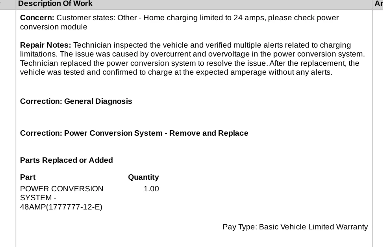

Here’s my service ticket for same issue…
Tesla Cybertruck First Cybertruck charge at 24A max IMG_7796
