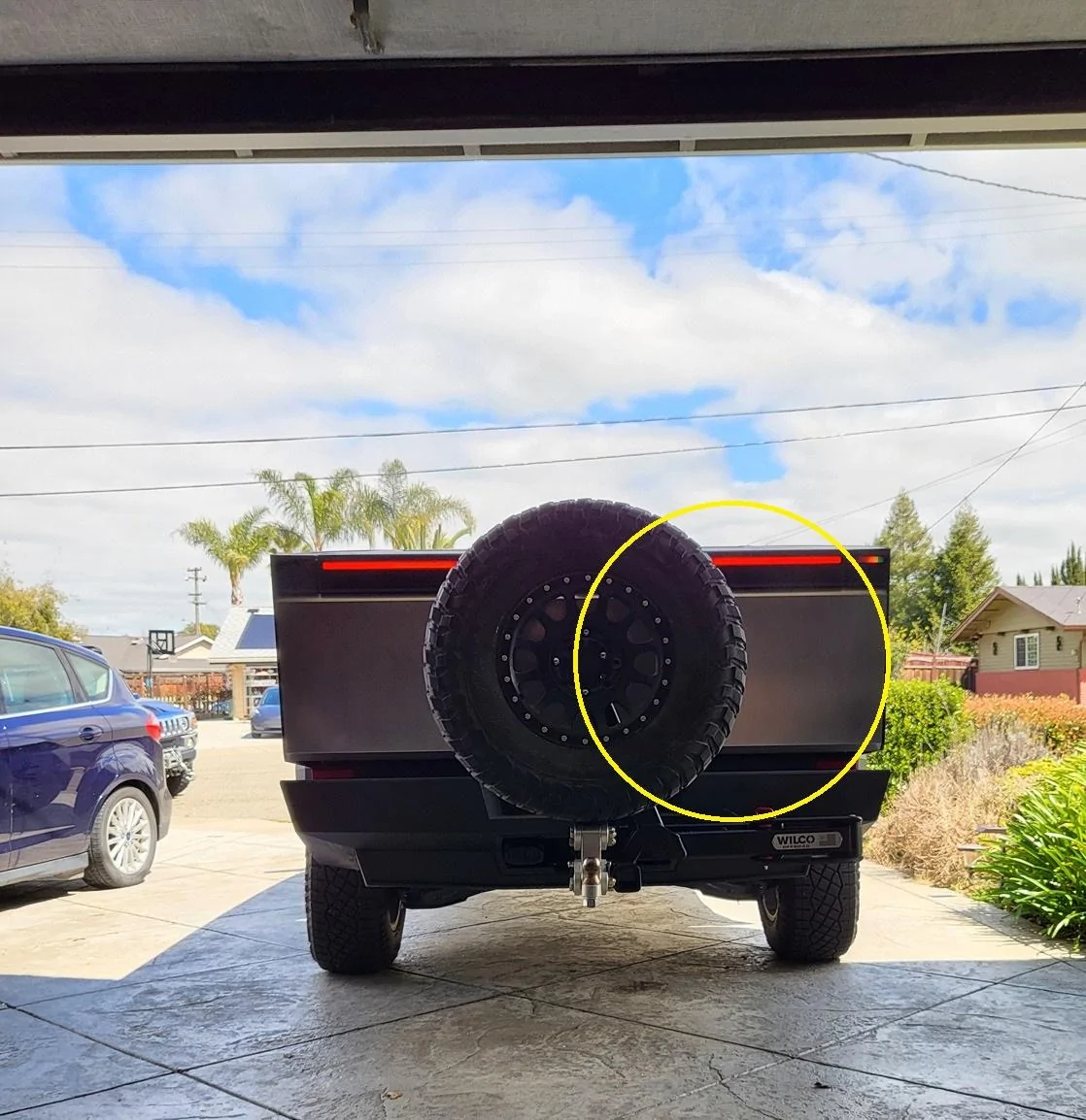

I think it might just clear both, some of the rear view would be showing tire though because it's wide angle.
I relocated the camera to swing arm middle of tire area with extension cable. You can pick up on line, Amazon.

On a 35” tire I think even offset it will cross the midline of the truck and block the camera.
as for the license plate, I’m pretty sure in PA it’s legal to block the plate with a rear cargo carrier that’s in use but not when not in use. So a bike rack with bikes in it is ok but an empty rack folded up and blocking the plates they could technically pull you over. I’m sure other states have different rules about it.
again......camera is blocked anywhere you put a 35....I moved the camera with extension cable provided on Amazon to center of swing arm at tire area.....License plate moved to swing arm on right side with a light tapped into OEM plate lights....done. Legal, done.

That's legit badass! But if they're calling this a true Cybertruck integrated solution it should have a way to relocate the camera.
already did and license plate with lights. Amazon has the cable extension for camera. No adjusting or anything. I'ts located in middle of tire on swing arm mount. Perfect spot and wide angle is 100% again. Tesla rim is 0 offset/flat so camera is only 1 inch countersunk to outside edge of rim.

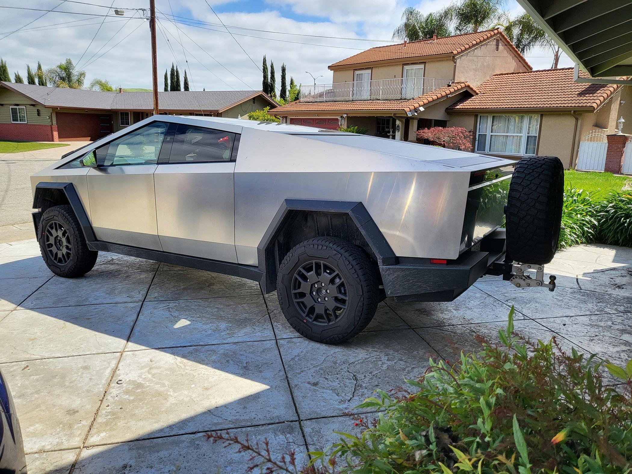

Yup, I did it. First in the world. This company Wilco Offroad makes the only one that actually works and fits with no modification.
It looks like that puts your tow ball about one foot aftward. Just be aware that this will lower the allowable tongue weight and the maximum tow capacity. It also reduces responsiveness when backing the trailer and makes it incrementally less stable at higher speeds.
right. Im a truck driver and very aware but it's so minimal. All the equipment is rated at 10k lbs and 500lb tongue weight. Stabilizer bars are the best for any towing, just so you know.
It's not minimal. The are two relevant metrics when moving the tow ball aft:
A) Distance from the tow ball to the rear axle.
B) Ratio of wheelbase/A (above)
In this case, moving the tow ball aft by a foot increases distance A by about 25-30%, a very significant change that impacts both important metrics, substantially impacting tow dynamics for the worse. This gives the tongue of the trailer a lot more leverage on the tow ball, and on the steering wheels. On slippery surfaces it's the same thing as telling your trailer you are going to hand off 25% more control to the trailer.
Of course, if you only tow small utility trailers, with nothing heavy on them, the only time that's going to matter is if you find yourself on snow or ice. Towing a heavy trailer, the degraded tow dynamics could be a factor on the highway, in the rain, or during emergency avoidance maneuvers. There is no benefit to this change at all. That's why Tesla puts the reciever as far forward as physically possible.
Stabilizer bars are a good thing, they help improve tow dynamics by transferring a bit more weight to the front wheels. But the 25% effect is still going to be there, stabilizer bars or not.
well, ive driven so many trucks and suvs with so many different types of receivers, hitches, trailers, loads from 500lbs to 5 tons to 80klb trailers on King Pin. They are all different and what I've seen with the cyber truck with my 5k trailer and 9k trailer in snow, mud, pavement, 55mph and at 90mph it's stable, very, very stable. The difference of a few inches which is not dangerous nor non compliant and engineered is so minimal. As a very experienced driver in every possible driving terrain this truck kicks ass with my set up and don't feel a difference. Let me tell you.
Yeah, I said right here back in 2020 that the Cybertruck's frame would be ultra stiff and rigid and this would translate to tow dynamics far superior to any legacy truck with a ladder frame, because ladder frames turn into giant steel springs with heavy loads. Cybertruck naysayers told me I dodn't know what I was talking about, that body-on-frame trucks were better for towing, everyone knows that, yadda, yadda, yadda.
So here we are, the Cybertruck has superior tow dynamics. Yes, it can handle having the tow ball extended to the rear without becoming dangerous, but only because it's tow dynamics are so much better to begin with. I still wouldn't do it, especially if towing near the limit, due to the reduction in emergency avoidance capabilities.
