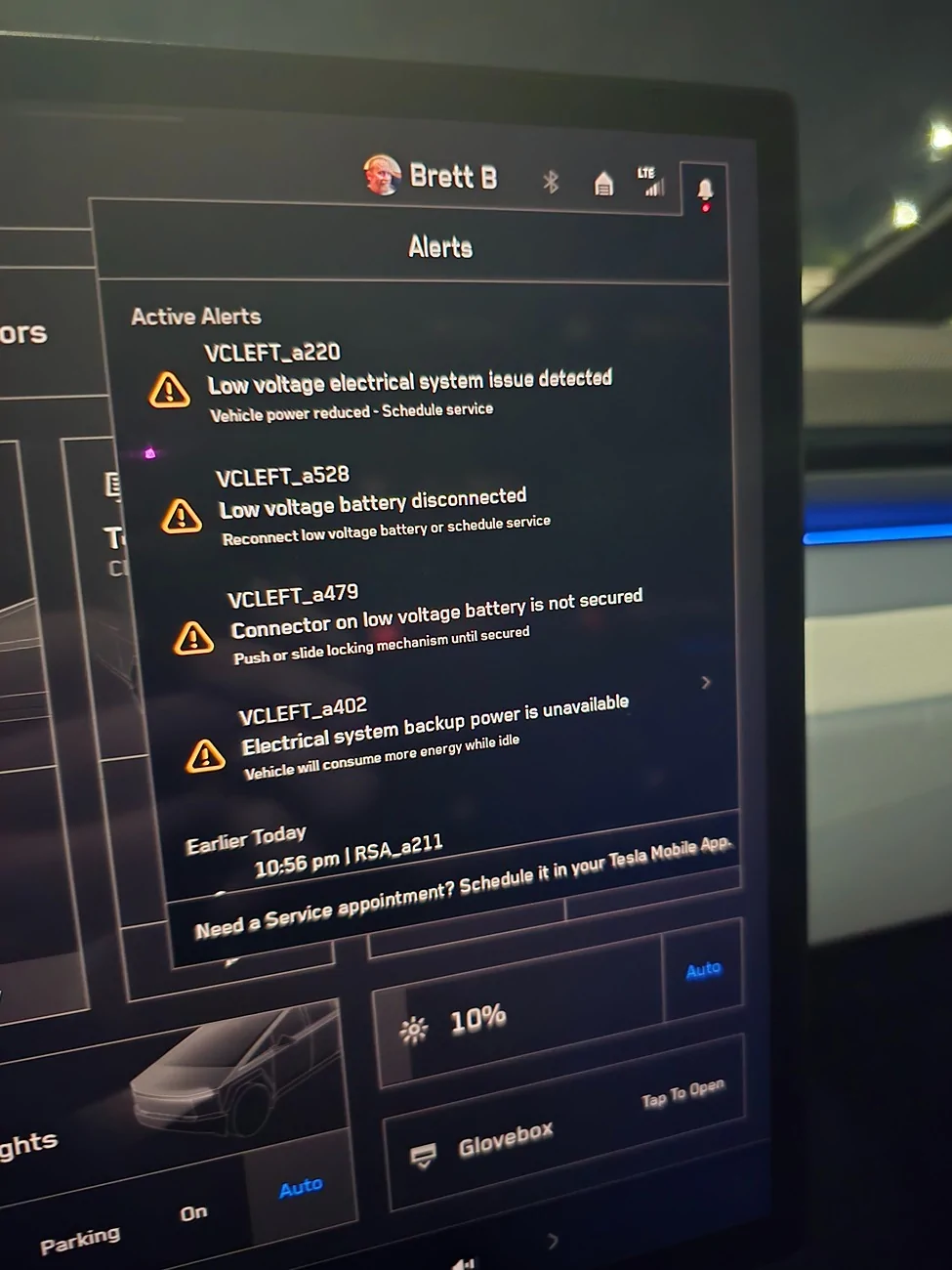

Ugh. Less than 2000 miles and I'm already having to call roadside assistance. First time ever left stranded by a tesla.

So far so good. Road side assistance was very helpful. My CT was towed to the local SC in Jacksonville. Sentry activity makes me think they are already looking at it. I will update this thread with new info as I get it. Hopefully it's only a faulty 48v battery.

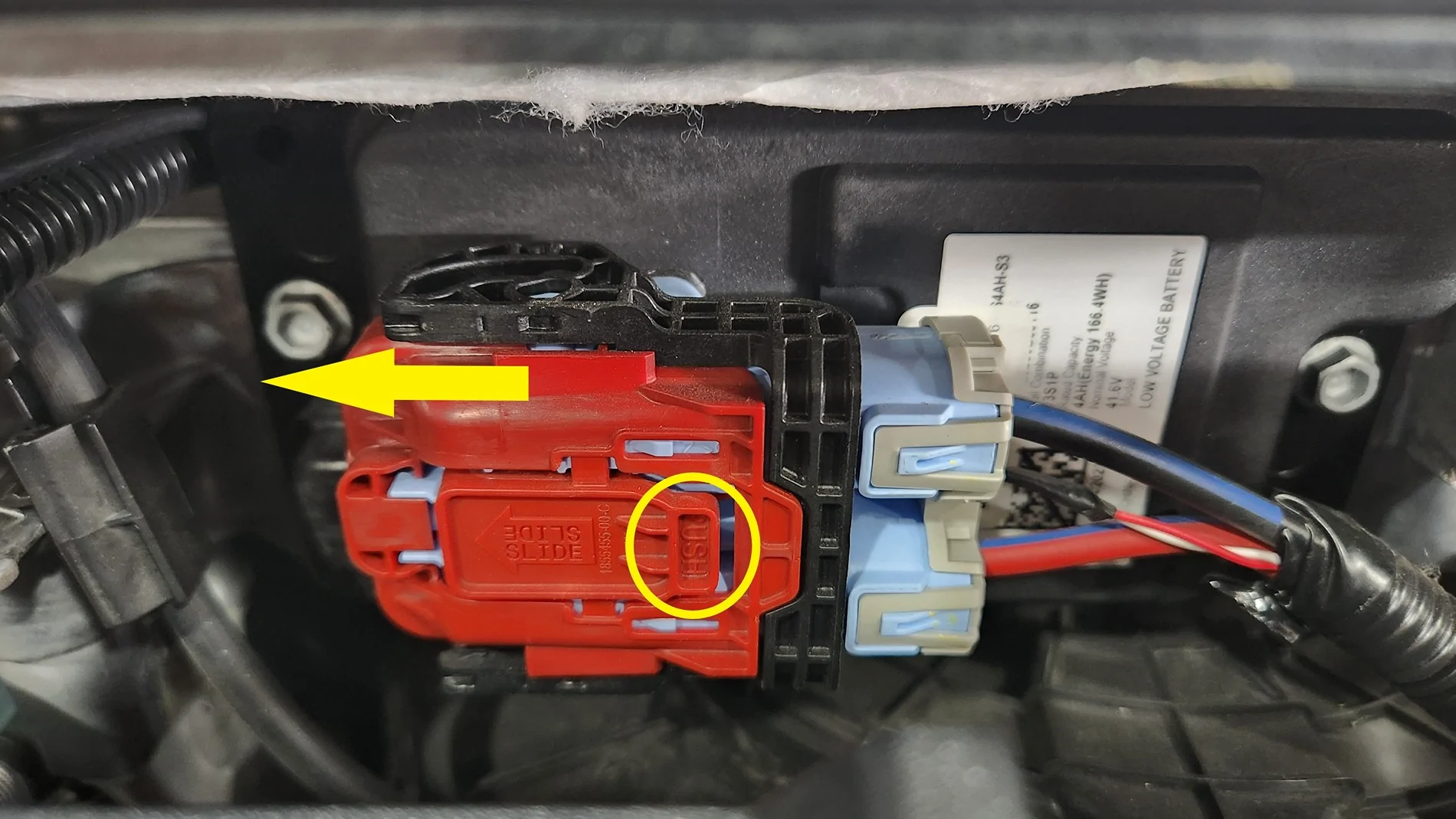

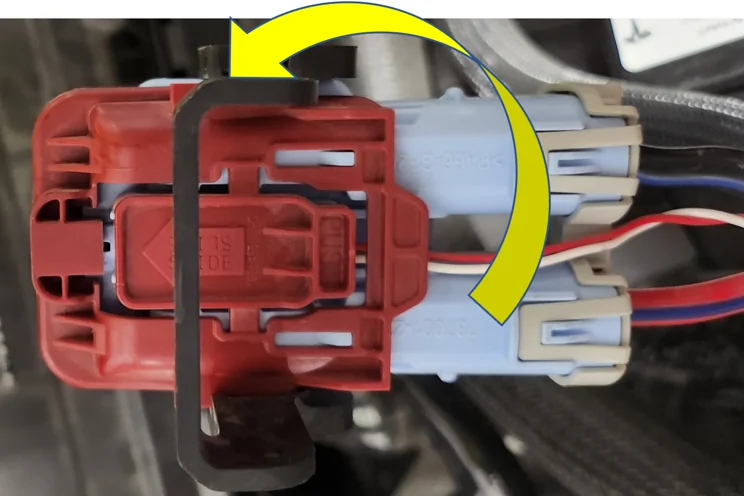

The red LV cable connector needs to be closed or locked via the black handle. Thats VCLEFT_a479.
Sometimes they keep this connector open on pre-delivery CT's. Its the equivalent to removing the 12v battery cables on all other tesla models. They forgot to close it. Closing the clip to the 48v battery is a 2-step process. Sometimes they only perform step 1 and then on delivery day - they perform step 2.
Step 1.
Tesla Cybertruck Fourth Day of Ownership 48v System Issue slide red forward
Step 2.
Tesla Cybertruck Fourth Day of Ownership 48v System Issue Push Handle down

Thanks for sharing this. I took a look last night and what i
They keep this connector open on all pre-delivery CT's. They forgot to close it. Closing the clip to the 48v battery is a 2-step process. Sometimes they only perform step 1 and then on delivery day - they perform step 2.
Step 1.
Step 2.
Strange to me is that this didn't happen on the first bump that you hit after delivery - and that you were able to drive for 4 days. You should have gotten this alert at the curb driving away from the service center. Thats weird.
Thanks for sharing this. I took a look last night. What i saw looked like picture 1. Makes me hopeful I will have my truck back soon!

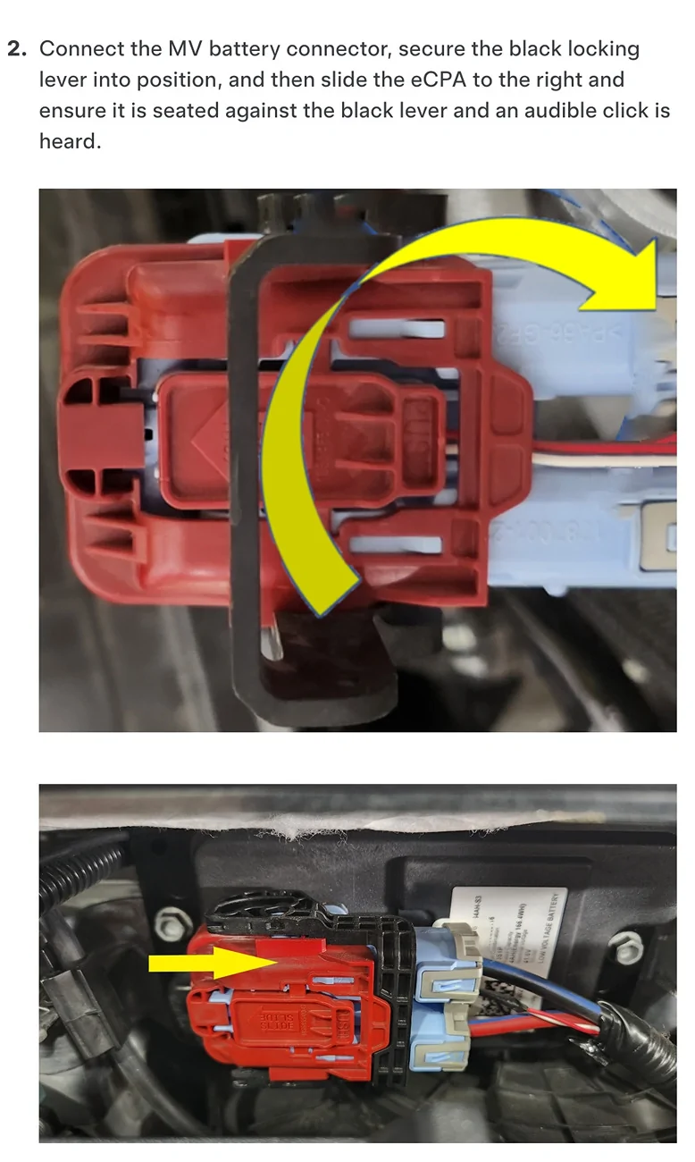

Black handle up is the unlocked position
This is the locking procedure
Tesla Cybertruck Fourth Day of Ownership 48v System Issue AISelect_20250919_094457_Firefox
It should have the black lever down.
https://service.tesla.com/docs/Cybe...UID-A399E8AE-5DCF-4095-91FA-AF0148503F3B.html
