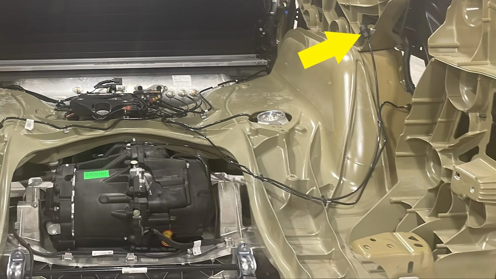

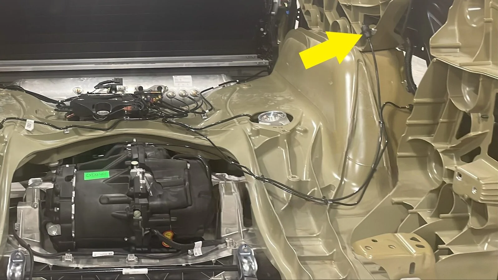

I've had my CTFS for 1.5 months, and it's been in the shop for 2 weeks, and I'm looking at another week. The front drive unit was replaced, and the air suspension was replaced once and possibly again. They just told me today that if you go through the car wash, water gets into the air suspension system. I said, what's the point of having car wash mode or fording through puddles and creeks in off-road mode if it loses air suspension just from getting a little water?
I've not gone off roading. What type of system did they design if a car wash leaks and crashes the air suspension? Stainless steel body with rice paper air suspension? AWD only with dry weather and zero puddles?
10,248
33,929
You went through a car wash? It's a miracle you weren't electrocuted! :rolleyes:
The air intake is under the bed floor, above the drive unit. There's a filter on the compressor that should resist water droplets, and you'd need to be practically floating before it got submersed. There's actually an "air inlet line" to the compressor, so I'm not exactly sure where the air intake resides. The fill port under the right-rear wheel is only for charging the reservoir tank with nitrogen.
If they've determined that the suspension system was damaged by water, then there is a malfunction somewhere. It is not something you did. The truck can get wet without breaking lol
May 27, 2024
4,531
5,512
Yeah, the intake snorkel is high up in the right sail area. Shouldn't get wet unless it's out of position or disconnected at the pump.
Huh. Youd think that would be something theyd point down toward the ground to prevent water from above.. or at least put some kind of water shield over.
