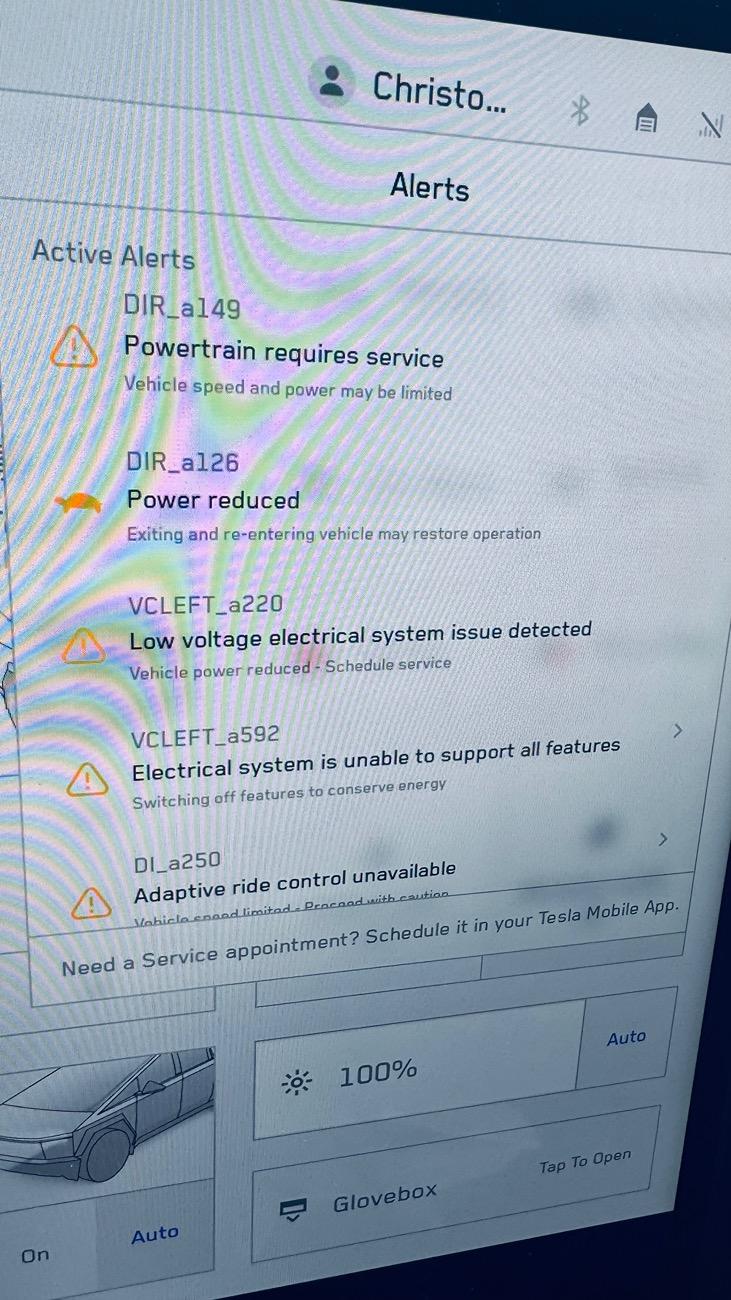

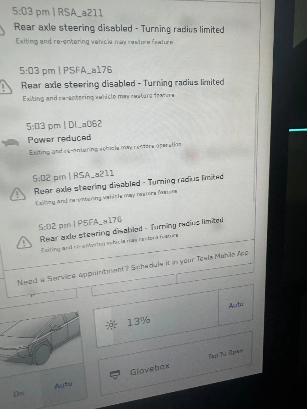

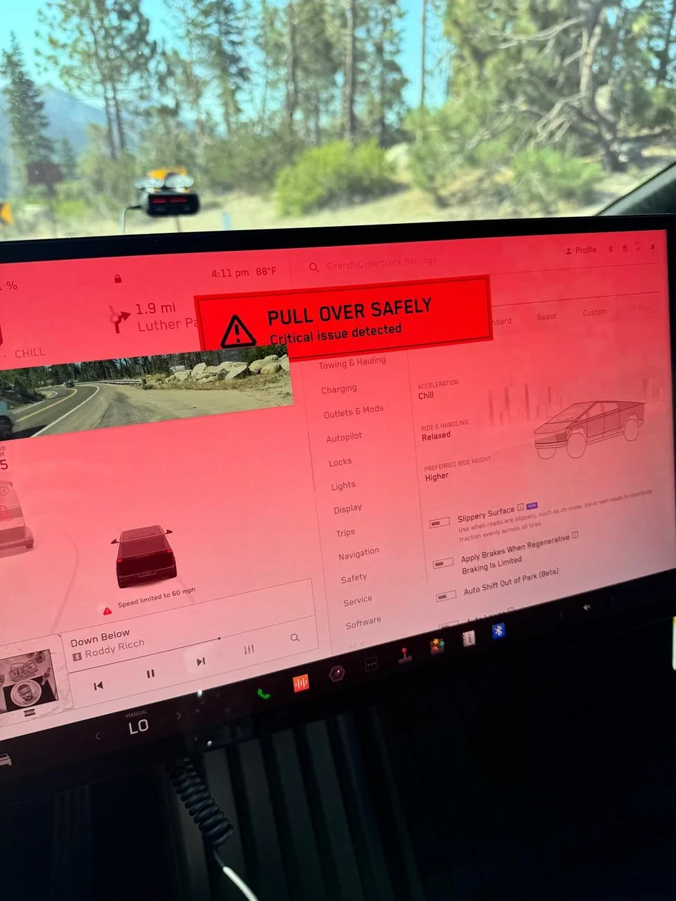

Broken at delivery: Critical Steering Issue Detected & Loss of System Redundancy Detected

Had the same warning with in the high 1700s.
Mine wasn't the harness, it was a rear motor oil pump (or so we hope). It also made the AC go out.
I'm supposed to get it back tomorrow, but they aren't sure.
interesting I am at 2,288mi but same story with the AC being out and also the screen was so hot I felt like I burned my finger.

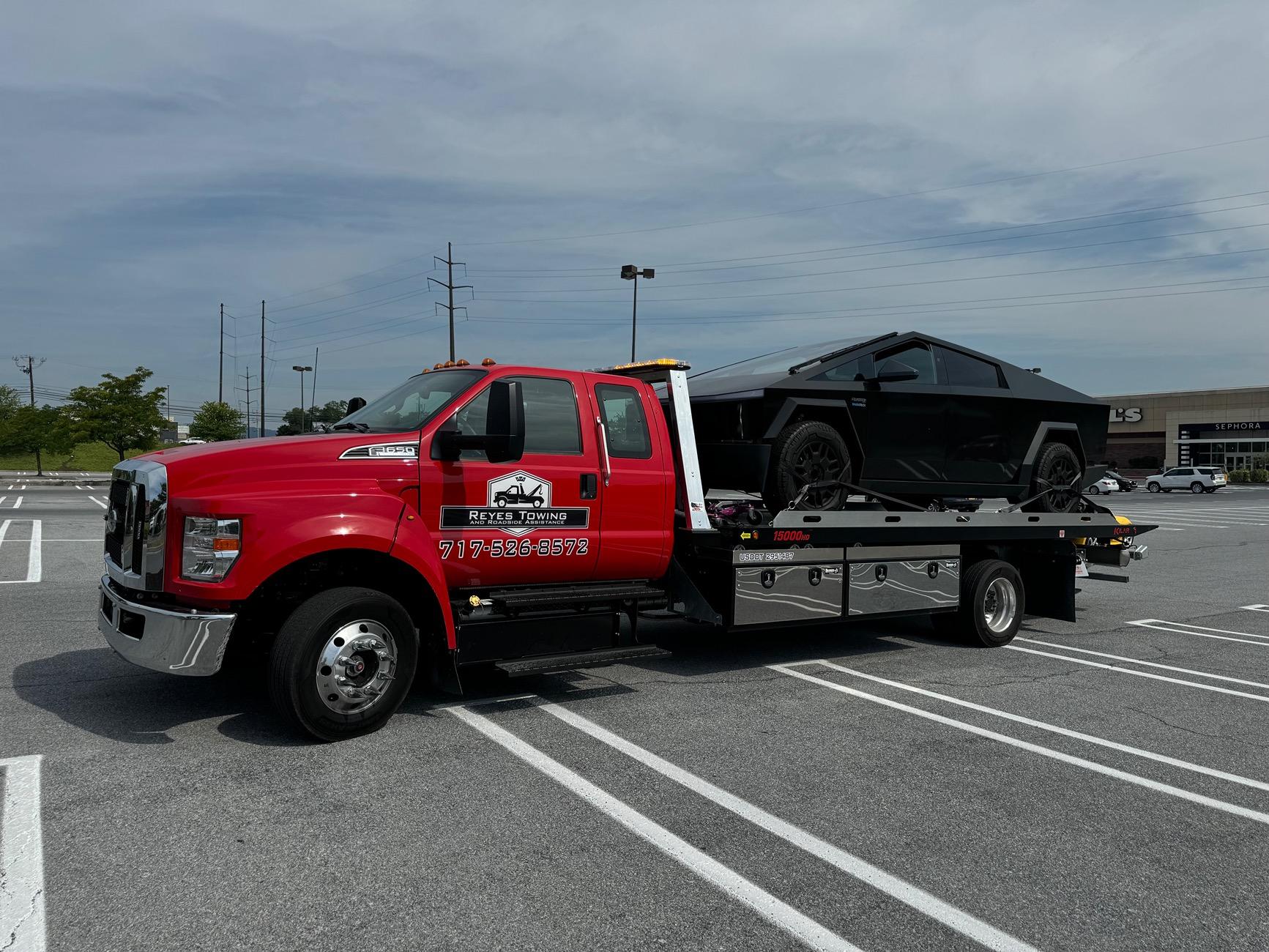

This looks exactly like the issue I had. Delivered 10pm on June 29, drove 44 miles, left it parked in my garage for 3 days due to a short trip, when I came back it wouldn't turn on.
https://www.cybertruckownersclub.co...l-not-start-power-on.12872/page-9#post-356614
I had to figure out by myself how to open the frunk and jump the battery, as Tesla refused to help me. Then I had to help the tow truck which had no idea how to load an EV on a flatbed. Even the process to put it on "towing" mode would work 1 on every 5 times I did the process and it would drain a jumper battery in 3 to 5 minutes every time I tried. It was a looooong 10 hour day yesterday to get that thing to the SC in Delray Beach.
And yes, it was delivered dirty, with battery at 75%, and missing the mobile charger, for which they are still giving the run around to get it.

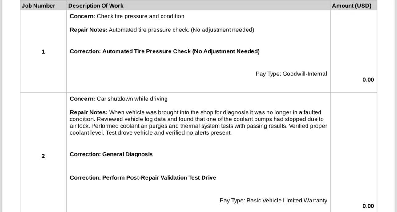

Result was air in ac compressor that failed the system causing shutdown to prevent fire
Tesla Cybertruck Broken at delivery: Critical Steering Issue Detected &  Loss of System Redundancy Detected IMG_1934
The Repair Note mentions air in the coolant system, rather than in an "ac compressor". I'm just clarifying this a bit for someone who might be quickly skimming the thread.
I'm sorry you had to suffer through the problem, but glad they found a clear fault and fixed it in a fairly reasonable length of time.
