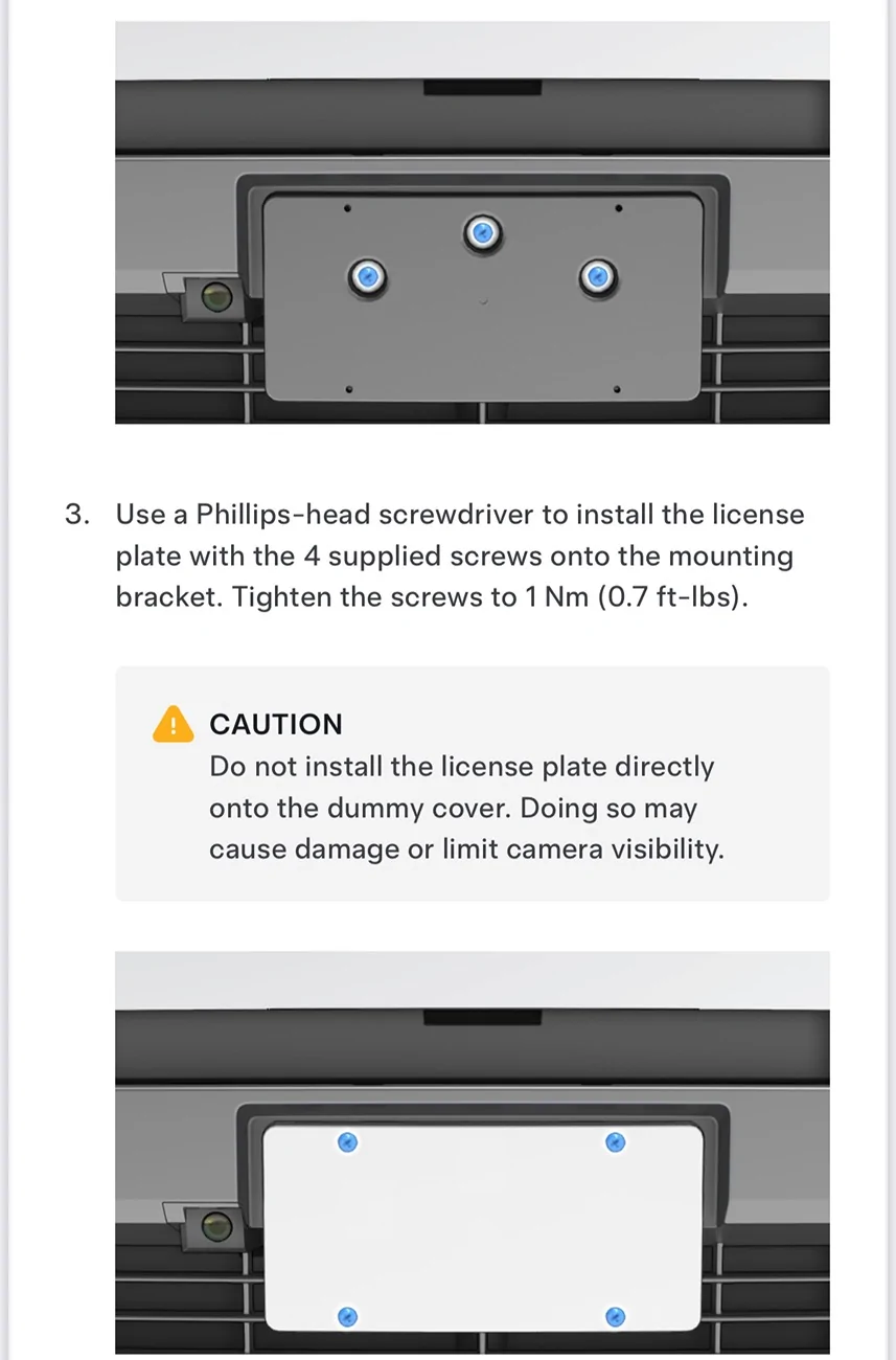

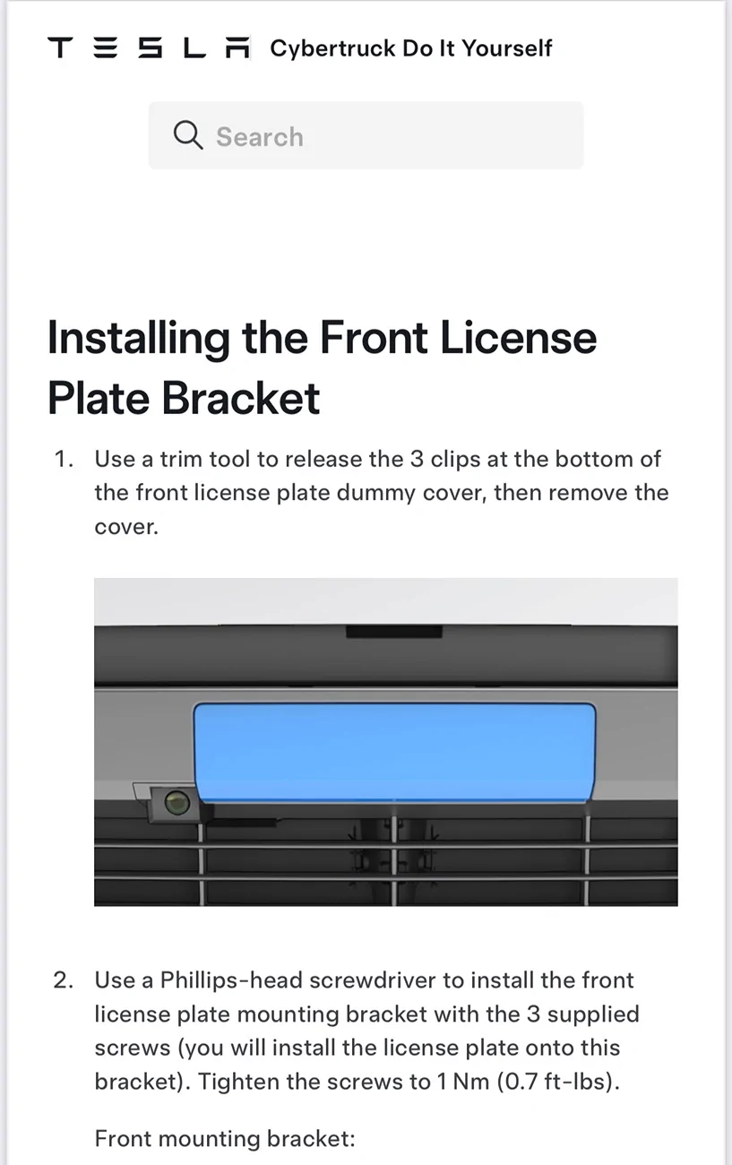

No problems with my front plate... Used the bracket Tesla provided.

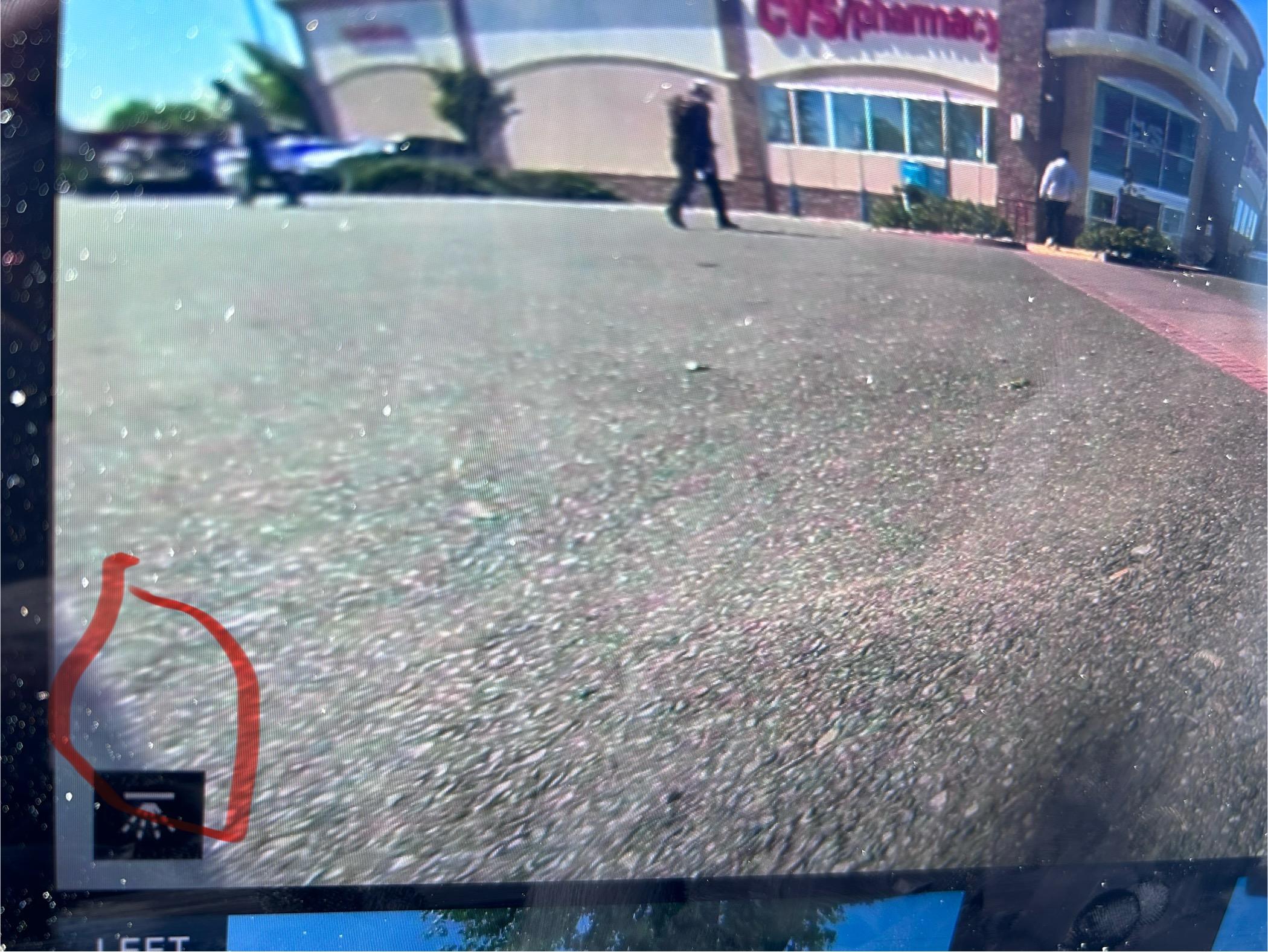

My camera is a little bit obscured by the license plate but just barely. When I first put it on I had a license plate frame that definitely cut off a big chunk. I removed the frame and used the adjustment in the screw mounting holes to slide the plate over as far away as possible from the camera. And now it's fine with just the slightest darkening in the corner if anyone knows to look for it.

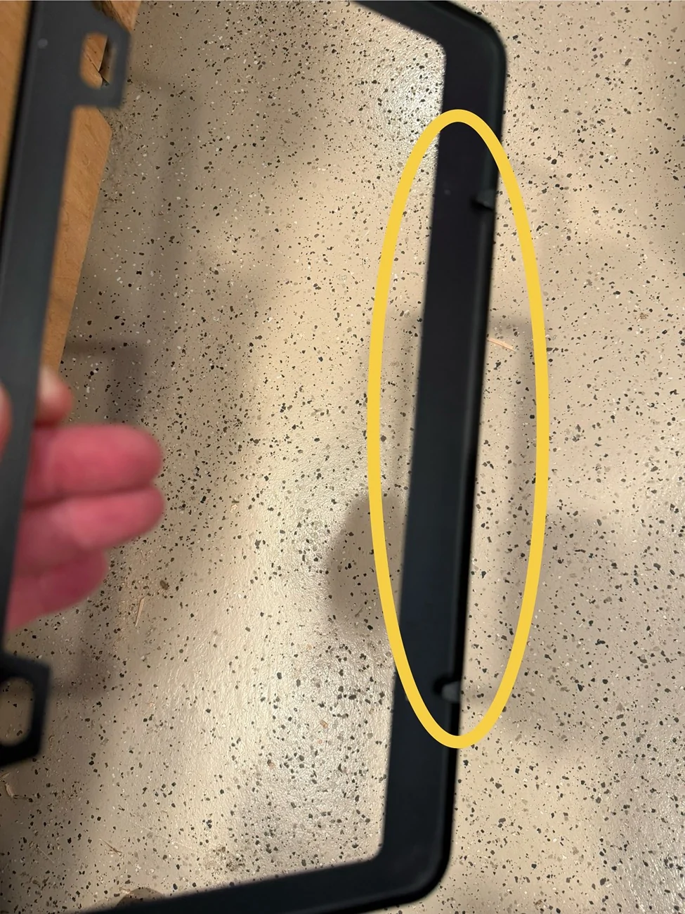

It’s less of a bracket issue more a frame issue. As I mentioned most frames are just held in by the top two screws and it doesn’t suck it back far enough onto the Tesla bracket to keep it clear of the camera. Anybody out there using a frame that has bottom screw holes that works? For now it’s just frameless and working fine with the Tesla bracket
