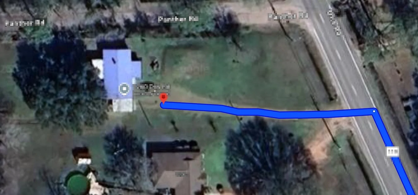

I've added my private driveway as a road but can't figure out how to do it as a parking lot. Google maps now shows my driveway as a road but my CT still won't turn down my driveway. It just stops on the main road in front of my driveway.

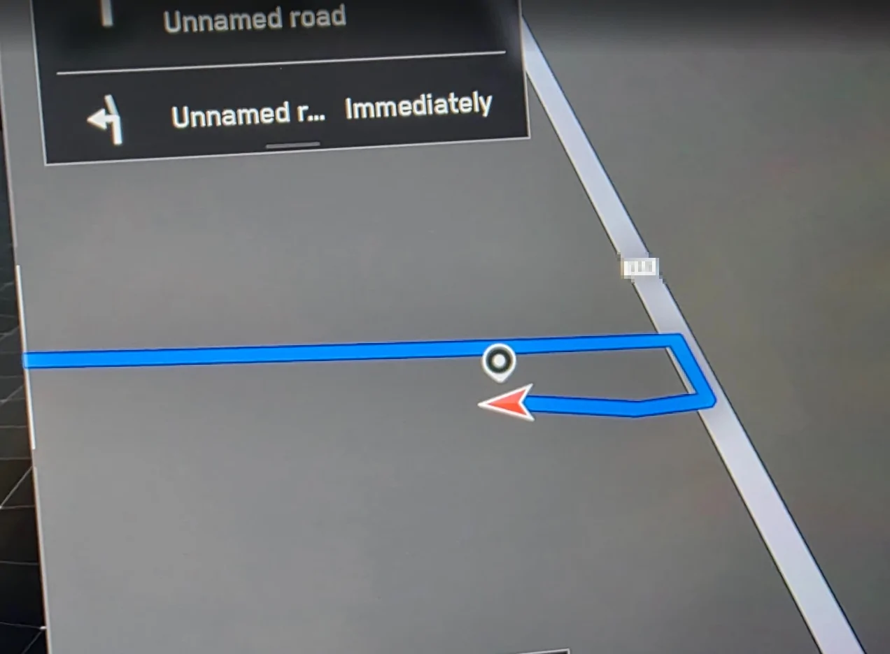

Looks like my CT nav has added my driveway to the map now. Tried it out in FSD on way home but it still won't turn down my driveway. It wants to still turn down the other road to the left past my driveway. I'll have to test now if my CT will allow to start FSD from my driveway and pull out to main road.

In the first picture it looks like your address is on the road going left to right instead of vertical. Maybe you can edit the entrance location

The navigation really doesn't like unnamed roads. Try giving it a name, like "Cybertruck Place" hahaha or even the same name as your street.

Here is another view of me returning home and CT slowed down but would not turn into my driveway and was going to turn left onto next dirt road instead. There is no access to my property from the dirt road going left to right. I added a name to my driveway to see if this will allow FSD to turn onto my driveway now. We'll see if that helps when I test it later.
