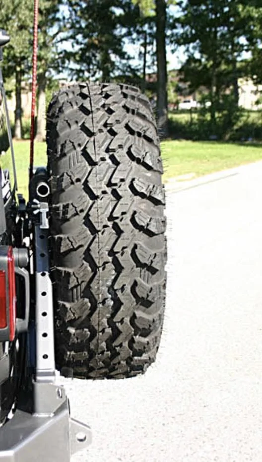

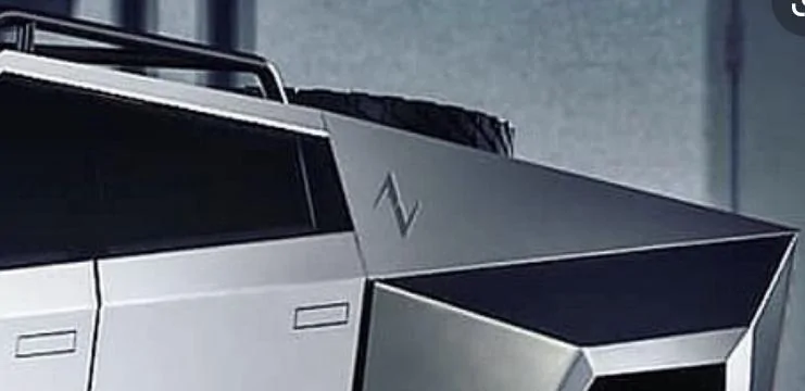

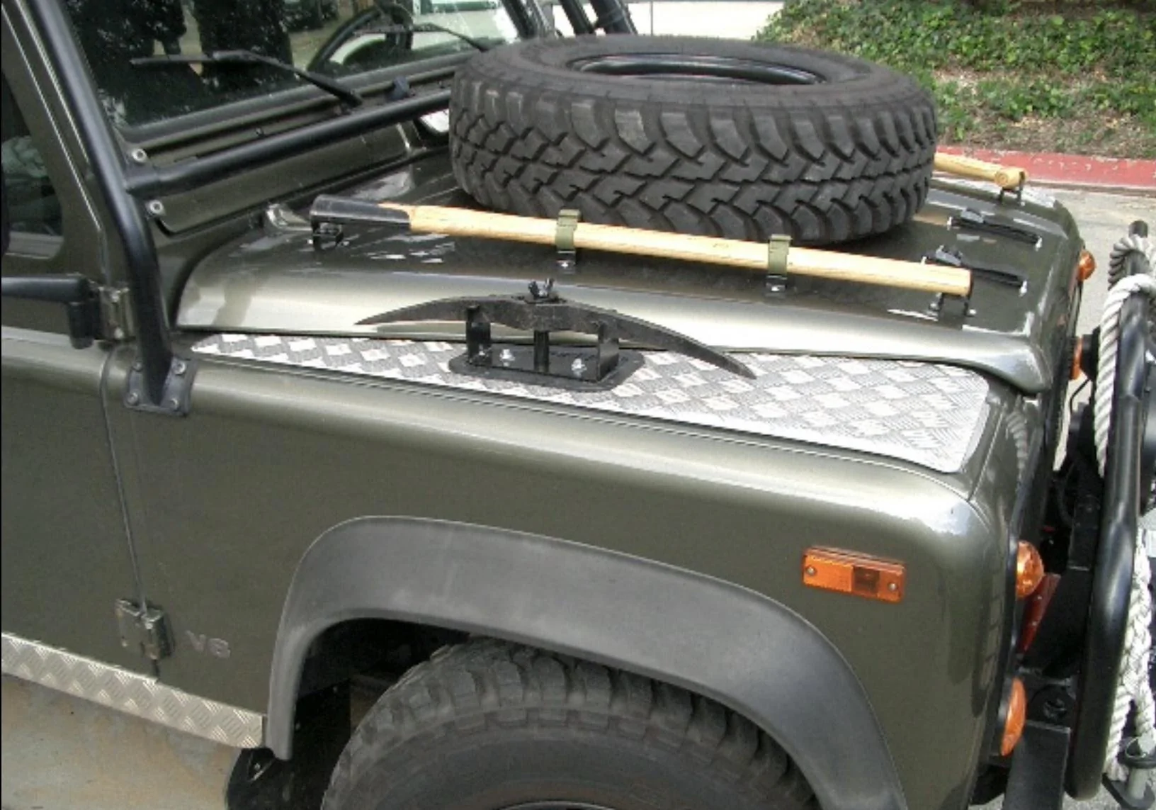

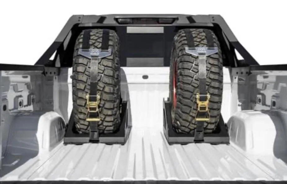

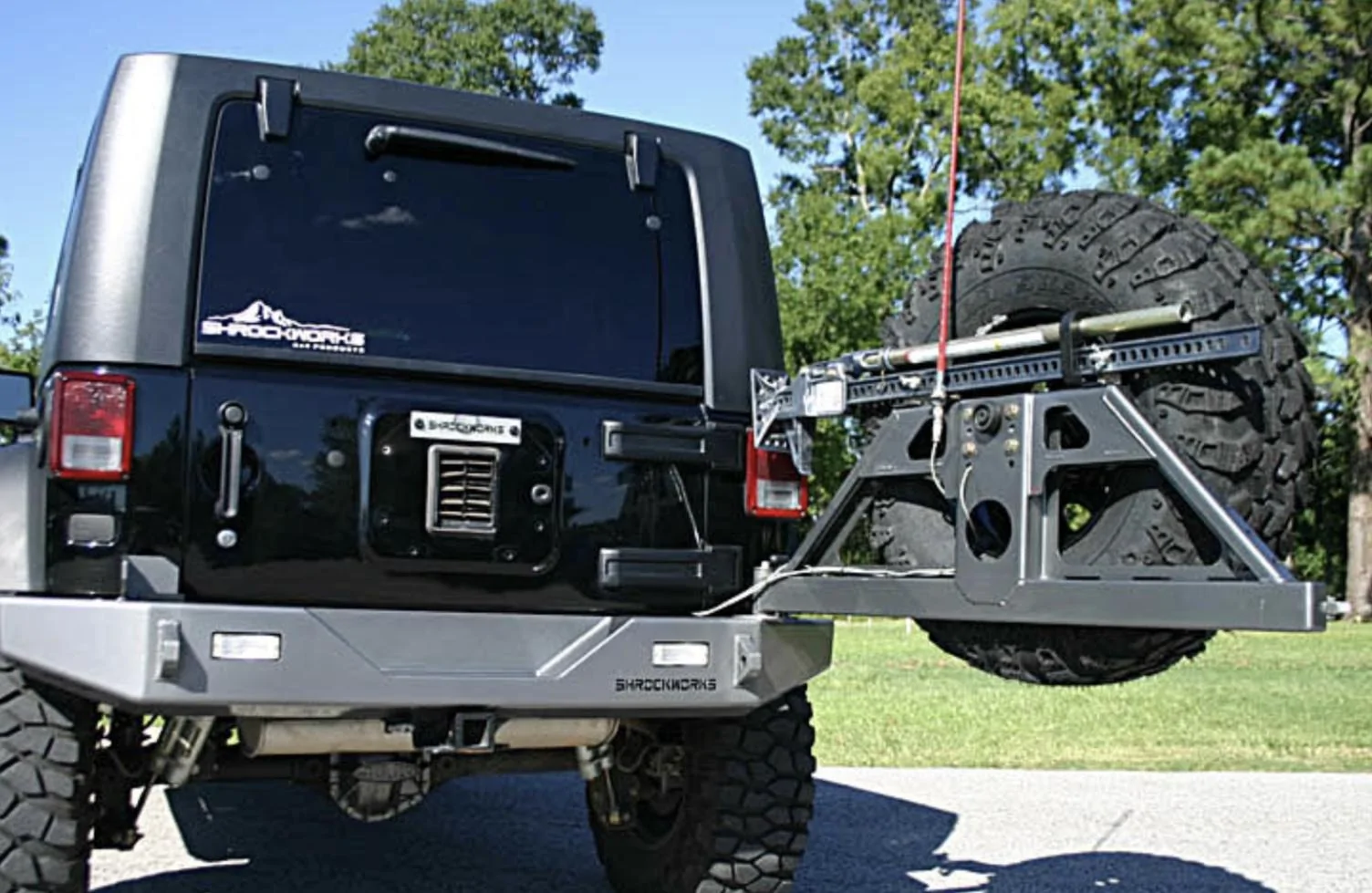

-The vault mount can be mounted flush to either/both sides of the vault easier because there is no wheel well hump inside the bed and the t-slots will definitely help. Best for traveling around town when you are not expecting to load up the vault as they would be difficult to get to without emptying your load.
-Exterior bumper mounts would have to be made at an angle to match the rear tailgate but would work well while expecting to use the vault as you could get to them while vault is loaded and to your load by swinging it out of the way. Disadvantage is when towing a trailer. As there is no engine air intake in the front, this model could also be used as a front bumper as well, or both!
-I don’t know if the runk lid has enough room, but another option that would not interfere with trailering or vault use.
-The angled bed rack mount is the last option, problematic if you want to use the entire vault area with the cover open

The only problem with the hitch mount is you reduce the tongue weight of the towed trailer. If you are not towing a trailer, then no problem.

I would not want my visibilty compromised with a tire & wheel on the front like that (plus the front of the cybertruck is not that large), but maybe a front bumper mount, much like the rear hitch mount? Something to think about.

I like the idea of vertical mount in the bed. I don’t know if the height of the tire is too much to close the tonneau for the CT. I just checked in my Ram 2500 and it would be close. My 35” spare just sits in the bed flat in my current truck because I have a tonneau and the under bed space is meant for smaller tire. I have to deflate the spare just to get it to fit under bed and it’s a super tight fit. It’s not a big deal because I have on board air but every time I have to rotate tires it’s a PITA so I take up like 1/3 of my bed space with that monster tire. In the CT with the sloped tonneau it might barely be enough space to have the tire loaded vertical without interfering with the cover. Also those tires on the CT I guarantee weigh close to 100 lbs. If they are 35x12.5 the tire alone is about 75 lbs plus the wheel weight which will be about 30 to 40 lbs. No way I want to be lifting it over the roof.
