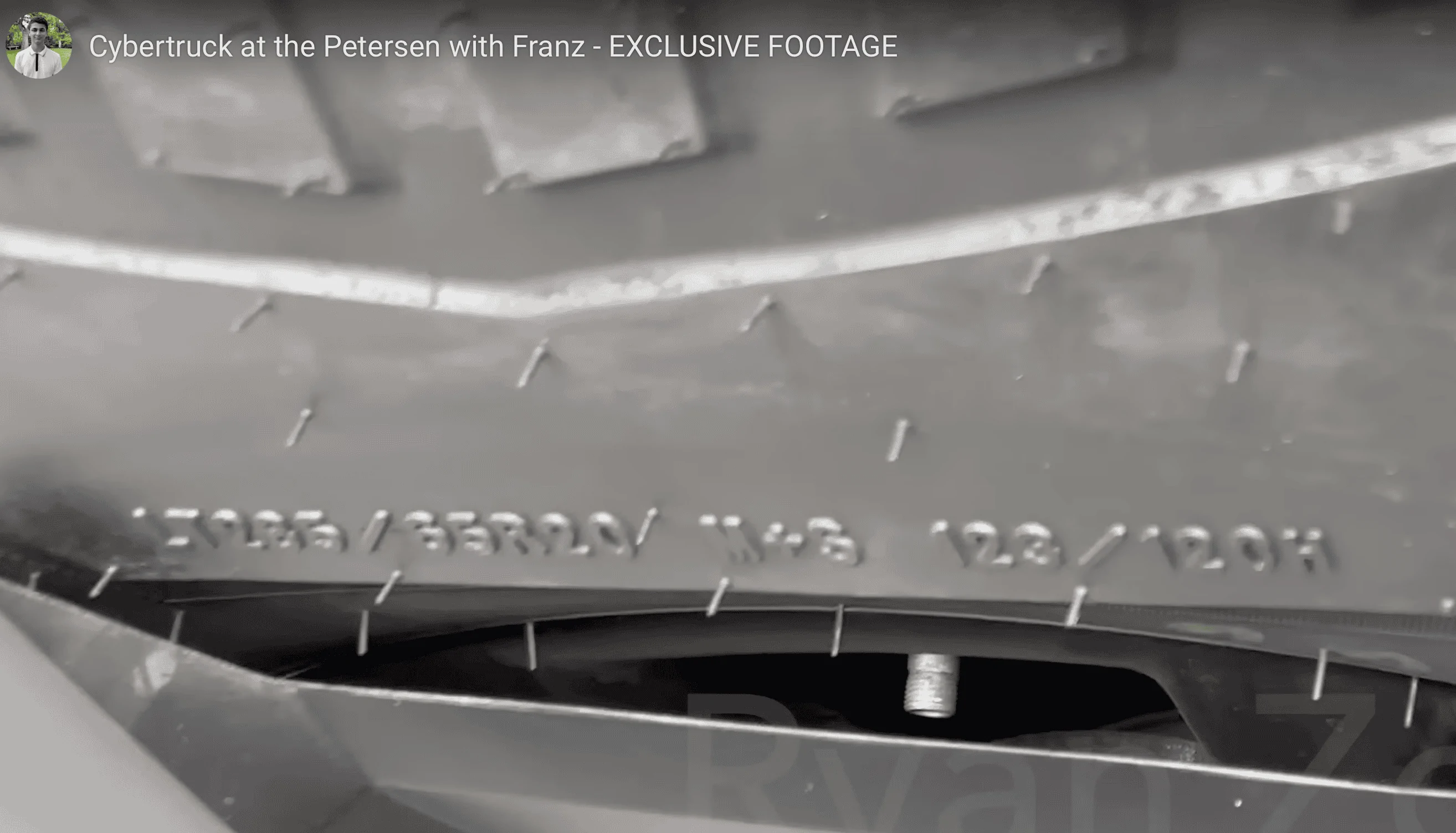

I grabbed a screenshot from another forum showing the CT at "Petersen with Franz." If this CT is at least close to production release the reported Stock tire size: 285/65/20 is what the CT at Petersen had. The screenshot includes additional tire information, including the Goodyear name.
Tesla Cybertruck Tire size? Screenshot 2023-07-20 at 8.47.32 AM

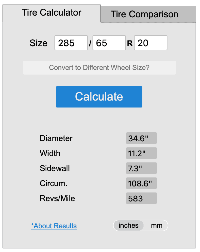

A calculator to add to your tire height statement. I like the sidewall height. I don't understand why people get very low profile tires with all the garbage roads in the USA. I'd rather not blow out my tires or break my rims the first time I drive on city streets and hit a hole.
Tesla Cybertruck Tire size? Screenshot 2023-07-20 at 11.47.12 AM

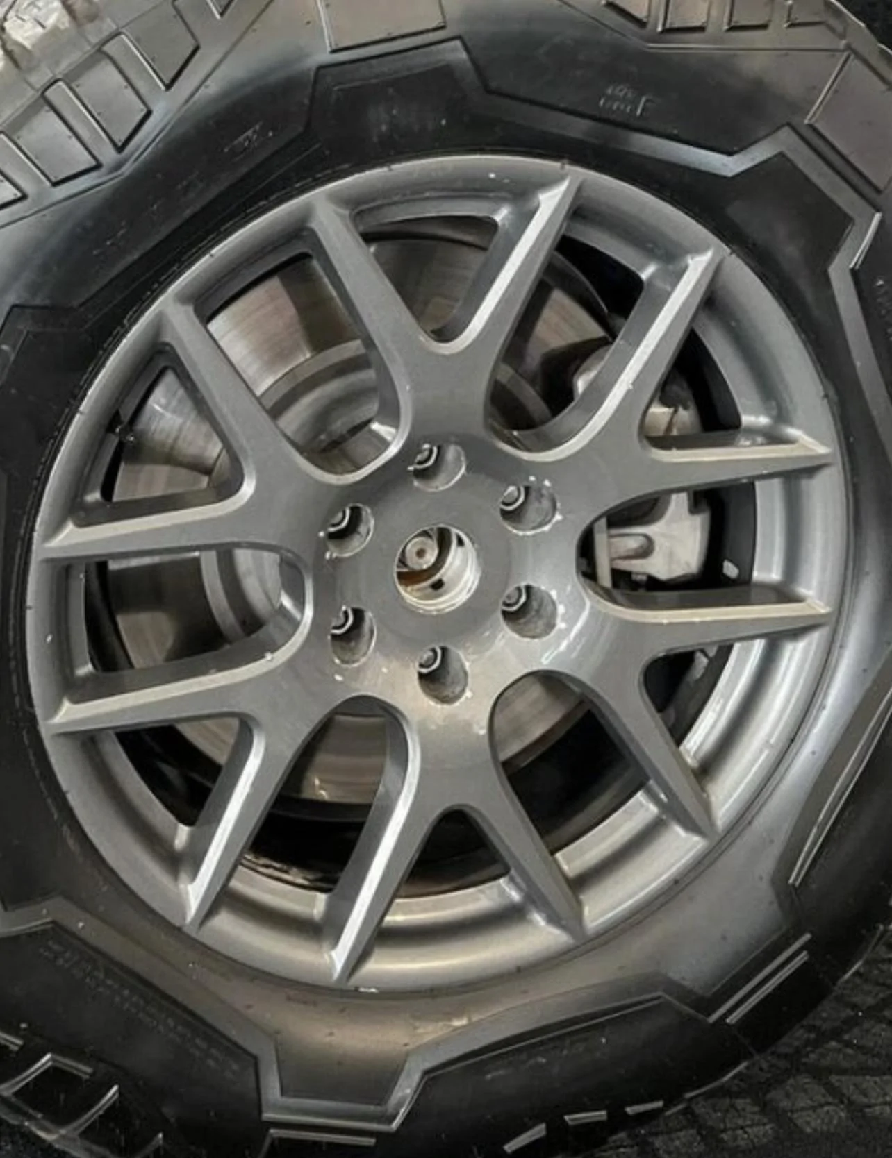

That will depend on the brake caliper clearance required to mount the wheel. I think 18" will be tight on the CT.
given the weight and performance/safety aspirations (in braking) I could imagine Tesla seeking, this makes sense a lot of to me
And squares with appearances - this caliper does not appear to have the 1” to spare
Tesla Cybertruck Tire size? 40E3BA61-F170-460C-AFD0-506919289C80

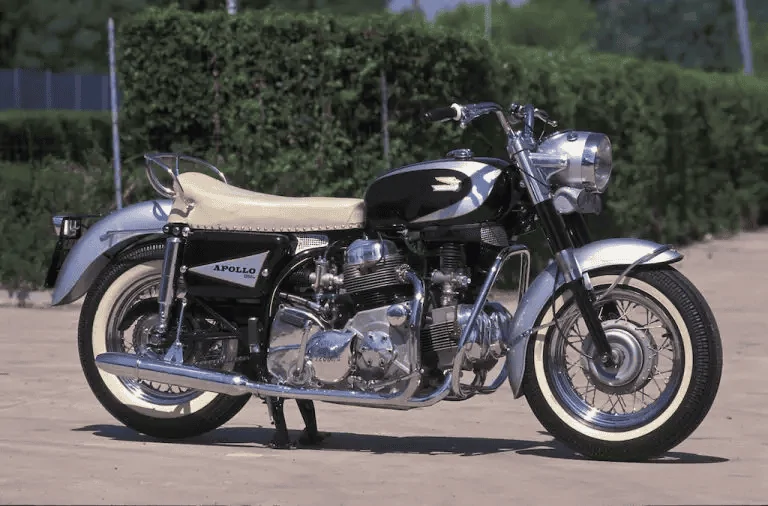

It reminds me of one of the rarest and most valuable motorcycles in the world, the 1964 Ducati Apollo V4, only two prototypes were built, and it was never put into production because there were no suitable motorcycle tires that could handle the prodigious torque produced by the huge (for the day) 1260 cc V4 engine. Sure, Ducati could have waited for tire companies to design special tires for the application, but the price (and delay) would have been problematic. Using the most suitable tires available, the prototypes would rip the tires right off the rim, and, in one case, the rejected tire carcass wrapped around the test rider's neck. Not pretty.
