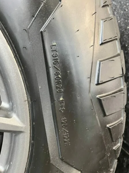

315-60-20 aka 35inch tire and 12.5" wide, LT 8 ply rated on 20 inch rim. 6 bolt pattern..... Goodyear, M&S rated, see attached photo... I'll probably get some Ford Raptor or RAM REBEL Off Road 20" 6bolt pattern mags & tires vs. Tesla rims...

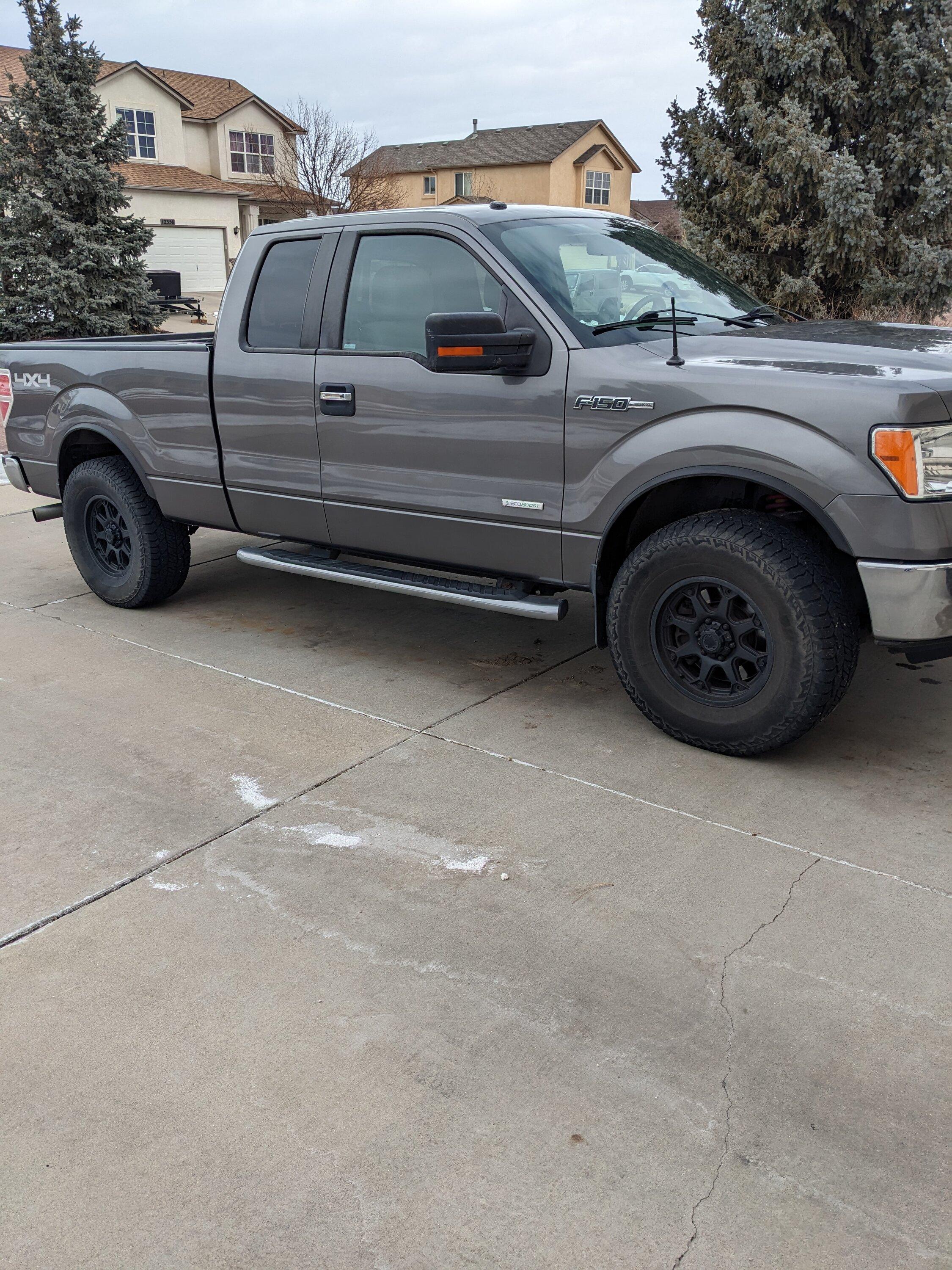

35 x 12.5 tires on 17" rims. Truck is leveled but not lifted.

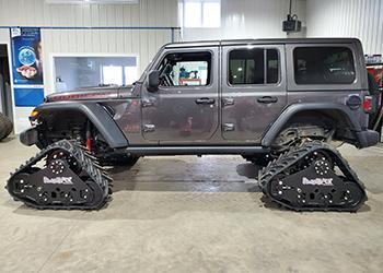

I'm getting the "CyberTires"
Check out the youtube channel by "Casey LaDelle" who does car/truck rescue (tow truck type things) in the snow. Just about the only way to drive on non-plowed , heavy snow roads. Not great gas mileage but would be interesting on a multi-motor CT.
Leveling typically means the front end has been lifted. Doing this is pretty much the same thing as saying, "my truck is meant to drive around empty most of the time".
Cybertrucks will probably be self-levelling to adjust for different loads.
What are you on about?
Leveling kits became popular after federal laws on max bumper height were enacted - manufactures began having to rake truck noses downward to comply
prior to those laws, trucks came “leveled”
and since leveling kits are up front, hey have almost zero effect on truck payload/towing
(Aero is another matter)

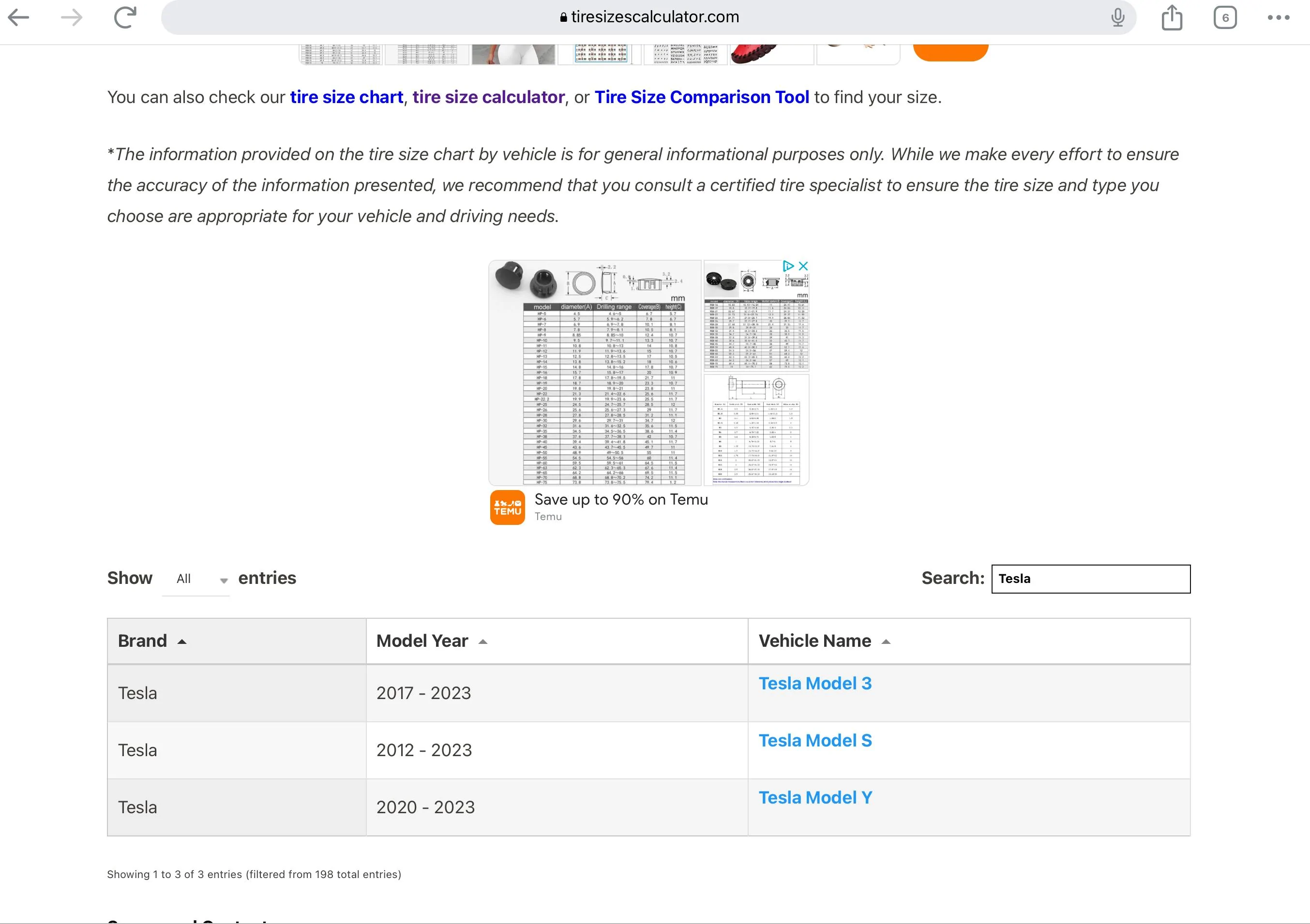

I haven't personally gotten close enough to check the tire size, but have you tried looking up the make and model of the vehicle? Sometimes you can find the exact tire size that's recommended for it online. It might also be worth taking a peek at the owner's manual if you have access to it. In terms of finding the perfect tire size for your own vehicle, I recently stumbled upon a handy tool called TireSizesCalculator.com. It's a simple website that lets you input your vehicle's make, model, and year, and it spits out the tire sizes that are recommended for it.
NADA.

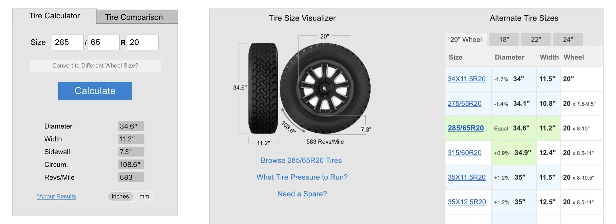

Stock tire size: 285/65/20
