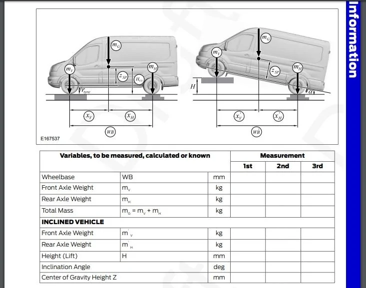

Ford Transit CoG (center-of-gravity) calculation chart
Tesla Cybertruck Gas prices transit-cog-1-jpg
Ford Pickup Trucks
Ford Pickup Truck Consumer Information Sheet in glovebox of truck has Option weights and center-of-gravity information.
Ford Pickup Trucks
