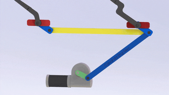

I suppose a bi-directional motor with some type of controller/sensor setup would be possible when there is no need for linkage between two separate blades.
However, a linkage does allow the reversal to happen quite simply and reliably, even with a single blade.
The fact that it's being used on a flat piece of glass changes a lot of things. It might turn out the the BAW is a lot quieter than other wipers because the hold-down force can be spread very evenly across the entire contact surface. You can have just-barely-enough hold-down force, no need to compensate for curved glass by using too strong a spring.

During the heaviest rain, that thing will have to be moving at 1000MPH. And it's heavy.
Assuming that the highest wiper speed is one full sweep (and back) per second, covering 4 linear feet each direction, the speed works out to around 5 MPH.
When it's flying one direction, then slams to a stop and moves back in the opposite direction, the gears will push themselves out of alignment.
That's not how wipers work. The motor/gears turn in only 1 direction. Oscillation is provided by the linkage armatures.

There are much larger wipers on buses and semi trucks. I have no worries about the BAW.

Yeah, I knew I was getting into the weeds there, what do you think about the quietness? as there should be no spots where the blade is squeezed too hard against the glass, like on a curved glass surface.
