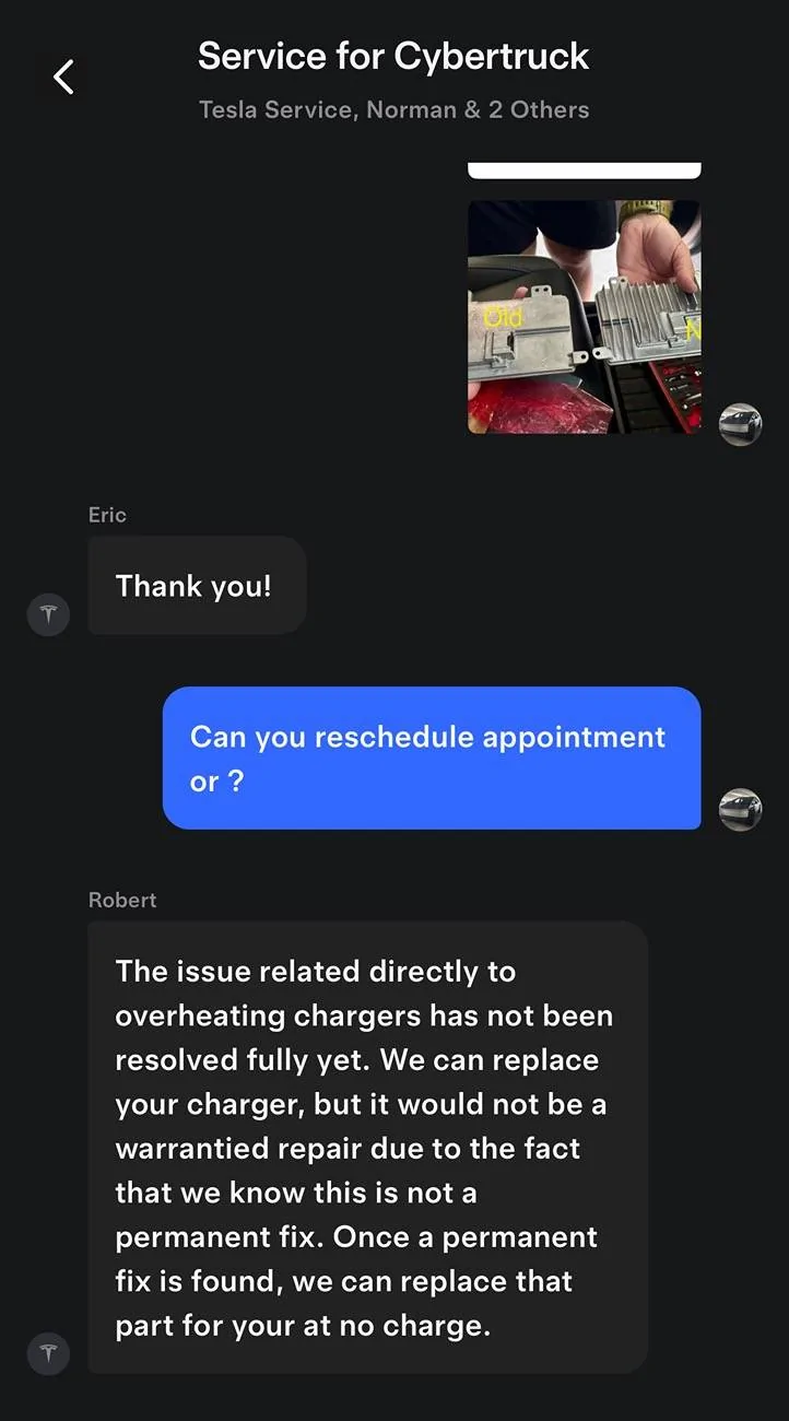

Based on input from other members (who just had this done), it didn’t help, so kinda depressing actually. The fix, is apparently, not legit.

Tesla canceled my appointment. Stating they don’t have a fix at this moment. I added a screenshot of their reply.
Tesla Cybertruck HARDWARE FIX for hot phone charging issue! New wireless charger has a built-in heatsink IMG_3571
