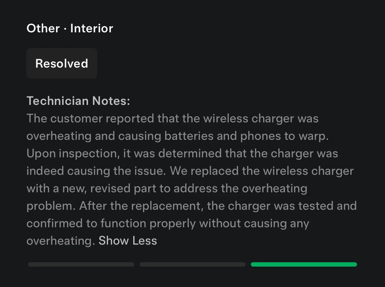

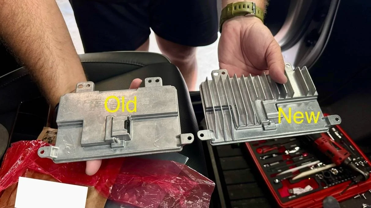

Had my charger replaced under warranty for the new part today. Provided the part number courtesy of this thread. They gave me zero grief about it.
Tesla Cybertruck HARDWARE FIX for hot phone charging issue! New wireless charger has a built-in heatsink IMG_5492

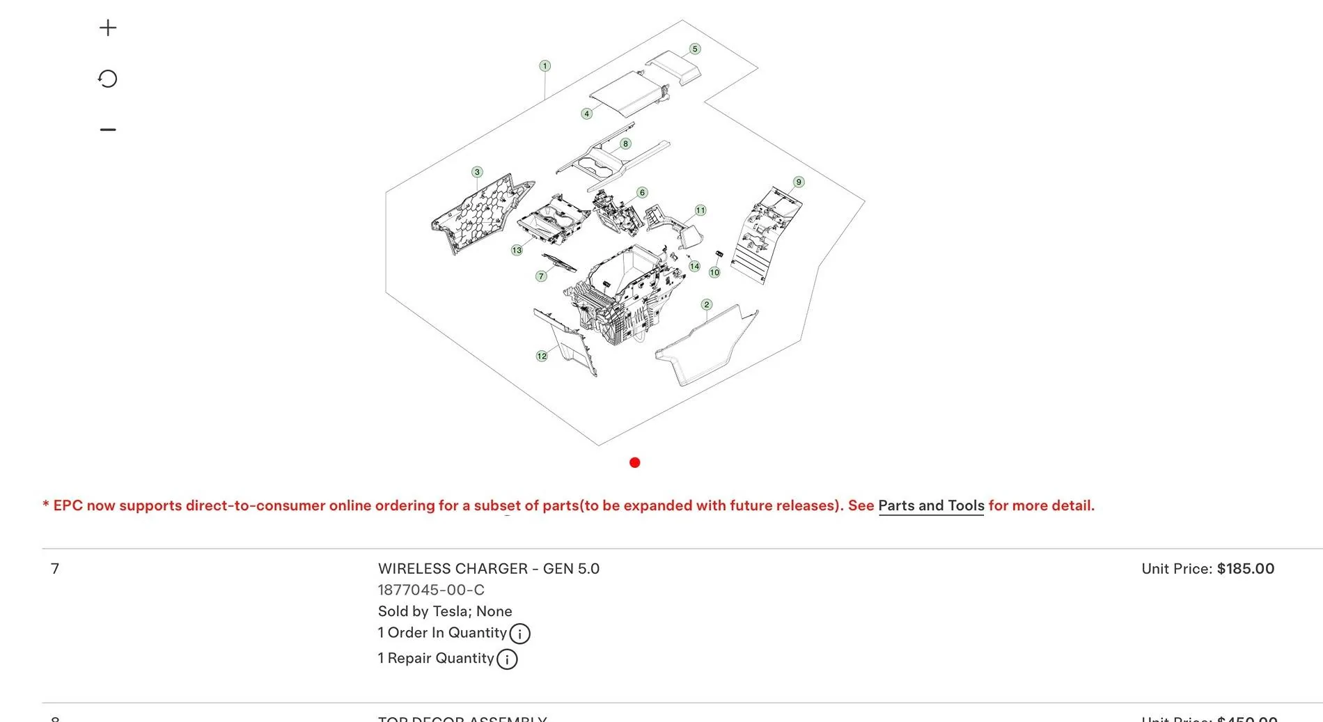

I just submitted a service request and have a Mobile Service appointment for 06/27. Will report back any information.
ETA: The EPC lists the charger part as up to Gen 5 now.
I included this part number in my service request.

Had my charger replaced today. He showed me the old one and it had the heat sinks built in. My truck was a late foundation series with gray interior. He said they replaced the part as some of them are faulty, but the new part number being showed in this thread is the same charger my truck already had in it that overheated my phone. I have not had time to test it yet, but I will report back with any changes in charging. Thought it was interesting that I already had the new part number in my truck and it was not working.

I’m assuming the ‘early’ builds had the non-heatsink version. Seeing that they’re on Gen 5, it’s apparent that Tesla knew this was an issue and has been working on a fix.
