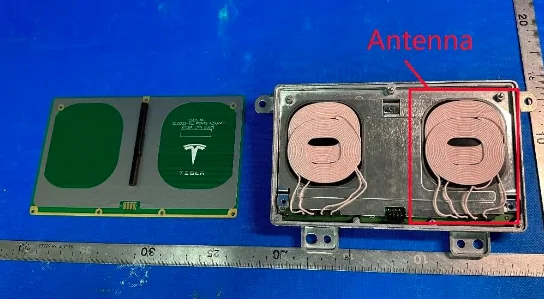

I found this site with technical details about the Wireless Charger:
https://device.report/manual/12220530
It includes links to other documents, such as test reports. That got me what I really wanted: photos of the guts!
Tesla Cybertruck HARDWARE FIX for hot phone charging issue! New wireless charger has a built-in heatsink Screenshot 2025-09-18 at 11.52.41 AM
Seems like there are only 2 overlapping coils per phone, aligned to the outside edge. The iPhone seems to have its coil right in the center, so I'll try to determine how these coils line up.

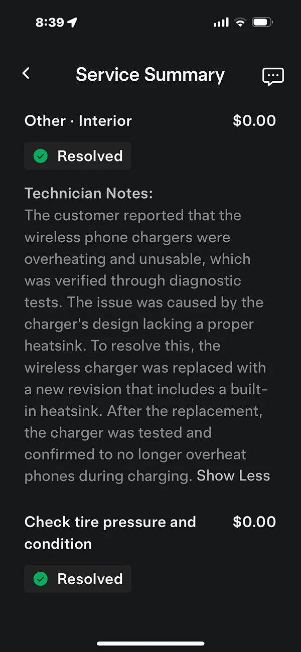

Here’s my update. I went to the SC for my Terrestrial Armor Install and added this to the service. They changed it out to the latest revision with no questions asked. They actually diagnosed it as not working too. It definitely is working now.
I have an IPhone 16 ProMax in a MagSafe case, it always overheated, never charged. The newer part seems to have fixed it for me. It now continues to charge, it has not overheated (yet). It does charge very slow, but is actually charging now, so I’m taking that as a win. I also have an aftermarket silicone charger insert (had this since nearly new, and it had overheated with this too). With this, and the phone case, it is charging and has not shut down for over heating. Fingers crossed for now, but so far, so good at least for me with this new part change. See screen shot from the Tesla app on the repair.
