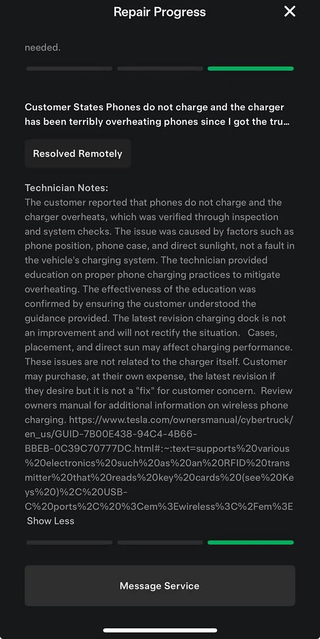

this is the BS response I see while my truck is in the shop. I don’t even have a phone case, know how to place a phone down, and it happens even in the night during the winter. Why did they stop replacing them? Is it really just an IPhone problem?

I have an update. I asked for the updated wireless charger at Yorba Linda California Service Center and was told, by Jesus via app text, the charger has to be inoperable. I said I never use it because the phone (iPhone 15) overheats and it never gains percentage points anyway. I admitted it does show a lightning bolt when it's in the charger. He said no, so I asked for a price in case I want to buy it myself. We FS risk takers get no respect. They find a poorly designed part, fix it, and don't offer it to the OG owners in the 100k club LIKE THEY SHOULD.

took mine in and this was the reasoning they gave for not replacing:
Concern: Customer states: Other · Interior - wireless charger overheats phone when charging.phone has overheating alert. requesting replacement part 1877045-00-C to see if that fixes the issue.
Repair Notes: The customer reported that the wireless charger was causing their phone to overheat and display an overheating alert. We conducted a thorough diagnosis but were unable to
replicate the issue. No repairs were made as the problem could not be verified during our inspection. Customer mentioned the revised part number for the inductive dock but the heat efficiency improvement is marginal and is not recommended to replace based on concern. If customer insists of replacement the replacement will be customer pay as this is not an upgrade to the inductive dock
what actually seemed to helped me the most was getting the windshield and other windows tinted. (I also have a silicone mat). since I did that I got much less overheat alerts.
kinda lame but there you go (I have a 2025 awd)
