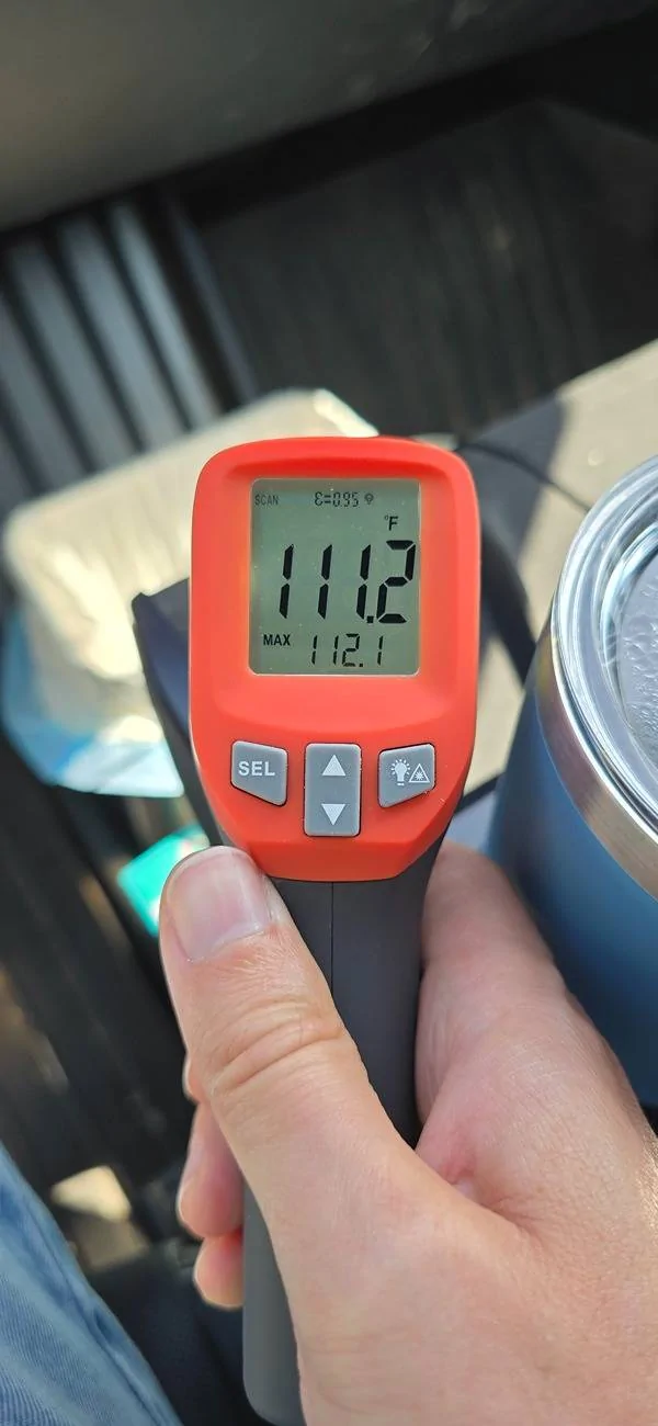

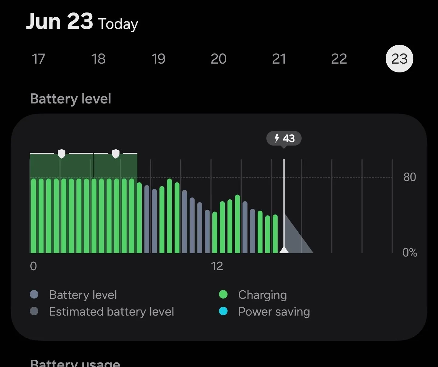

I just tested charging on my hour drive home and for the first time I noticed my phone never actually increased in percentage. Started at 45 and ended an hour drive at 43. Temp gun shows my phone and pad at like 112 F, but what surprised me more is it didn't actually charge. And I had reset my phone just before starting this drive.

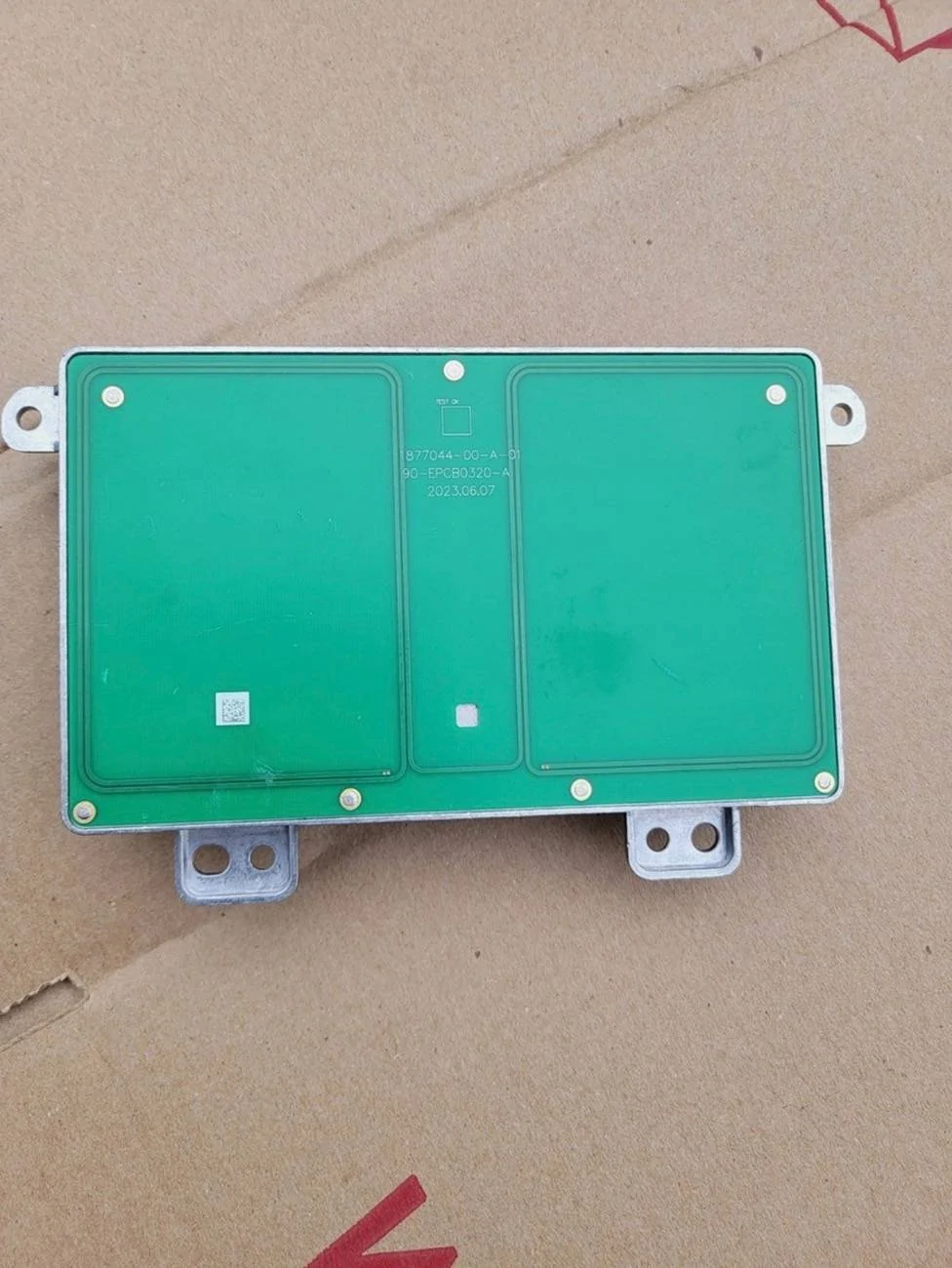

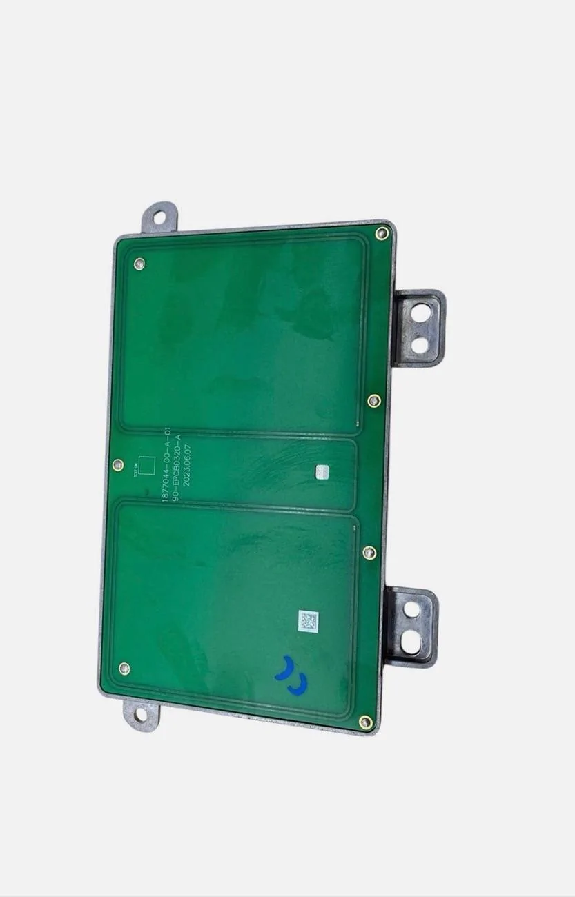

The coil design for the old part is the same. So presumably the only difference is the heat sink.
I now realize in the new part image above that the PCB part number still says iteration A despite the heat sink part marked iteration C.

In the middle of the heat dome, but my phone hasn't charged at all since the swap. Nothing massive, if any differences.

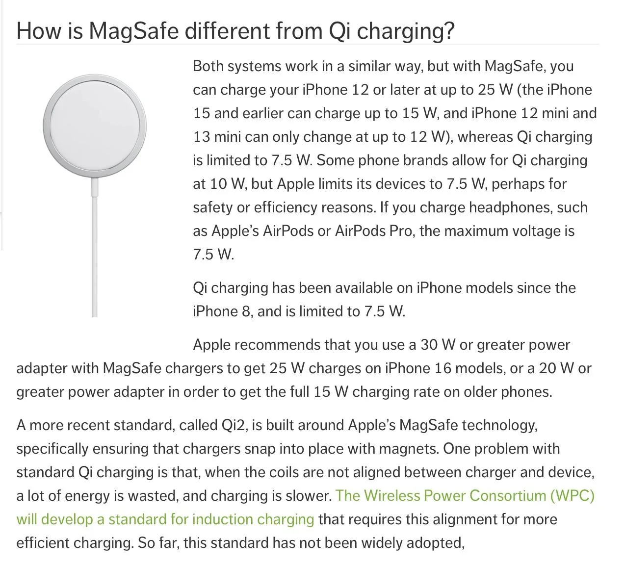

I'm sure it is phone model dependent because both of our Samsung phones have always charged quickly and with no more heat that we see at home with our wireless chargers (just warm, not hot). I have a case on my Samsung, but it is relatively thin. I'm sure the thickness of any phone case being used is a factor too.
I was under the impression the heat was being generated in the iPhone, not in the charger, so I'm not sure how heatsink fins on the charger is going to fix a phone that gets hot! I think it has more to do with the alignment and distance of the inductive coils.
Our home wireless chargers are "puck" style, and they are smaller than the phones they charge so the phone can be centered on the puck. Vehicles move so they must hold the phone captive (but not all phones are the same dimensions). I think this is where the alignment problem comes from.
Maybe the new charger has multiple coils inside, with different positioning, so the charger can sense the best coil position to use, ie, the coil with the best alignment to the phone being used. The phone industry should have standardized coil positioning with respect to the bottom and side of the phone, instead they required users to center their phones on the pads manually.
Apple developed a MagSafe centering solution, unfortunately they made it a proprietary solution requiring royalties instead of donating the MagSafe standard to the industry at no charge like Tesla did with the North American Charging Standard (NACS). Walled gardens are only good for the "King" who owns the walled garden, not the customers who buy the products.
