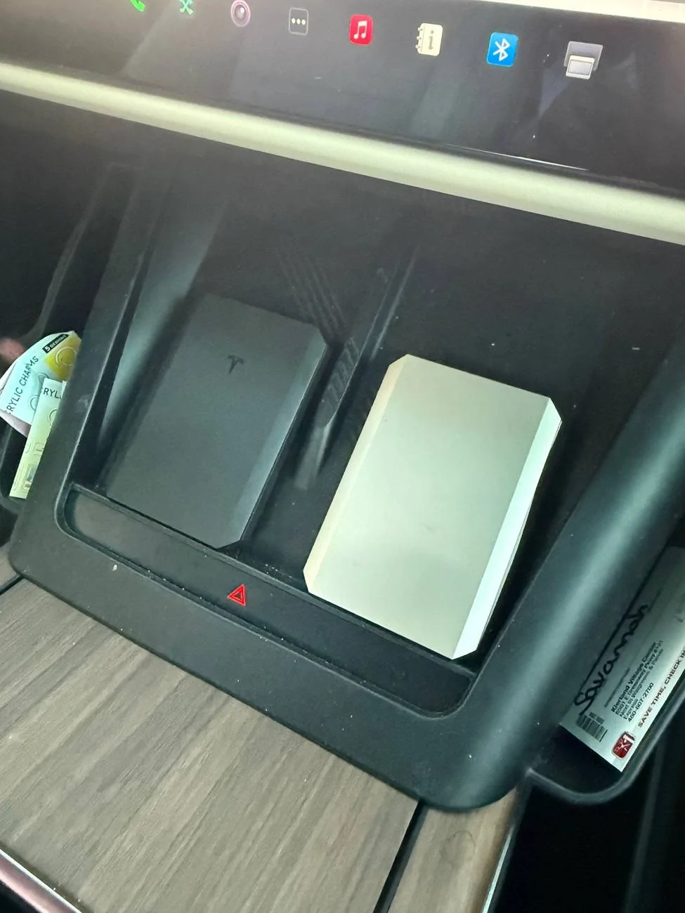

So I previously had the car in with this problem so this wasn’t the first interaction.

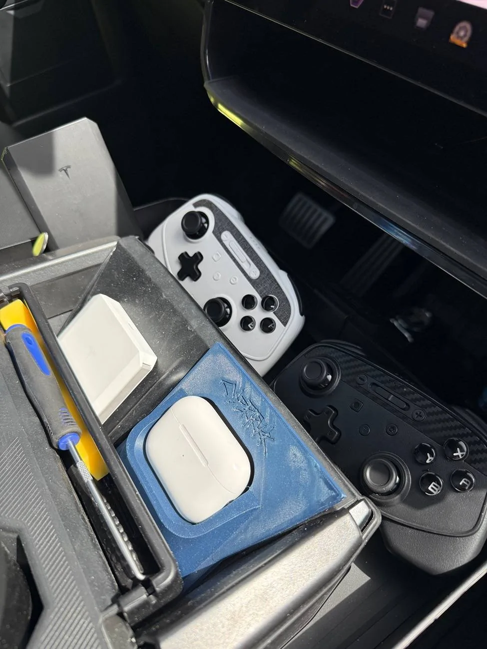

I use the Tesla wireless batteries in both our cars on the charge pads. They both charge and can be charged wirelessly which is pretty convenient. They are handy for when you leave the car without a lot of charge because they just MagSafe into your phone. They also have nice little tilt for setting up miss Rachel or cocolmelon in a restaurant. When you’re done with them you just throw them back on the charge pad in the car and they charge relatively slowly until the next time you need them. Mindless. Sometimes I have the Jowua wireless controllers on there too but they seem to handle the heat ok.
Anyway, the Cybertruck warped one of the Tesla batteries and I took it to Tesla. They came back with “within spec” and made me call the Tesla shop which sent me a new one. That one also warped.
So today, when I saw the post, I sent a picture of the second warped battery. They tried to schedule this as a mobile appointment and since I wasn’t that enthused about having another mobile tech give me a tour of the low voltage system, I sent a message with the part number and they immediately responded with thank you and changed the appointment to a SC appointment with a loaner.
do you have the STL for the airpod alignment thing?
