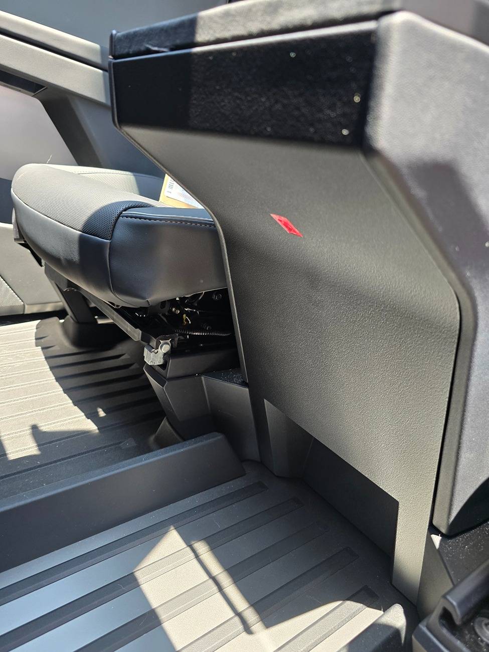

Which LED light did you replace?
All of the interior ones. I I wanted to be able to change the color to match the ambient lighting. The one I was speaking up specifically. You have to pull that panel off to get to the light. So that exposes the charger back where I may be able to put some heat sink.

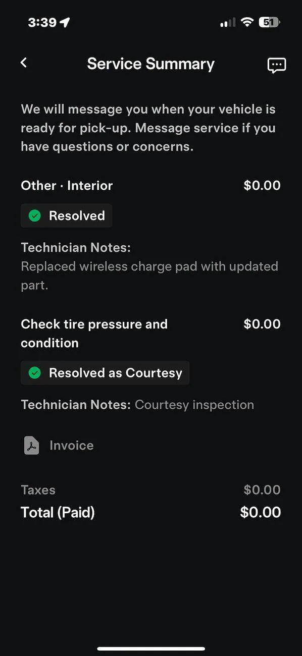

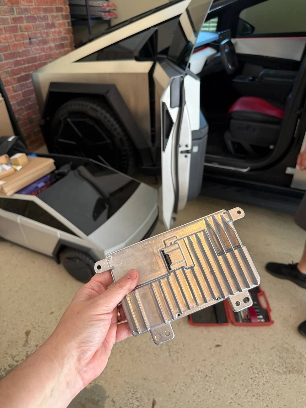

Tesla mobile service just showed up to replace my phone heater (May '24) with the new heat sink enabled version, I'll report back if it has any effect with an iPhone 16 Pro Max. Before replacement, my phone would overheat within 20 minutes.

Let us know if it fixes it for you, many reporting there is no difference.
My fingers are crossed for you!
Already reported this previously, but there is no noticeable change. My main concern was the fact that it barely charges the phone and that is still the case and yes, it does heat up so really no change whatsoever. My guess is the coils aren’t close to lining up on a iPhone 16 Pro which is designed for MagSafe, which has perfect alignment and does a really bad job with Qi charging.

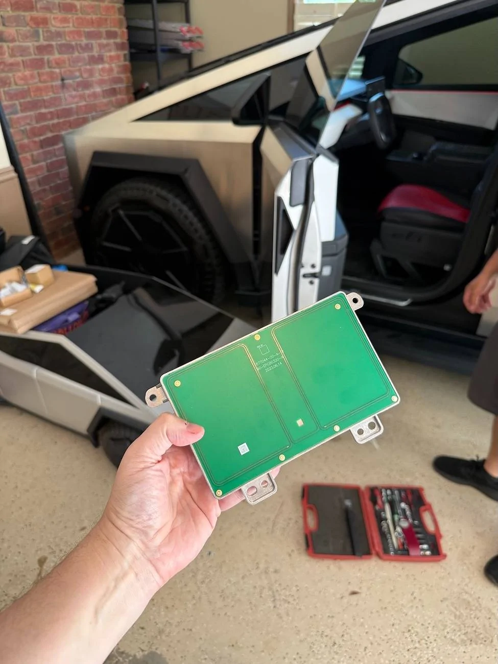

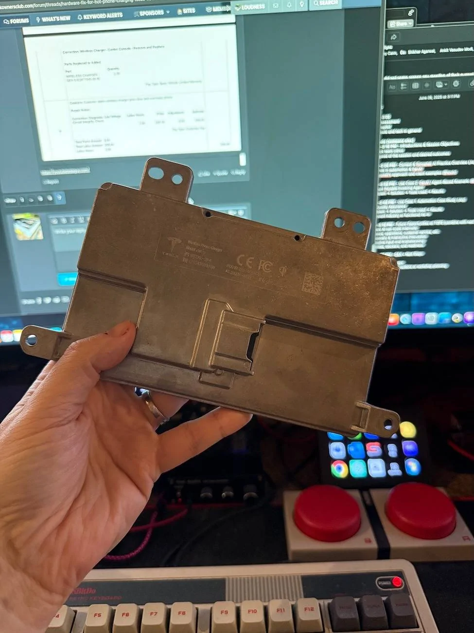

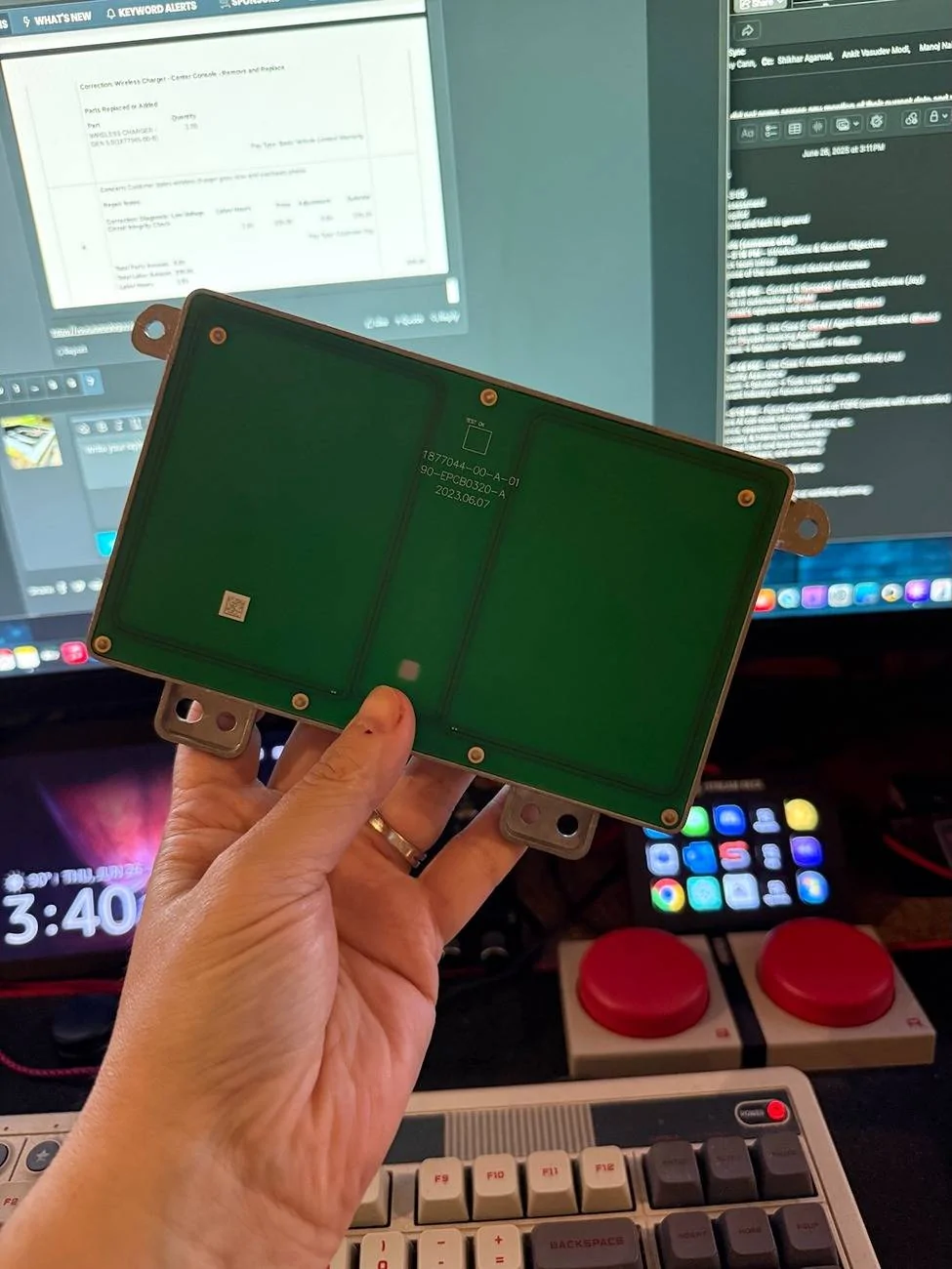

UPDATE: Replacement done, super easy fix. Service was free and completed in my garage. This is the old part, as with earlier pics from others, the most visible change is the addition of heat sink fins.
