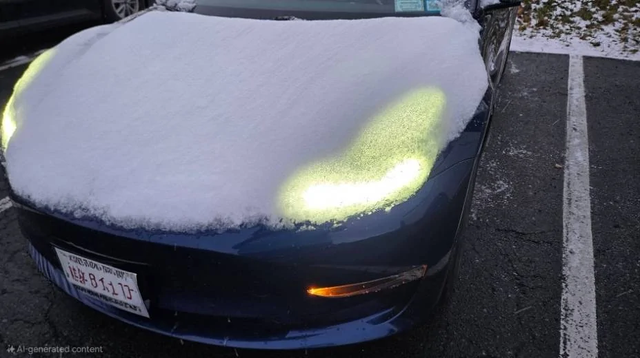

My Model 3 when I reached my destination tonight. Live in Central New York. So driving in snow is a normal thing for us. Maybe a recall of the Model 3 LOL.

This photo looks like it's AI generated, even the Japanese plates is out of place.
