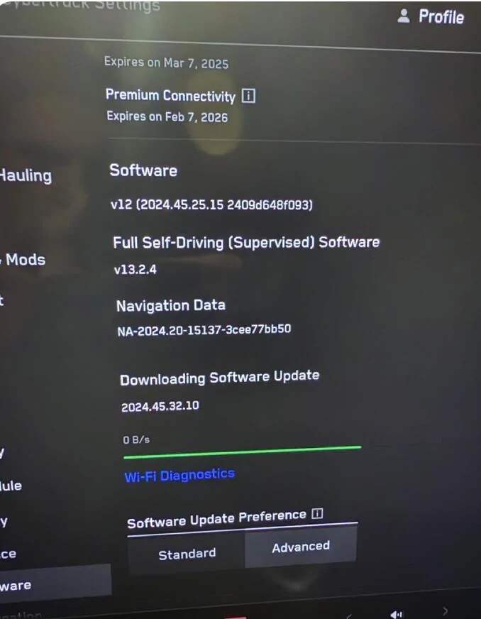

Make sure ADVANCED is selected on the update option. Other than that it can be anywhere from a day to a few weeks. There's no way to call it. One day you'll wake up and it will be available. However, if it's over a month then I might make a call. Until then just go to the software page each day to check. It will only attempt to check once every 24 hours. So don't bother about attempting to forcing it to check as there's no known way around it.

Update: I set the Software Update Preference to Advanced and it downloaded 2024.45.32.10. I don't know if changing that setting is what made the difference, but FSD is enabled now.

just installed 2024.45.32.10 which has FSD v13.2.6
Will check tomorrow a.m. and see if the FSD not available glitch has been fixed.
