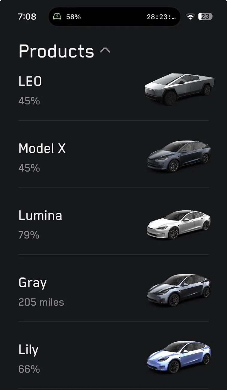

Same. I have this many:
Tesla Cybertruck FSD on CT doesn't work when you have a 2nd Tesla with Autopilot enabled IMG_2249
I have no idea what they’re talking about. ??ā€ā™‚ Each one of these cars is on FSD each one of them have their own installation three of them are on HW4 and two are on HW3 and they’re all on various branches of FSD.
How would my profile have any effect on how these cars ran auto pilot or FSD? It doesn’t run from the phone! I have one profile that runs on all of these cars - without issue.
Which is the point of having a profile! The seat settings in my Cybertruck don’t affect the seat settings in my S Plaid or our X etc
Correlation is not causation. What are you people talking about???!!!!

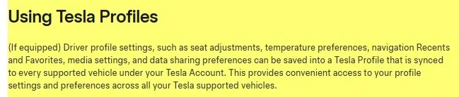

There was a new option in 2022 that saves various profile options to the cloud and it syncs them across all your cars. The article indicated this includes "autopilot"/AP.
So what happens if on some of your cars you use AP even tho that car has FSD (eg S). Now when you use a different car (eg CT) where it only has FSD and cannot do AP ... what does your cloud profile tell the CT to sync to.
Yes, a corner case. They video above claims other problems of syncing between cars.
Obviously items like seat locations could be vastly different so they have to use some formula to figure out the deltas and adjust them to be 'compatible'. Imagine in your Model 3 you set your seat and steering wheel position so the wheel is 20" from your chest and pedals 40" away ... now you get in your bigger Model S and it does the dynamic adjustments to make your S have that same distance of 20" fo the wheel and 40" for the pedals.

From a TM3 manual (but same in other Tesla manuals including the CTs):
Tesla Cybertruck FSD on CT doesn't work when you have a 2nd Tesla with Autopilot enabled jYHIIYA
Edit: just digesting this. are you saying that because your cyber truck doesn’t have regular auto pilot and you have that profile selected in your other car that it confuses the Cybertruck? [of course you are that’s quite literally what you said] I still don’t understand why that would happen.
But, I will never find out because I certainly didn’t pay for FSD 5 times over to only use auto pilot. ??ā€ā™‚
