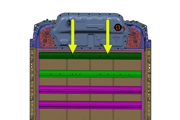

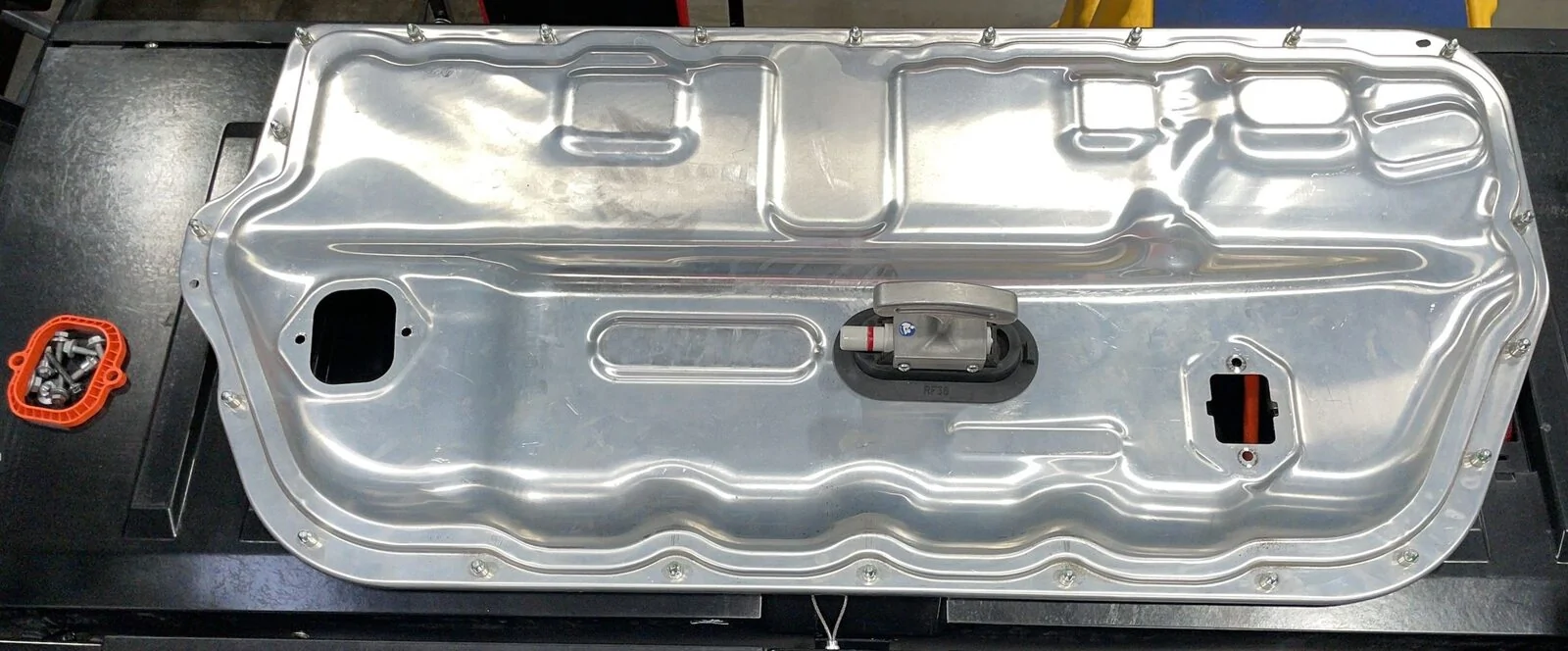

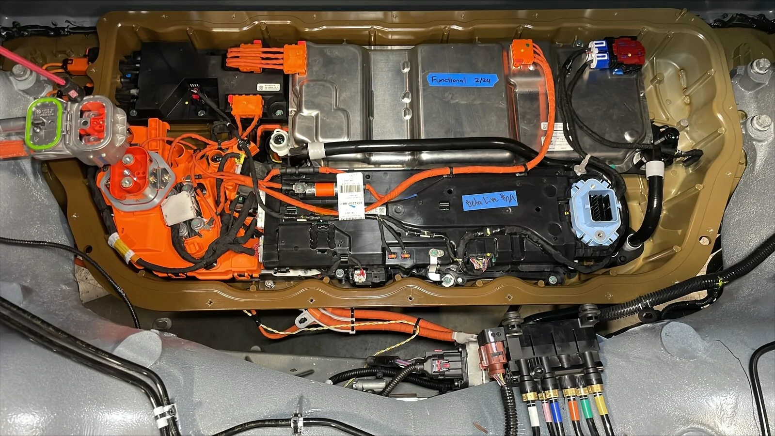

There are two main compartments in the full pack assembly. The cell area never gets messed with, but the PCS, ACJB, DCA, ... all live under the cover accessed through the vault.
Pryo Fuses are accessed from a cover under this section.
