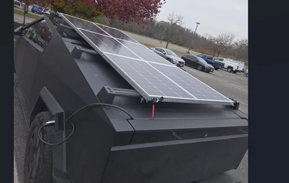

I dump the PV into the 12V battery in the vault when driving. When I plug it in it can pull from the battery with the extra store as well as anything new coming in. Agree - ideal solution is a 48V DC charging input (a plug?) that can be fed from a solar accessory.

That what this does. Dump into a battery and when parked pull battery plus whatever it rakes into the truck. I don't see this ever getting more than 1000-1200Wh capability within the footprint of the truck. I can get a few kW a day but with a 123kW battery and vamp drain it does not feel like much but if I was strapped I am sure i would be valuing every mile.

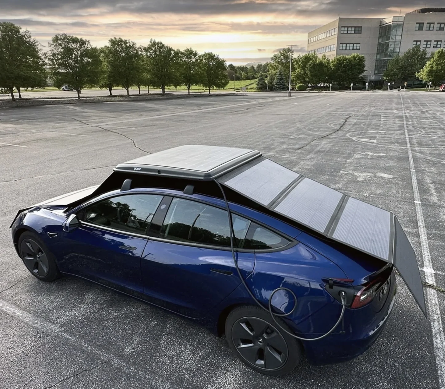

In theory, could use something like the forthcoming GoSun EV Solar Charger. In practice, don't know if it makes sense to leave $4,999 of solar panels sitting alone in the airport parking lot for days or weeks.

As little power as the hood mounted solar options are, there are a few vendors. But like what you asked about.. it’s not enough watts for the material benefits.
The car charger by GoSun is $3400 (if preordered round one, or more if just now ordering.) and that only has 1200 watts.

I invested early and have an option to buy now. But at $3400, it’d take too long to recover the money over just plugging in at a local charger.
