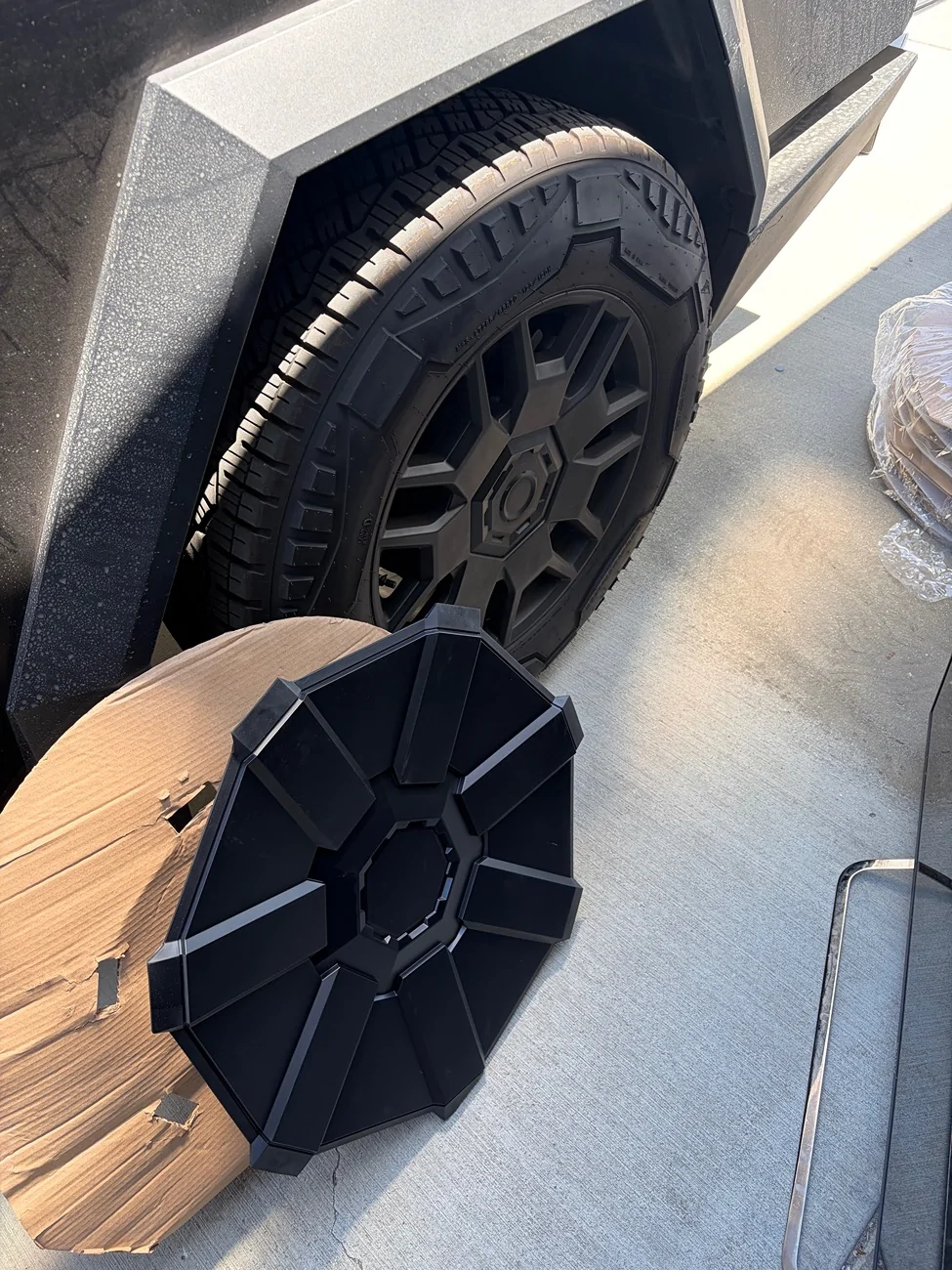

Am i doing this wrong or are these wheel covers not supposed to fit?

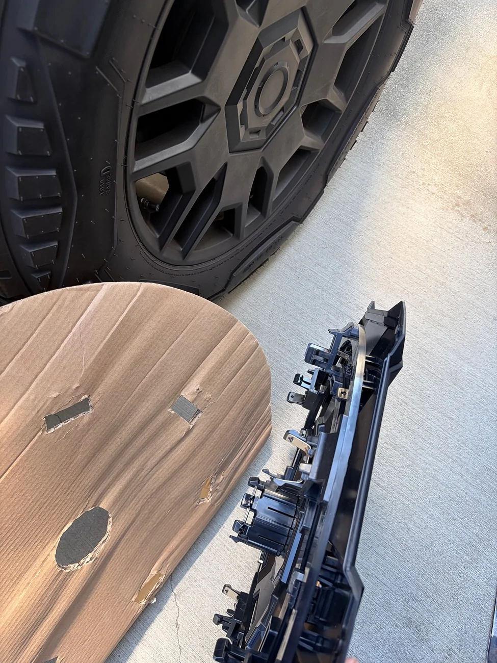

Tip: don’t store them on edge as they are positioned in the above picture, the outside rubber will come off.
To remove I just stick an Allen wrench inside behind and pull it with channel locks.

Here's the tip they apparently forgot to teach even most delivery prep people.. those Cyber covers (mantle covers?) are actually TWO pieces. The inner ring goes on first, properly aligned _between the spokes_ then the larger outside piece pops on that, (ideally) aligned with the funky markings in the rubber of your tire.
I suspect half the scratches people have out there are from delivery just shoving them on anywhich way they can. Mine came delivered with not a single one properly installed/aligned, and I clearly have scratches (bang marks? in places it should never be if the ring was applied first.
