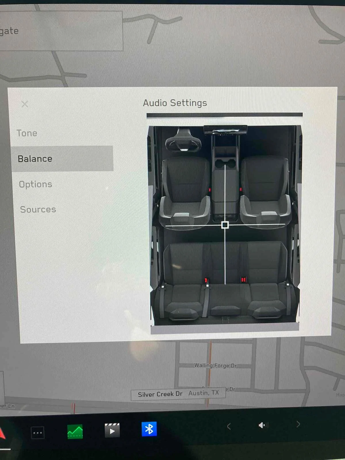

Did you check the sound-system balance/fader controls?
I waited 5 minutes, screen, fan, etc. shut off. I don't recall if there was a beep or the mirrors folded. The Dome lights stayed on and ambient lights stayed on, which I have set to ON rather than Auto. I will try again. You stayed inside, right?
I used the balance to be sure the rears weren't working right. Full to the rear at 11 it sounds like a transistor radio from the 60s. :rolleyes:
Those who advised patience were right. The problem resolved itself overnight. Teslas are not like other vehicles. ?
