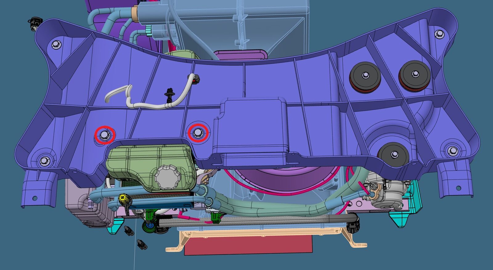

https://parts.tesla.com/en-US/catal...emGroups/9a7ce987-039a-4de9-8cdc-6ad896a65ec7
I believe the drain hose is depicted in the lower left, which suggests that it exits near the centerline, just behind the firewall. I suppose a plugged drain could cause water to make its way forward to the filter, so both should be inspected.
I think the drain line is depicted here, in grey?:
Tesla Cybertruck HVAC Mildew Smell -E77D69B8-0254-4BC4-9753-364349EF0B0B-online-en-US
In other Tesla models, the drain just dumps onto the top of the front cradle, presumably to protect the end of the hose from getting clogged with debris. You might need to remove the frunk tub to access it.
