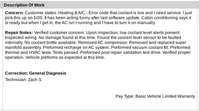

My AC broke for low coolant and a rear drive unit electric oil pump being bad. The truck needed to compensate for that. Should be a quick fix. They need to wait for the part, but are saying I could get it back as soon as Friday.

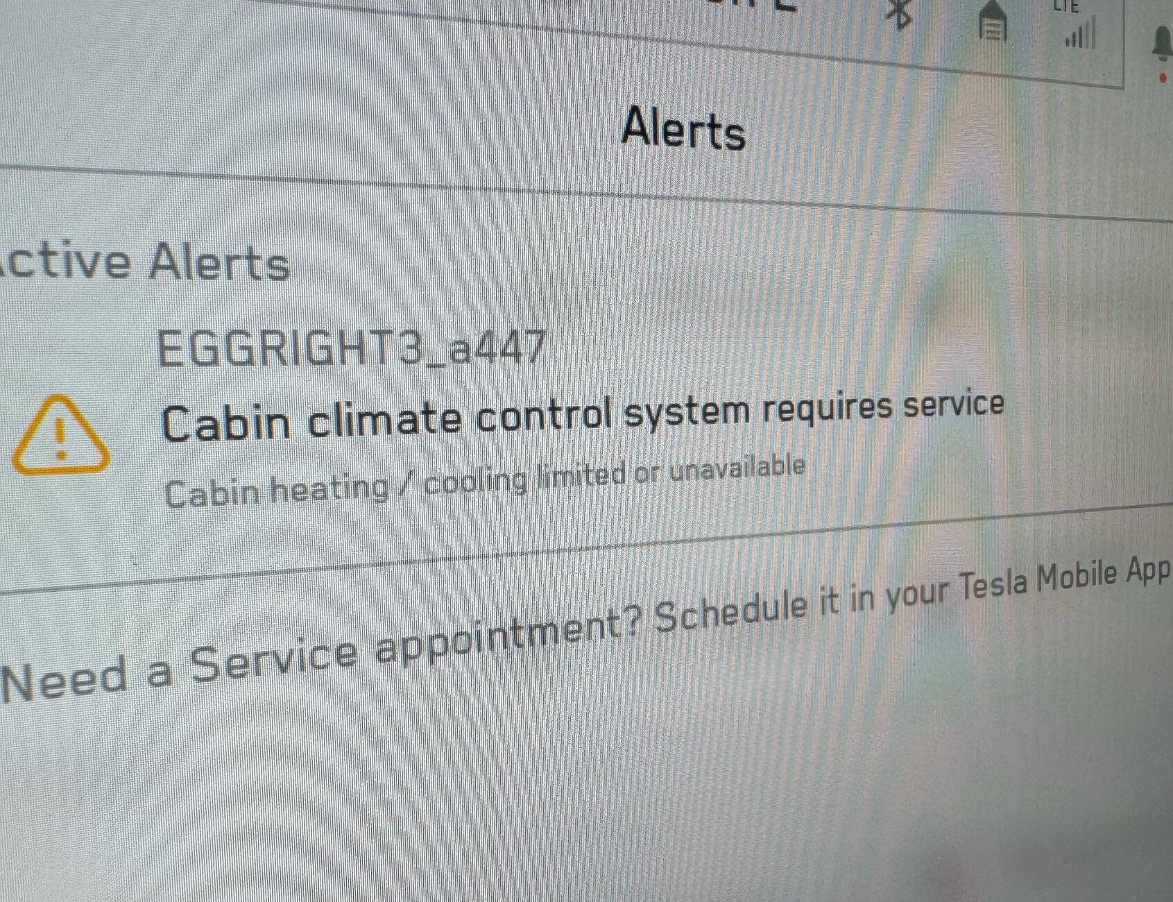

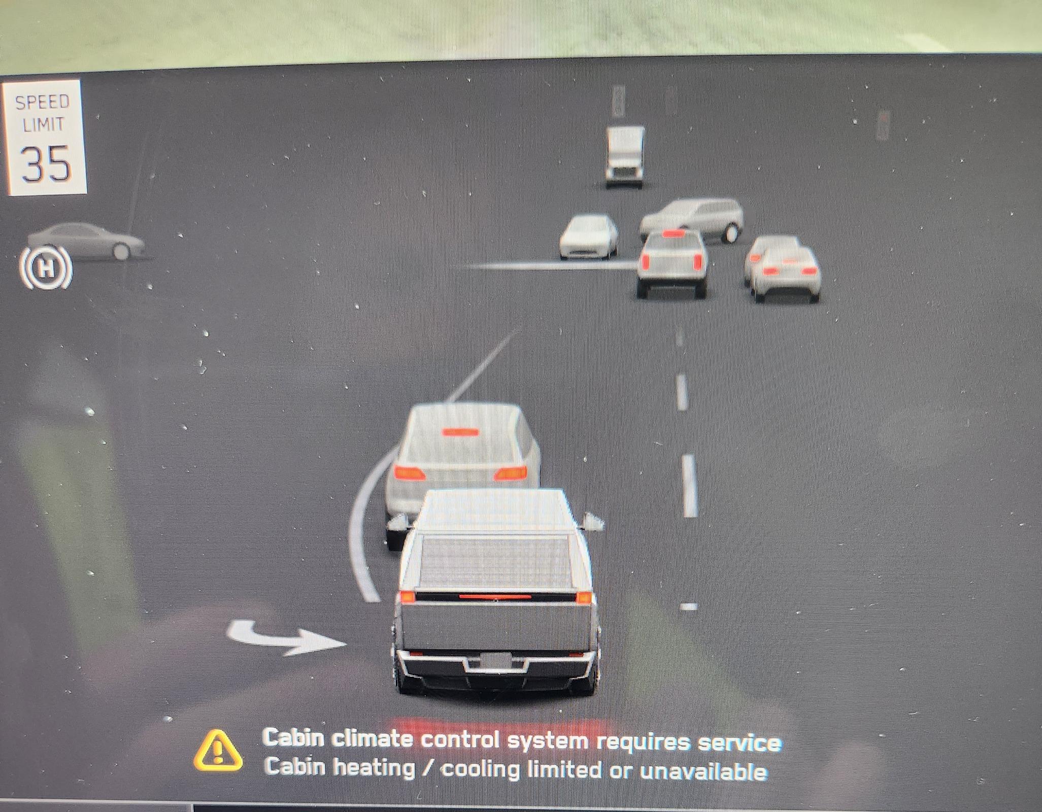

No word yet on exact part(s) that are broke hard, but app is telling me they have been ordered with ETA of 3 Jul. That would put my 5-day old $100K+ CT down on HVAC for ~30days by the time it gets fixed and returned back to me at this pace.
To be clear, reps at service center have been very polite, they don't have a magic wand...I get it.
I really have had a great (limited) experience with the my CT, but HOLY SMOKES is this a big ouch.
For context I have 345 miles on mine.
- Drove to work...everything fine
- Got back in truck mid-day and HVAC error appeared
-- Tried to "reset" panel, blah, blah, blah...still error
- Went to app and showed appt 2 weeks out...in SoFL heat
- Drove to SC and they told me HVAC was an "emergency issue" and took truck right away
-- Due to flooding in SoFL, they were backed up with other repairs, so it took them a week to diagnose
- Parts were originally scheduled for early Jul, then pushed out to mid-Jul
-- I reminded SC this would put situation beyond FL "Lemon Law" (not being adversarial, just a fact)
-- They searched far and wide across fleet and found parts and trying to get me back on road before 1 Jul
We shall see....
Welcome to owning a Tesla I guess?
More to follow...

Paul Here are the notes:
"Diagnosed and found air pockets in drive unit due to low fluid."
Gearbox fluid- drain and replace
Rear Drive Unit (3DU)- Drain and replace
Looks like they didn't need to replace the oil pump.

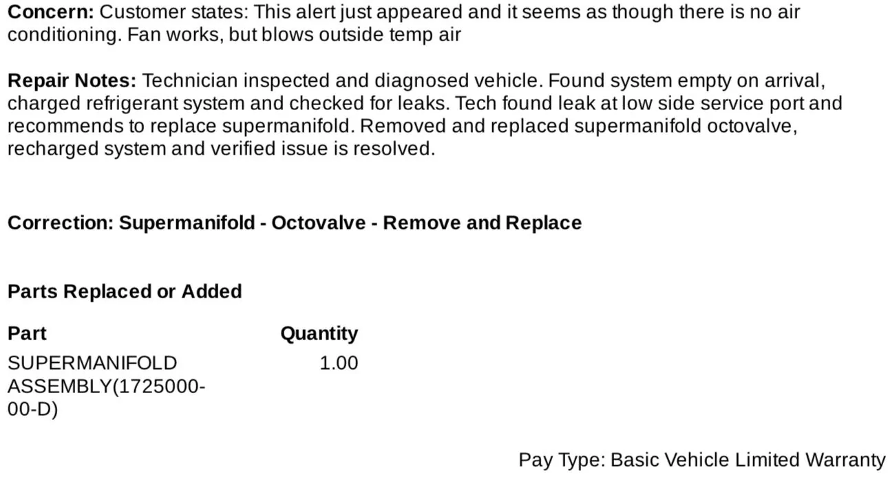

I had the exact same error pop up just after 500 miles on my truck. Service appointment booked ASAP and finally getting to bring it in tomorrow. I'll reply here with what the diag/resolution is.

May I ask your VIN range?
27,xxx
Dropped it off this morning, they said they are replacing the supermanifold. Estimate to have my truck back by Monday.
Hopefully they have more in supply chain now.
I had same problem several months ago and it took 45 days.
