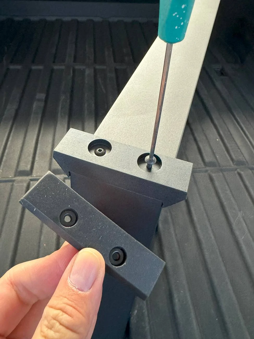

Can anyone else verify that the newer cargo vault divider feet have 2 rubber sections, one of which can be removed to lower the height? Mine does not, and does not fit (it’s too high). I want to try and convince Tesla service to swap my vault divider for a newer one but it would be helpful if someone else with a newer one could verify the feet are split can be made shorter in height.
I made a "warranty claim" per directions from my SC and got a new divider. I can confirm there are two removable rubber spacers on each of the "feet" so that you can adjust one or both sides' height. I simply sanded down one of the two spacers to get a perfect snug fit because removing one spacer gave too much room.

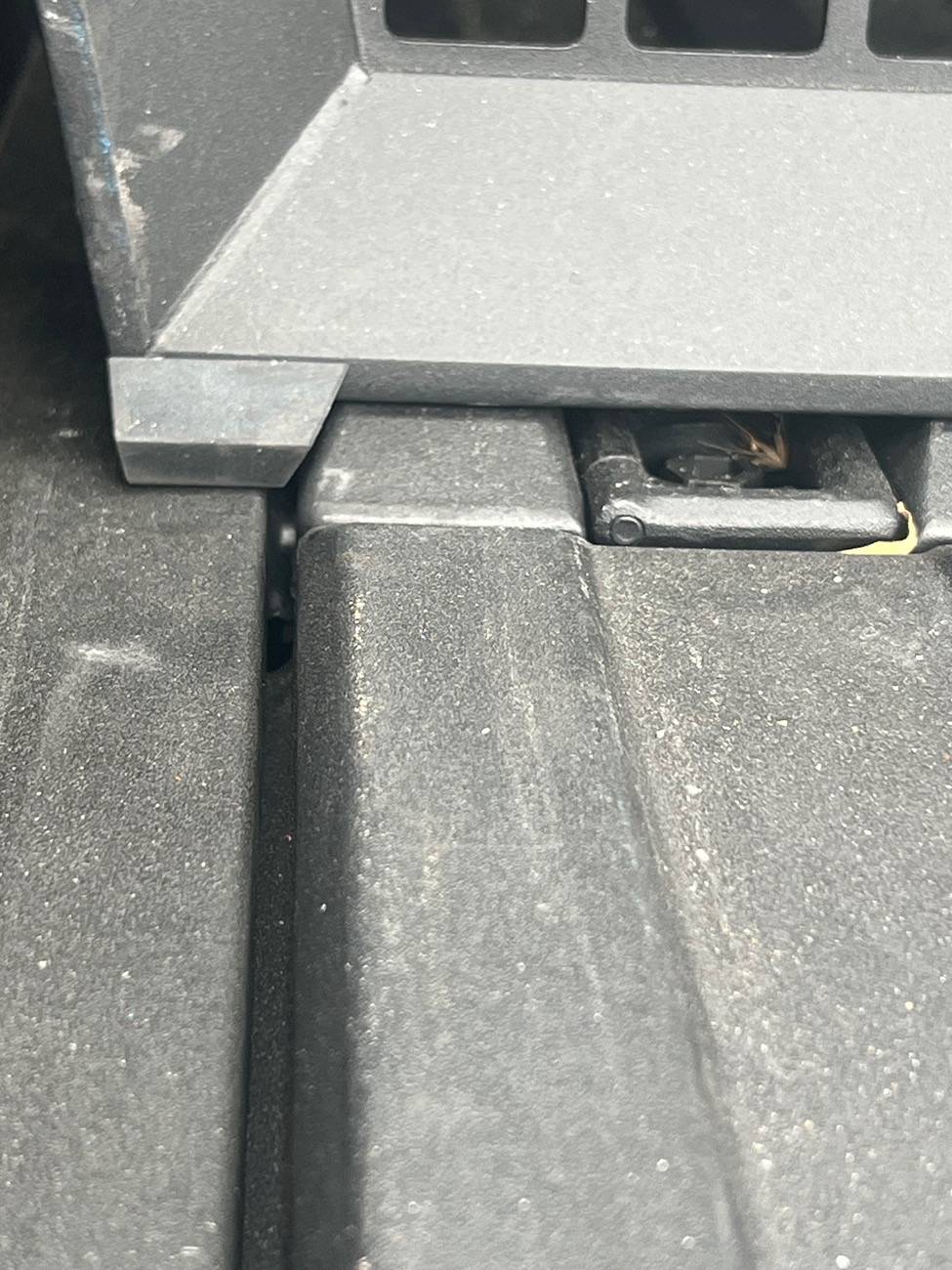

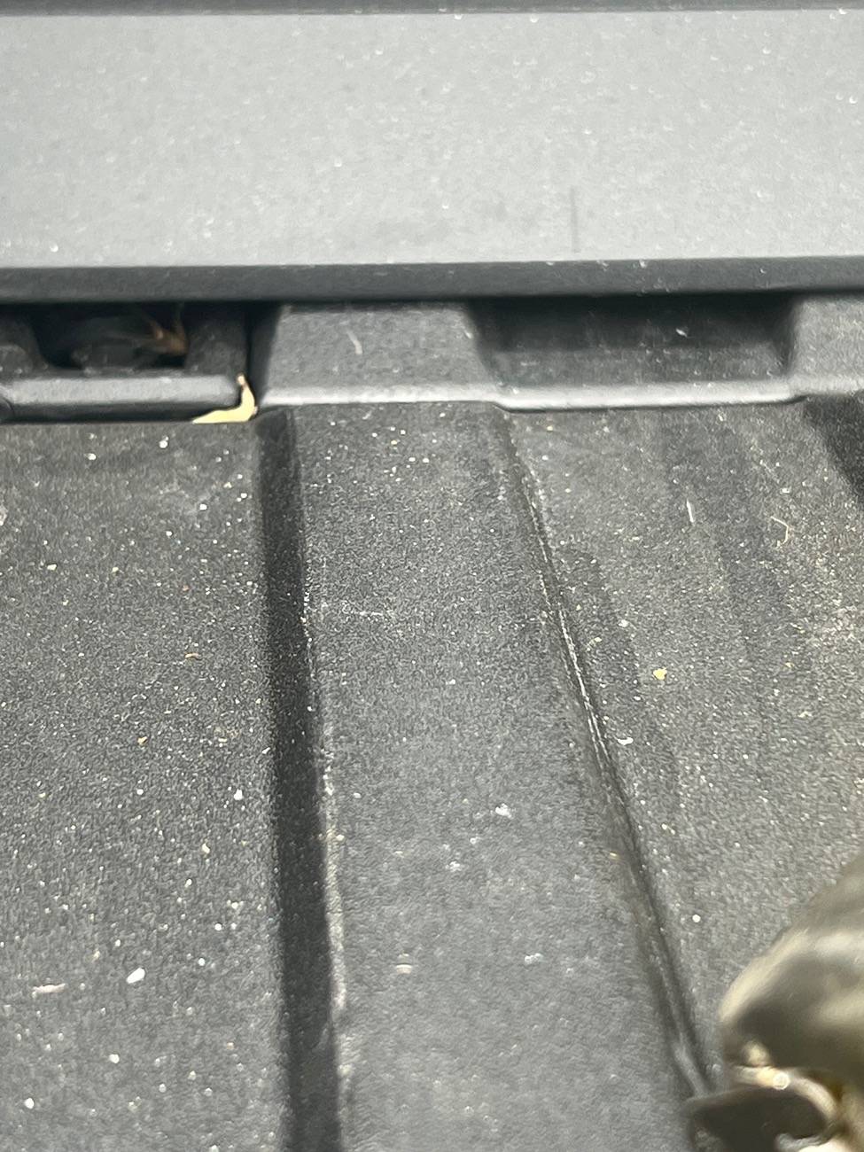

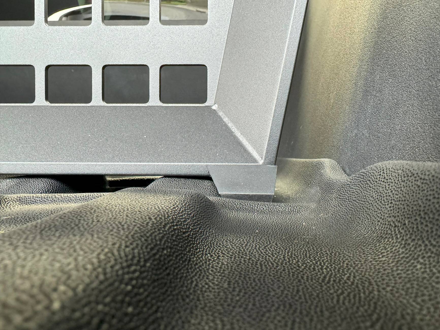

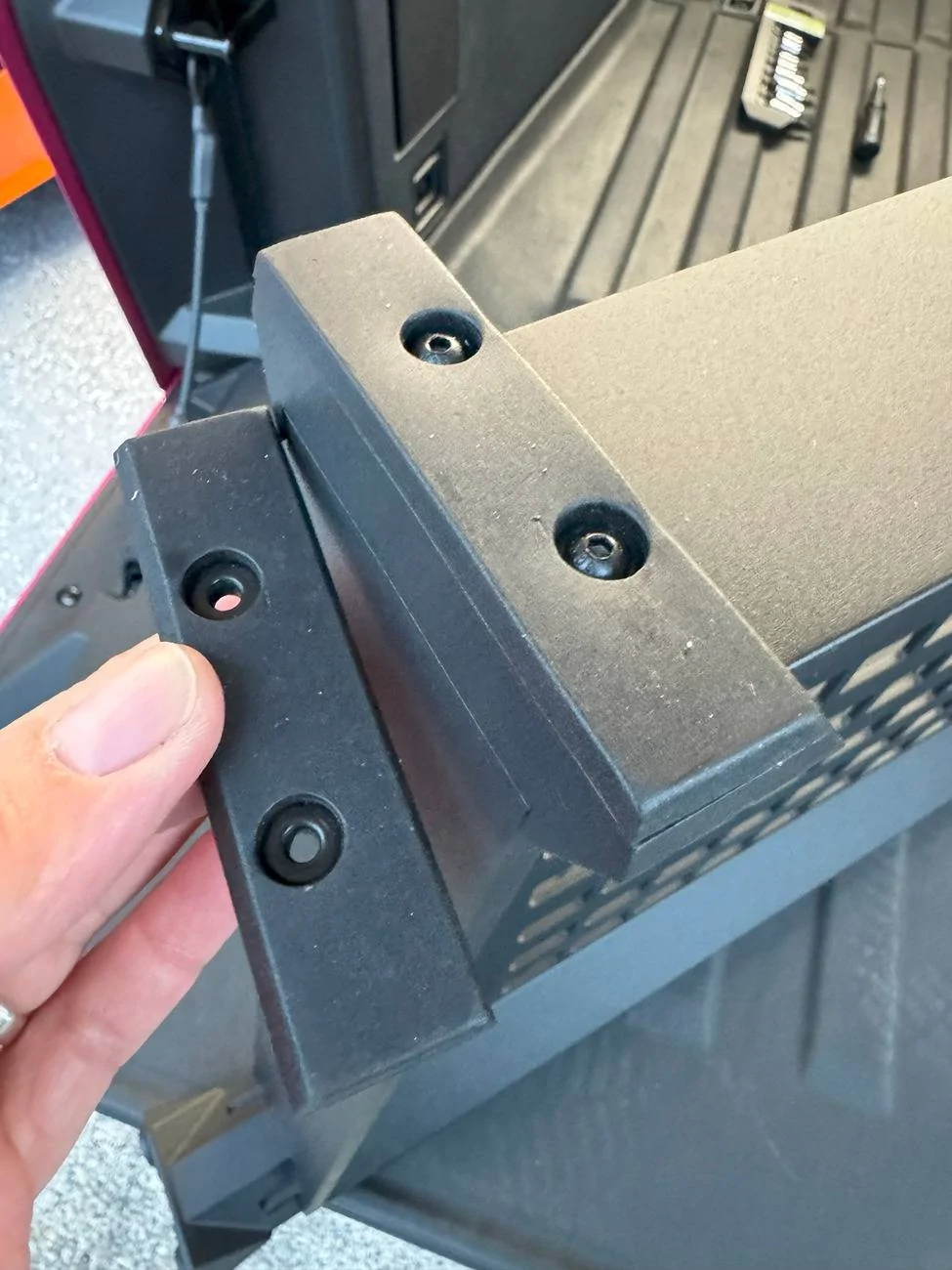

Just installed the new divider. The old divider was purchased in July, 2024.
The new divider is much easier to move around - once I removed the ‘extra’ rubber foot from the bottom. Easy to do, just remove two small bolts.
New divider on top:
Tesla Cybertruck OEM Vault Cargo Divider now revised & fixed by Tesla! IMG_5182
Tesla Cybertruck OEM Vault Cargo Divider now revised & fixed by Tesla! IMG_5184
New divider on the left:
Tesla Cybertruck OEM Vault Cargo Divider now revised & fixed by Tesla! IMG_5185
