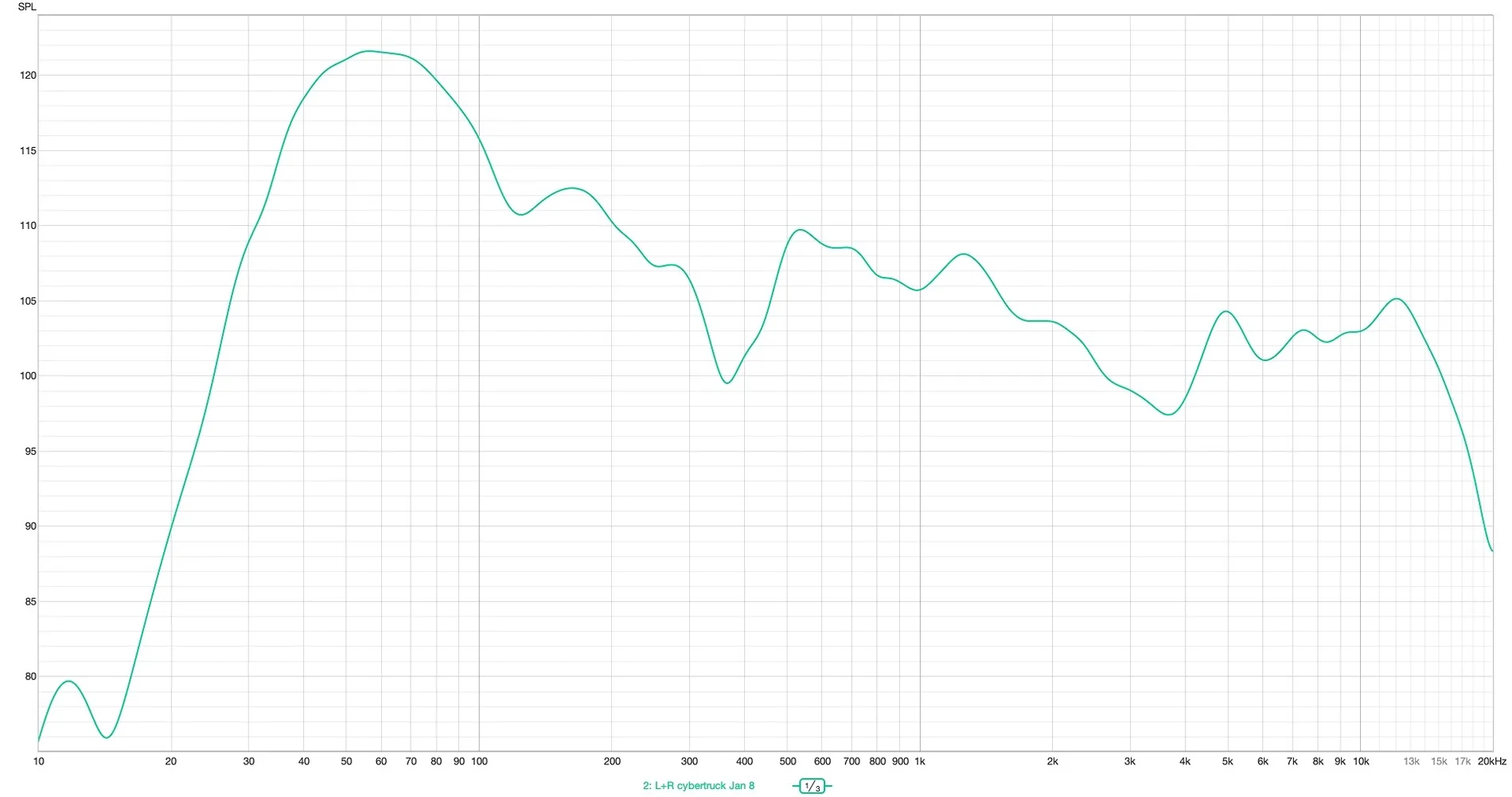

Test in various positions around your listening position and plot them all, might have been in an anti-node.
Really the only position that makes sense is where the drivers ears are. I tried to put it lose to that. Next time I think I will sit in the passenger seat, and place the mic exactly where the drivers ears would be. I really don't care what it sounds like in the back seat. I care what it sounds like where I sit.

I did take other measurement with different settings, though not on camera. the bass and sub settings boost a very large frequency so it does not change the drop from 40 to 30hz. I can do a longer video where I test several different ways and post the hi res graphs if there is interest from enough people.

Wow…40 dB spread…that’s huge…is it really 1,000-10,000x louder @ roughly 40-80 Hz than at 10-20 Hz? I don’t have an intuitive feel for the sound, but the math is shocking.

The graph is correct. 40db IS 10k x louder. Seems crazy. I do know that low frequency and high frequency sounds are perceived quite differently to human ears.

Good call…it’s like light…how much brighter something appears to be depends on color…

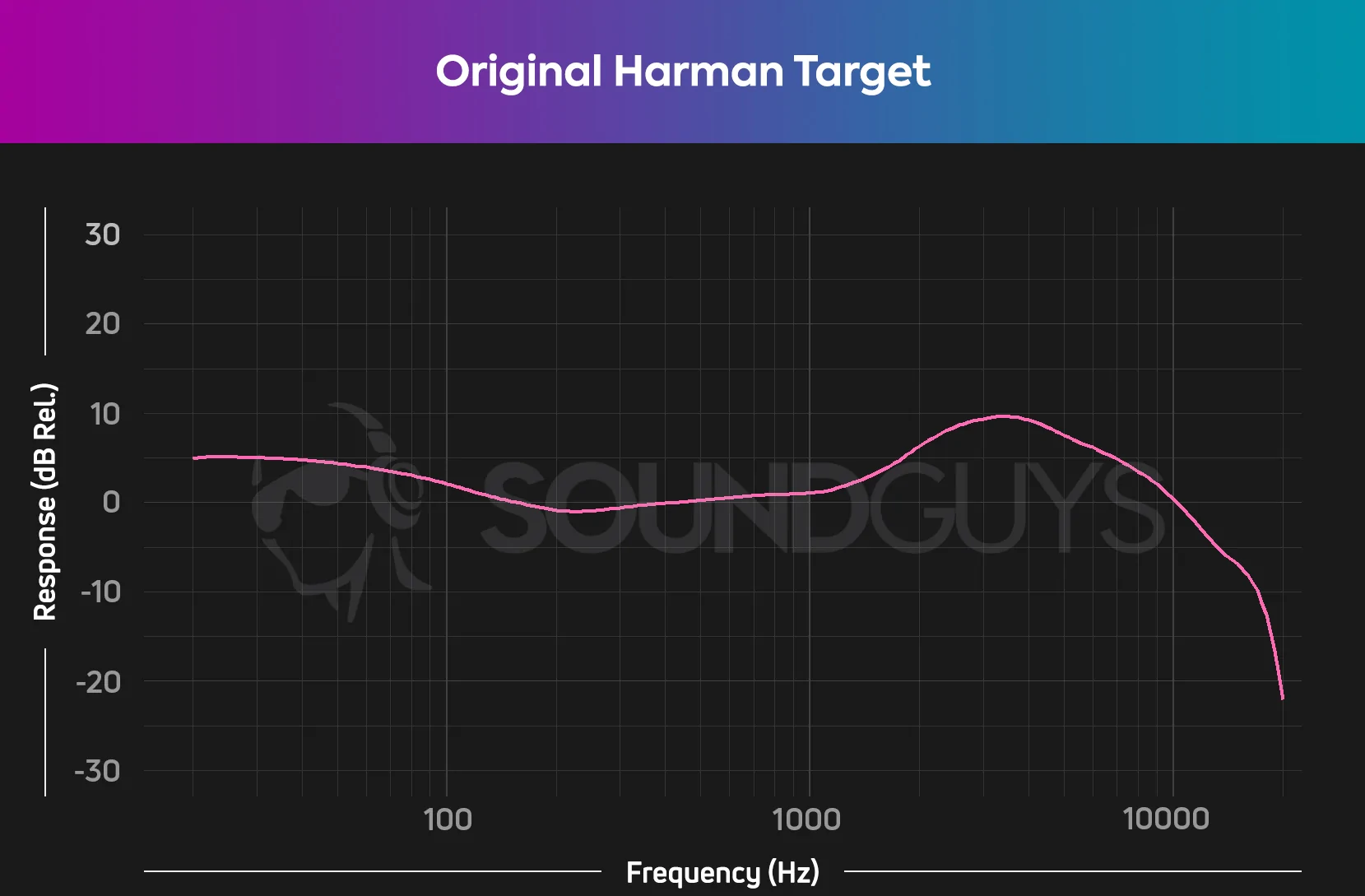

After some research, a flat curve is not what you want in a vehicle. For a theater, or for a mixing engineer, sure, but research shows that the ideal curve is something called a "harman curve", shown below.
Tesla Cybertruck I measured the Frequency Response of the Cybertruck Stereo System with REW OG-Harman-curv

I do have the eq set to an exaggerated harmon curve, to fit my personal tastes, and it does still miss a bit of the punch in the upper base, but it's definitely good enough for me.

If you habitually listen to music at those levels that little dip between 30Hz and 40Hz is the least of your worries, lol.
