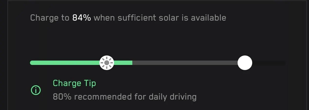

It only says that when you try to charge above 80%. When you set it below 80% does it say that? No!
Was simply pointing out that Tesla does make recommendations for daily driving SoC. :)
Sure if you keep it between 30%-50% that is bests for long term health. That may not work for everyone. I do the same, stays between 40% - 60% unless a longer trip is needed.
Read what I wrote again. 80% is the recommended MAXIMUM charge, not the recommended charge. There is a difference. Use common sense!
