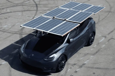

A Tesla owner documented their solar-only journey, so this should give you an idea of the scope.
Hey Cybergus, thanks for that Video.
That's pretty much what I had in mind currently with an off-grid 240V system and I can build with off the shelf components. I"m not planning a cannonball run, so the use case is a little different. I will just need to generate enough to explore a little overlanding and to get back to the superchargers when I am done the trip. Some of the places I want to go are far enough from the superchargers that it would be tough to get there, explore for a few days and return on one charge. If I can generate 40KWH a day over a 3 day trip, that should be sufficient for me. The flexible panels are a game changer since they are so think and makes it possible to carry 3KW (or ~6KW for the guy in the video) fairly easily. Worst case scenario, if I get a cloudy day, I extend the trip until I get enough charge to make it back. Not the worst thing in the world.
Yea, that's no big deal, 60 solar cells $6000+ ( (it appears as if there were only 2 in the car), around $2000 of MMPT / Inverter, and about $5000 in batteries.
I think that I heard that the solar array was 70ft across.
And that get's 150 miles per day.

not a fan of this when driving
but maybe when camping, roadtripping, a number of panels stacked in the bed that can be taken out and used for recharging
but this exists
Are you aware that it appears that neither of these videos have enough cells to support even 120V 15A charging?
It takes a LOT of solar power to charge an EV. We're talking 30-60 cells and maybe 5kW external battery pack.
