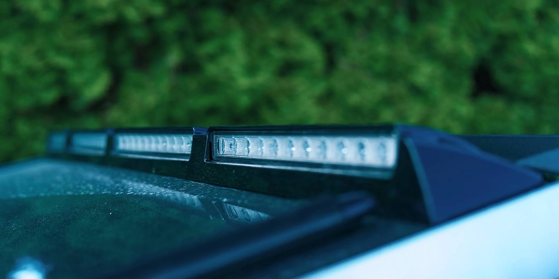

I just upgraded my truck with a Tesstudio lightbar. Instead of the traditional mounts, this one sticks directly to the windshield with adhesive tape, similar to the OEM lightbar. I actually prefer this solution—it's easier to install (though I'm not entirely convinced about UNinstalling, haha). Got it installed on the truck and tested.
That was quite fun ?
VERY NICE! Thanks for posting! So, does it have much wind noise? I’d also be concerned about the lenses ”foggin” due to sand abrasion…it looks like it in the wind path.

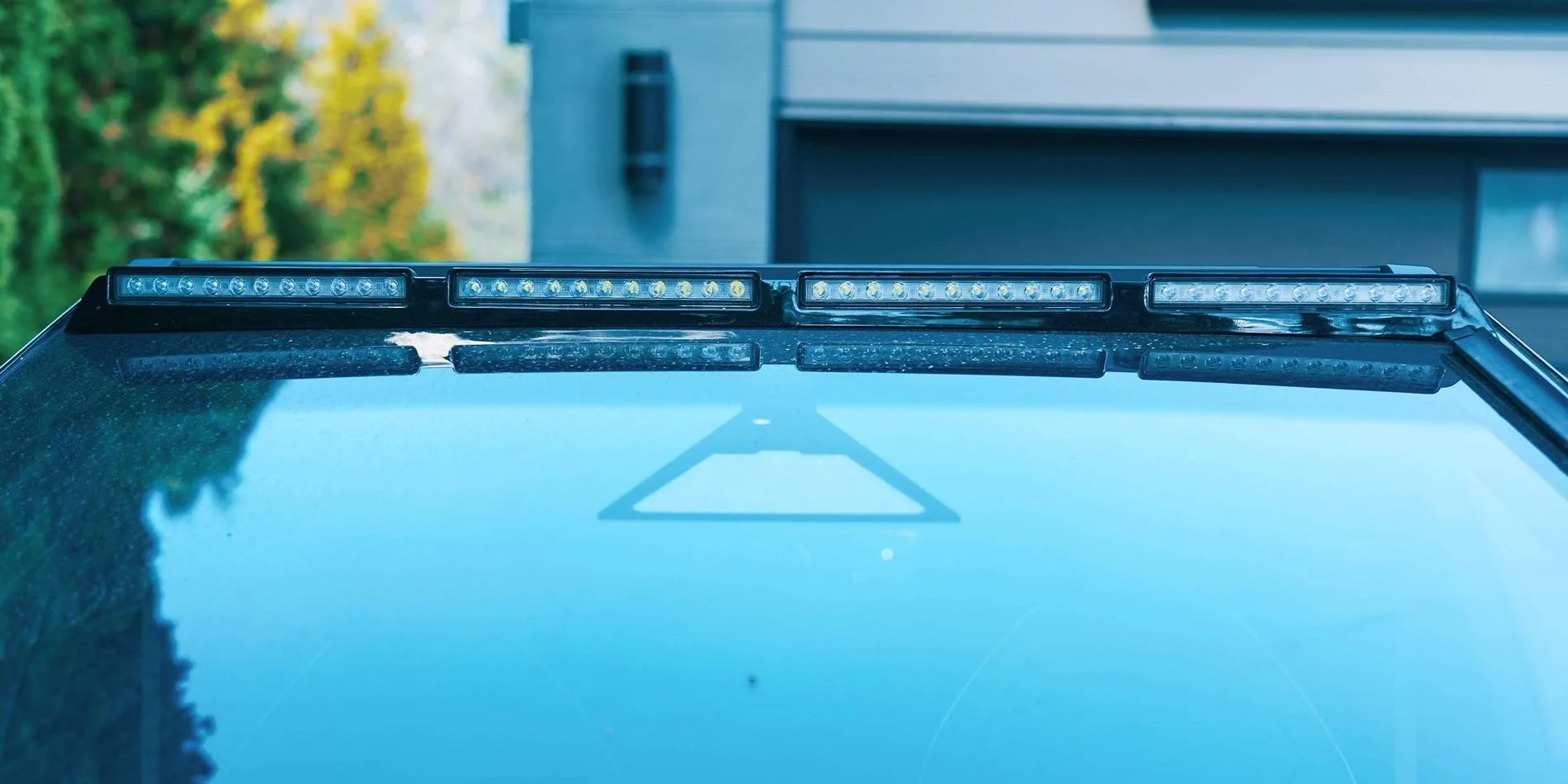

Really is a great video. Thank you. A couple question those of you who have installed this thing already.
1. Did you place the little tabs in the space between the roof and windshield glass or a little lower? It seems like a little lower would have an aerodynamic benefit but I’m worried the little tabs will means it’s not completely flat in the glass and may compromise the adhesive. Thoughts?
2. anybody give thought to putting a thin coat of adhesive promoter there before sticking? It’s not 3m tape but it looks like strips of knockoff VHB.
3. what wire attachment method did you use and why? Crimps? Solder? Would you do something different if you did it again?
Thanks!
1. I put them slightly overlapping with the gap between the 2 glasses on top, so the lightbar's edge and windshield's edge line up precisely.
2. I think it's not really needed. It feels solid up there + it's super lightweight and shouldn't suddenly go off.
3. The one in the video ? But for the old lightbar I welded the wires together, but that was kinda overkill in my opinion, so I went a different way this time.
Thank you! I didn't notice any wind noise, but for the optics only time will tell ?‍♂
One other thing to consider, how much space you really have to work with. Yes, lower on the windshield might provide a little increase in aero benefit...but the wiper is also VERY close to the lightbar. Would be interested to see a side shot showing exactly how much clearance is left after the install.
Rain/snow/debris/etc are all pushed by that wiper arm, and if you install the lightbar too close I'd imagine you might run into other issues.
That makes sense. I don’t live in a snowy climate so that had not occurred to me but it would also interfere with water being “thrown” off the mega wiper at the top of the swing.

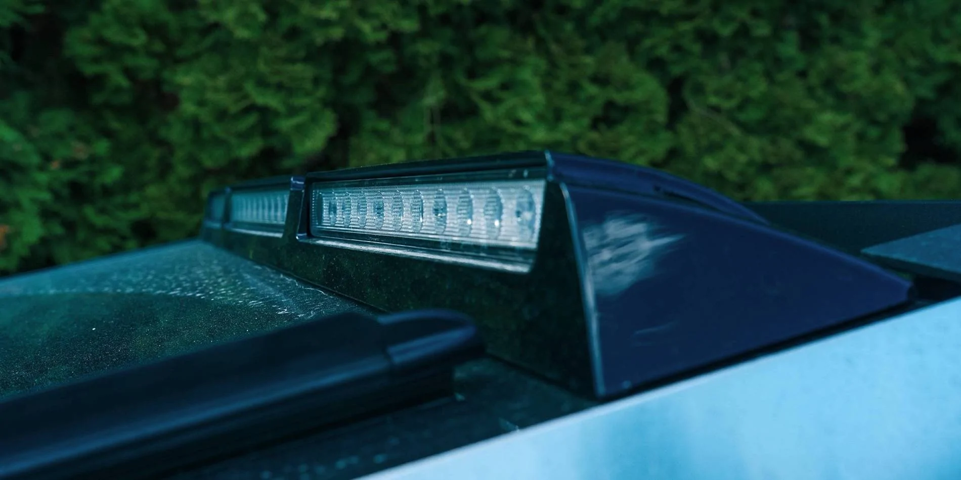

naah, that shouldn't be a problem, attached a couple of my images below

Thanks for the pics! Not personally a fan of the 4 separate bars, but do agree that the single piece looks nice integrated with the CT. Any pics of it later at night with the lights on?
As for the wiper clearance, that is what I was afraid of...very tight. Definitely would not mount it any lower on the windshield than you did. Not sure how it will affect rain/water flow, but snow will definitely accumulate and has the potential to cause issues.
Thanks for the reply! When I finally install one of my own, I hope to incorporate an electrical plugin connector if I ever need to remove it... hopefully I will do better on the wiring too ?
